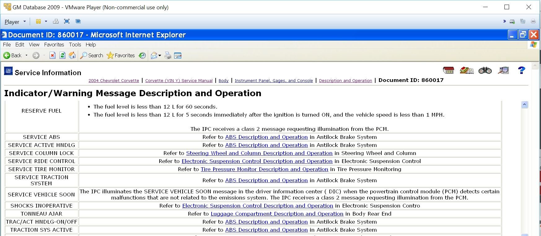

Both of my C5s displayed Traction Sys Active and the C6 displayed Traction Active when the rear tires spun. You have to be looking at the DIC when the wheels are spinning to see the message.
From the C5 Service Manual:
Bottom line shows Traction Sys Active message that is one of the many DIC messages.
Bill
