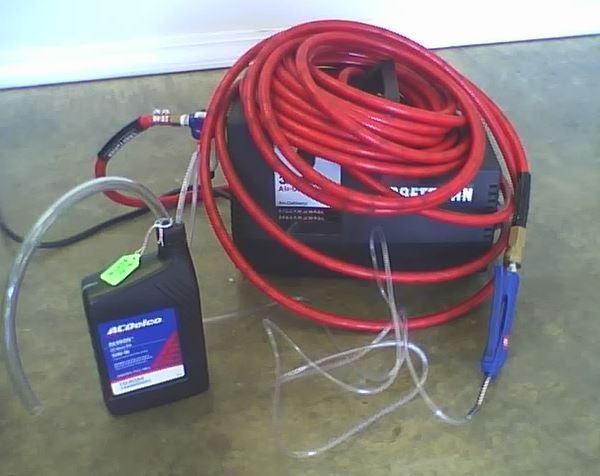

I had one of those plastic pumps and it broke on the third pump, so I drilled two holes in the diff. fluid bottle, one to fit the fill tube and one to fit a small plastic line to provide air pressure to the bottle. I used my small air compressor, with a hand control valve to control the air flow to the bottle, to apply air pressure to push the fluid down and out the fill tube into the differential. One caution, keep air pressure low so you don't overpressure the bottle. Since the fill tube goes to the bottom of the bottle, any leaks will just be air, so it is not as messy.
Air pressure on top of the fluid, forces it down and out the fill tube, so you are not actually having to pump the fluid out like with one of the hand pumps.
I did not have to raise the car at all to drain and refill the differential.
A drain plug wrench can also help.

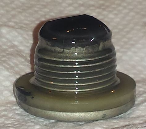

This is from a 2015 with 371 miles on it.
I refilled the diff and swapped it again after 100 miles just to see what it looked like and it was much better. I have owned many Corvettes and never seen one this bad.

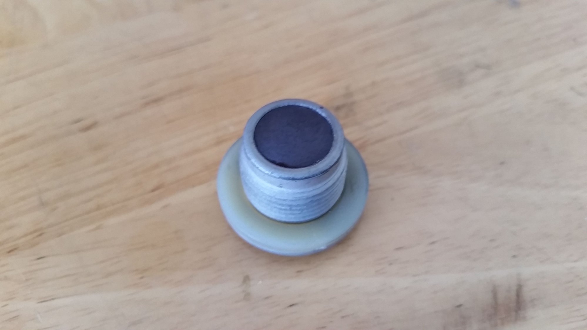

Does the Z06 diff come with magnetic drain plug?
To Changing rear diff fluid - Tips please
Old Feb 25, 2016 | 06:43 PM
67*427's Avatar
67*427
Joined: Mar 2008
Posts: 859
Likes: 53
From: Magnolia Texas
Yes. At least my 2015 did.
sd
Old Feb 25, 2016 | 06:45 PM
badhabit_wb's Avatar
badhabit_wb
Joined: Sep 2014
Posts: 4,301
Likes: 959
From: in the country North Carolina
Mine too.
Old Feb 26, 2016 | 08:20 AM
cheet_code's Avatar
cheet_code
Posts: 387
Likes: 53
Yes sir.
