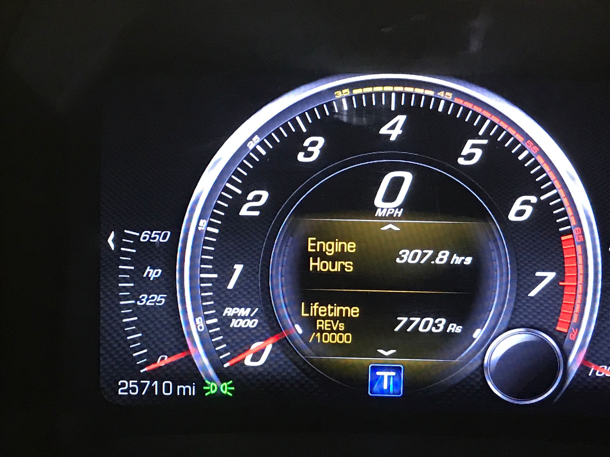

I use it to find my average RPM is 4170.

If I take my miles (25710) and divide by the number of engine hours (307.8) that equals an average of 84mph. Seems fast to me. I only drive 55. And very few highway miles, mostly city. And I idle a lot, I mean a lot.

Your analysis is correct. Something is seriously wrong there. My guess is perhaps the hours is not accurate. (scary) I also do not think your average RPM is correct either.
However the formula you are using I would say is not useful anyways.
Thats like a horrible math question... if i run the engine for this long and travel this many miles, how fast was car 1 going? This is the ol Rate x Time = Distance.
The best way to make sense which is accurate, is to take your total engine revolutions and divide by the distance traveled.
What we are trying to figure out... if two cars travel the same distance, how can you tell the difference between a car used gently, and another abused?
Yes, time could tell you something... but is it not possible one person could drive 30mph 2000 RPM and catch all green lights, and for another person to hit every red light, and race from light to light arriving close to the same time? But how are we going to figure out all those extra RPMs?
Counting engine revolutions and dividing by distance traveled is the answer. If one care does 6000 RPM for one mile, and another only 2000 RPM, we can clearly see that the car driven at 6000RPM for one mile with an average of 6000 engine revolutions per mile has 3x the engine wear as the car with 2000 engine revolutions per mile. Time is not going to affect this number. Racing for one minute and idling for 9 minutes will average out to seem like normal driving for 10 minutes.
So for you, your numbers are 77,030,000 engine revolutions divided by 25,710 miles which gives you 2996 average engine revolutions per mile.
It's a little high... but not 4170. I would not touch a car with 4170.
Let me ask you, did you buy the car new? Also, have you ever had transmission trouble? Do you drive with your overdrive off? Is your idle high?

I purchased the car new. It is an automatic. I drive it hard, I am the first guy at the next light.

Yep, same here. I also average very close to what you do... Or... a little more...
