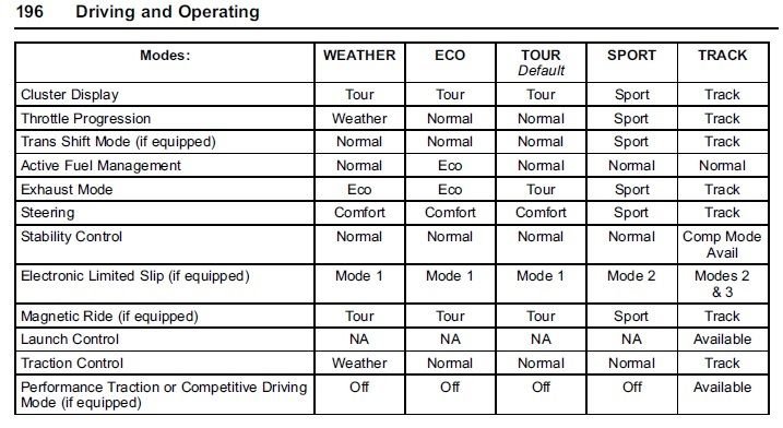

Take a look at the driving mode chart in the Owner's Manual:
In there you can see:
  • Stability Control - Comp Mode Available. (So....before you select Comp or a PTM mode, what mode is it actually in???????)
  • Electronic Limited Slip (if equipped) (which of course it is in the Z06) - Modes 2&3. (??????Before you go into a PTM mode, what is the eLSD actually going to do for you????)
Bottom line - I haven't seen any definitive info on exactly what mode some of the various adjustable features are in when you go into the basic non-PTM Track mode before you do a double push of the button.

Old May 10, 2017 | 07:03 PM
onfire's Avatar
onfire
Joined: Nov 1999
Posts: 1,221
Likes: 59
From: Abingdon VA
Chart

Originally Posted by onfire
Chart
The first time I went out to the track, I was basically stock with slightly worn stock tires...
I ran in just track mode.
I then went to spring mountain, and learned a bit more about the car itself. I came back to spring mountain with my own Z and ran the 3.4 mile course in 233.9, my new PB. With a bit more practice there, I could go lower...
HERE IS MY QUESTION,
From the chart, it looks like there is still some traction control in track mode/race 2, which is what I was running at SM. If I would shift too quickly, the computer would kick in and slow me down just a bit, felt like traction control, IS IT??
Thank you!!

Well......for the PTM modes - yes.
Butt.....for the original question - NO!!!
Tadge's discussion is all about AFTER the double push of the button when you go into the PTM modes.
However, the original question had to do wih what you've got in the basic non-PTM Track mode before you double push the button.
As Tech Contributor Bill Dearborn said in post# 7:
The best way to describe moving the selector into Track Mode and not pushing the center button twice is undefined.
So.....there's still a question out there about the basic non-PTM Track mode. Not really a big deal, because everybody probably goes into a PTM mode when driving on the track anyway.
