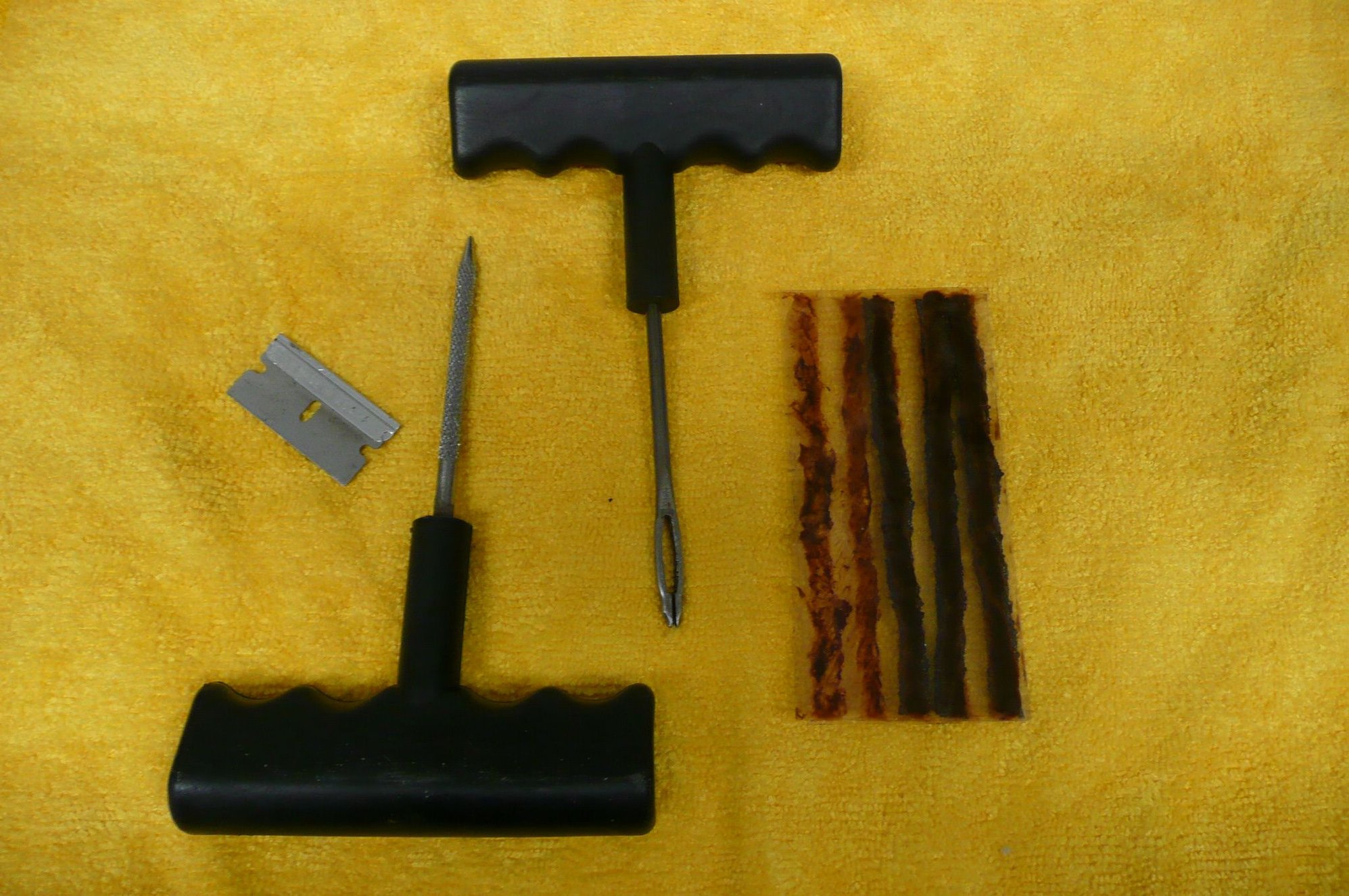

I have plugged both of my runflat front tires 'on the car' (just turn the tire to where you can get to it and turn the tire out 'too' if it is the front) with the type of kit that you run a round file type tool through the hole to clean and open the hole enough to insert the threaded style plug about 2/3 of the way in. They have been doing just fine (0 air loss) for thousands of miles now.
This is the actual kit (Victor Brand) I used (with 'self' supplied razor blade to cut the excess plug off)
Note: There are two plugs missing. Oh, I keep this very small kit & a quality small air pump & pliers in the rear cubby hatch.
