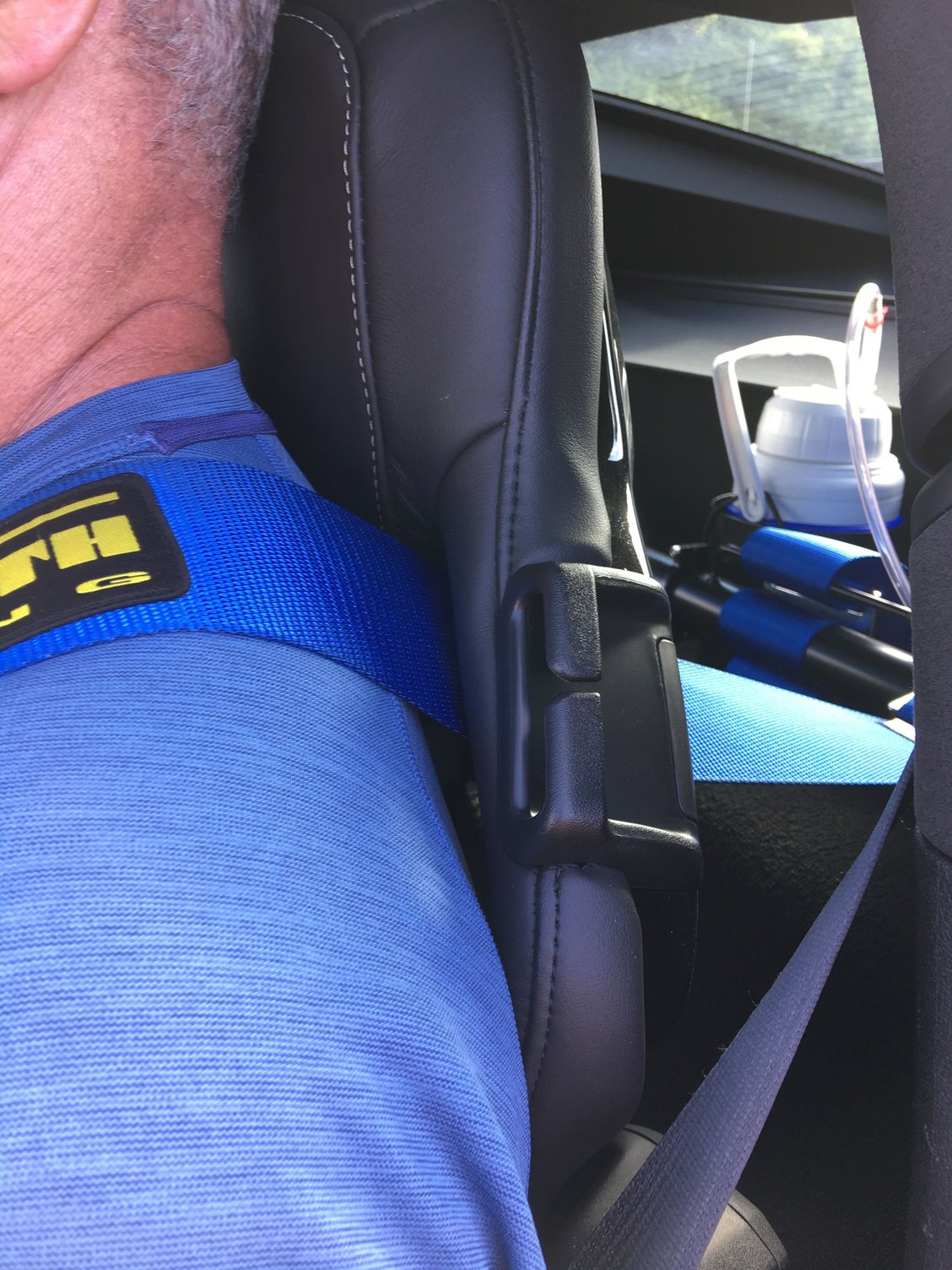

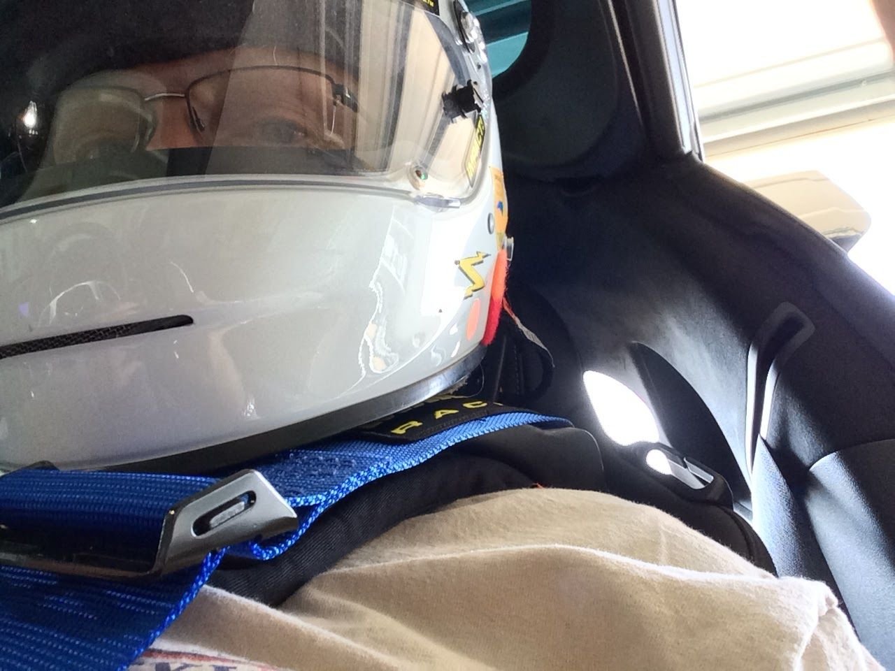

I have been using a HANS Sport for the last 9 seasons. I had it recertified a few years ago when it went past its 5 year certification date. I use it with the Competition Seats in my 15 Z06.
Here are some pictures that I took after I installed Schroth belts and was checking the fit while wearing the HANS.
As of my last physical I am officially 5'8 3/4" tall and my shoulder height is just about perfect for the belts to pass through the seat holes to my Shark Bar harness bar.
Here is a picture of somebody who is several inches taller than I am sitting in my car and you can see he can't use the stock seat because his shoulders are above the holes in the seat.

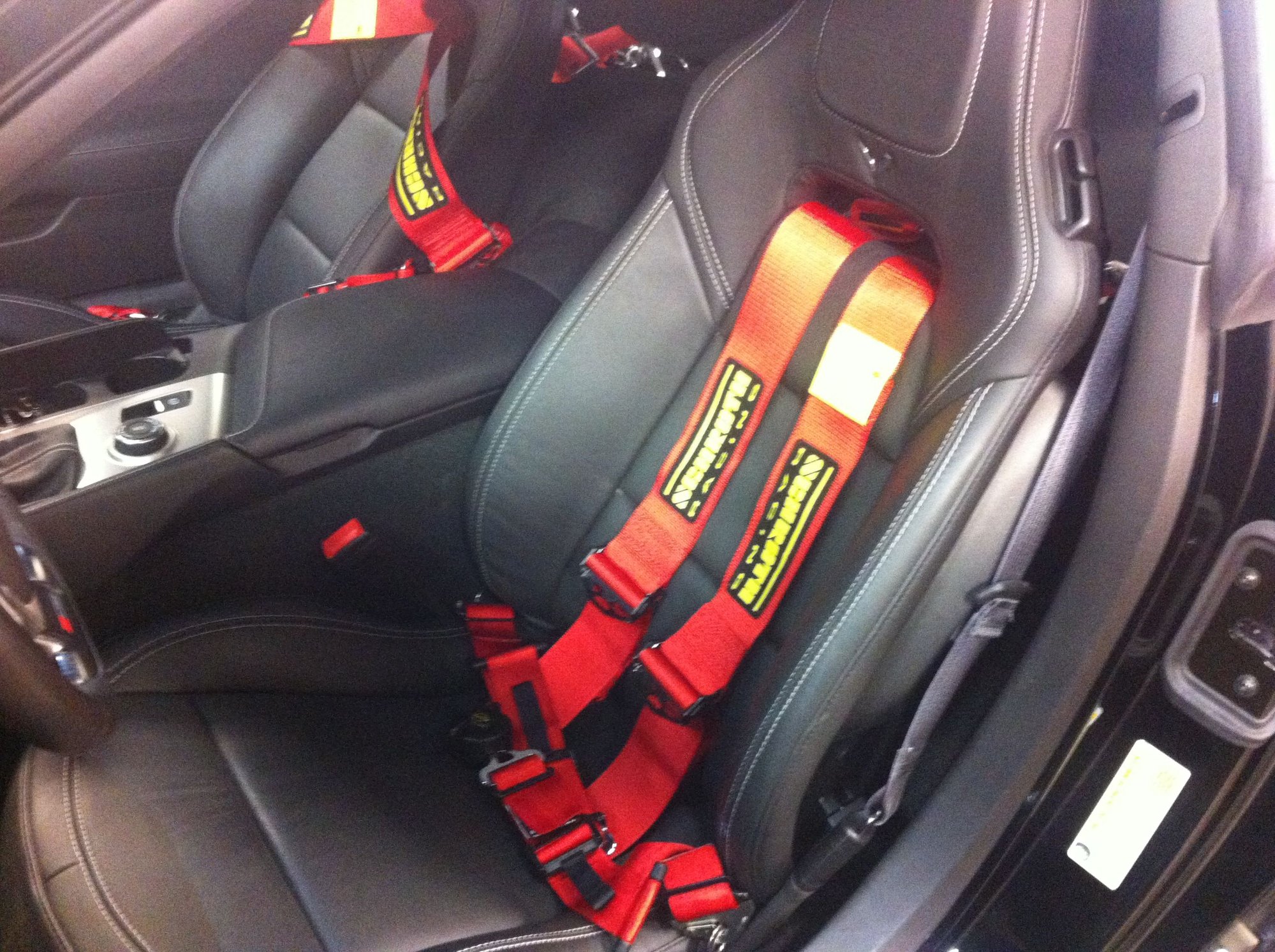

HANS neck restraint, Schroth Profi II ASM 4 point restraint system (5/6 point won’t work with OE Competition seats), plus RPM 5-point roll bar.

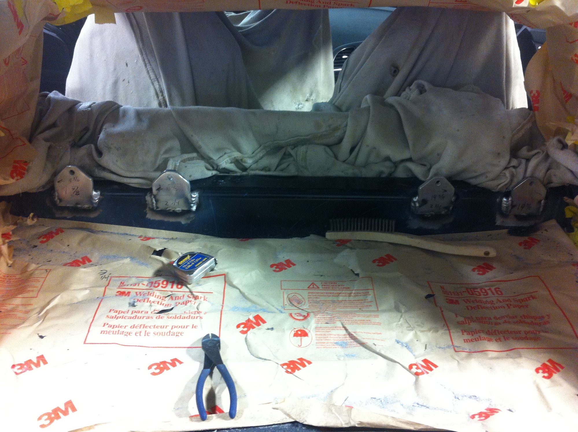

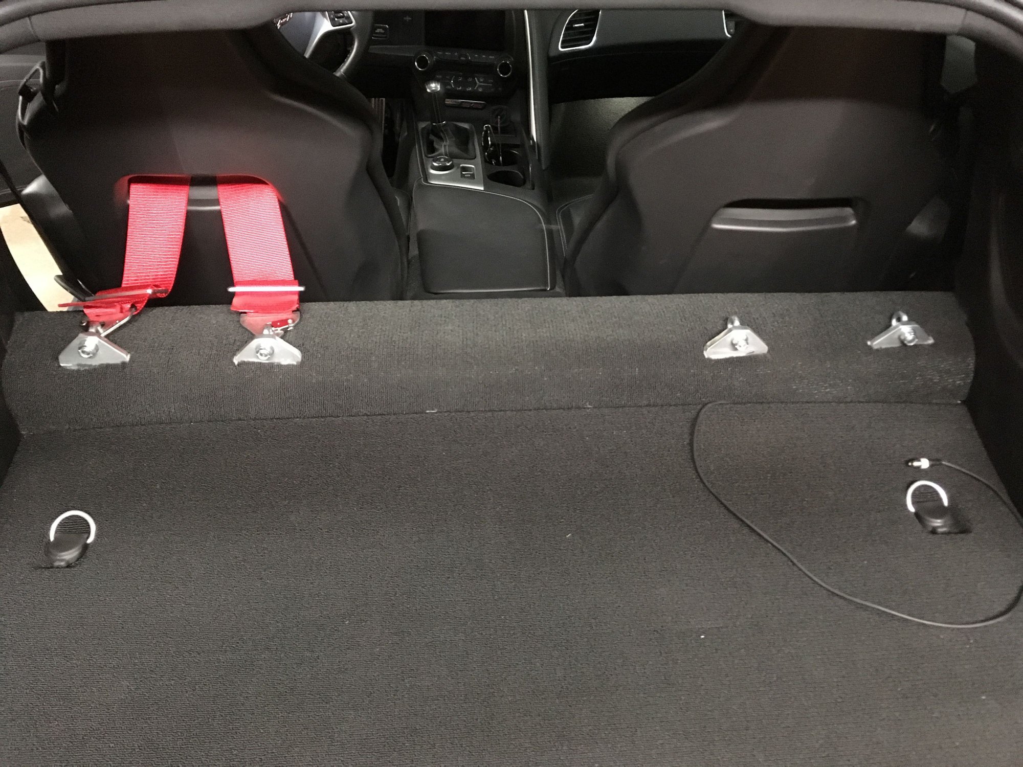

Thanks everyone, so this poll has Hans a clear winner. I am most concerned with the vertical section above the shoulders of most brands and especially the Hans. As seen in Bill's photos i think my seat would need to be tilted back farther than i am comfortable to clear that section of the restraint against the seat headrest. I may be over thinking this but comfort is so important.
Bill i had to make my own brackets and weld them in the car to get my 3 inch harnesses low enough not to be against the GT seat like your tall friends issue. Then the seat is adjusted up in most cases to clear, 6.1 is about max height with a short torso with this set up.

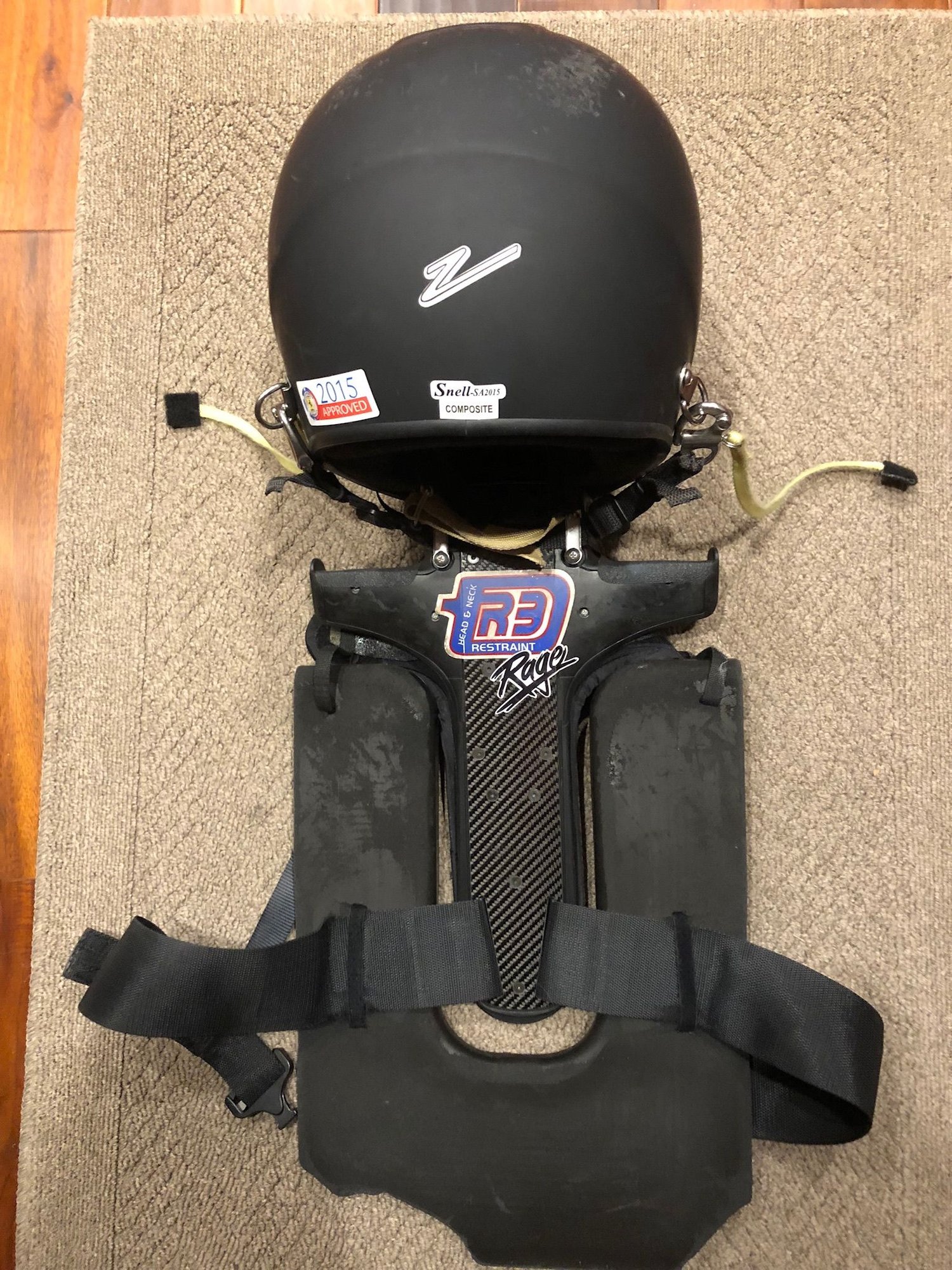

I have used my Rage R3 for many years now.
With the stock seats in my C6 Z06 and ZR1, I would have needed to get race seats with pass-through holes for a shoulder harness, and I didn't want to do that.
At 6'2" even with the holes in the Competition seats in my C7 Z06, I don't think the geometry is right to allow proper use of a shoulder harness in that car either.
Also I do a lot of instruction in cars with just stock seats and OE 3-point seatbelts, and the R3 gives me head-n-neck support when in the right seat of a student's car.
My Rage R3 was made by Safety Solutions, but several years ago Simpson bought them out, and AFAIK the Simpson Hybrid is essentially the same device. You can see below that with it strapped on and the device tight against the seat back, you don't need shoulder harness straps to hold it in place like a HANS requires - so it works with just an OE seatbelt. However, if you do have a harness it has areas on the shoulders where the shoulder belts will go:

Maddog24: While your solution is very creative, the pictures you posted seem to indicate that it may not be compliant with the manufacturer's instructions for installation of their harness. Please don't take this as a negative comment, but rather as constructive criticism.
It looks like you're using Schroth belts, but my comments would apply regardless of the manufacturer. If you go to the Schroth (or any of the major harness suppliers) web site and download their installation instructions you'll see that the maximum angle allowed for the harness run from the attachment point to the driver's shoulder is 20 degrees; your mounts look like they have more like a 35-45 degree angle.
The concern here is that in the event of a significant front-end impact this will apply a downward force vector to the seat back that could partially collapse the seat structure and result in a spinal compression injury that the HANS device will not prevent. So while you've taken reasonable safety precautions, you could actually be at more risk than you think.
I would also comment that folks using a race harness and HANS in conjunction with a typical harness bar for track activities in their Corvette are fooling themselves if they think this provides the margin of safety associated with the HANS. In an incident involving a significant frontal impact, which the HANS is indeed designed to mitigate, there is a very significant probability that the single mounting point of the typical harness bar will shear, allowing the driver to move forward into the steering wheel or worse. I've personally seen this happen and the results weren't pretty. The HANS device is designed to be effective when used with a full roll cage and only provides a placebo when used with the typical harness bar for Corvettes, especially since in most cases the airbag is still in place and active.
Again, please don't take this as disparaging your creativity but rather as someone who also enjoys the sport and has a passion for helping folks minimize the risks associated with the track environment.
