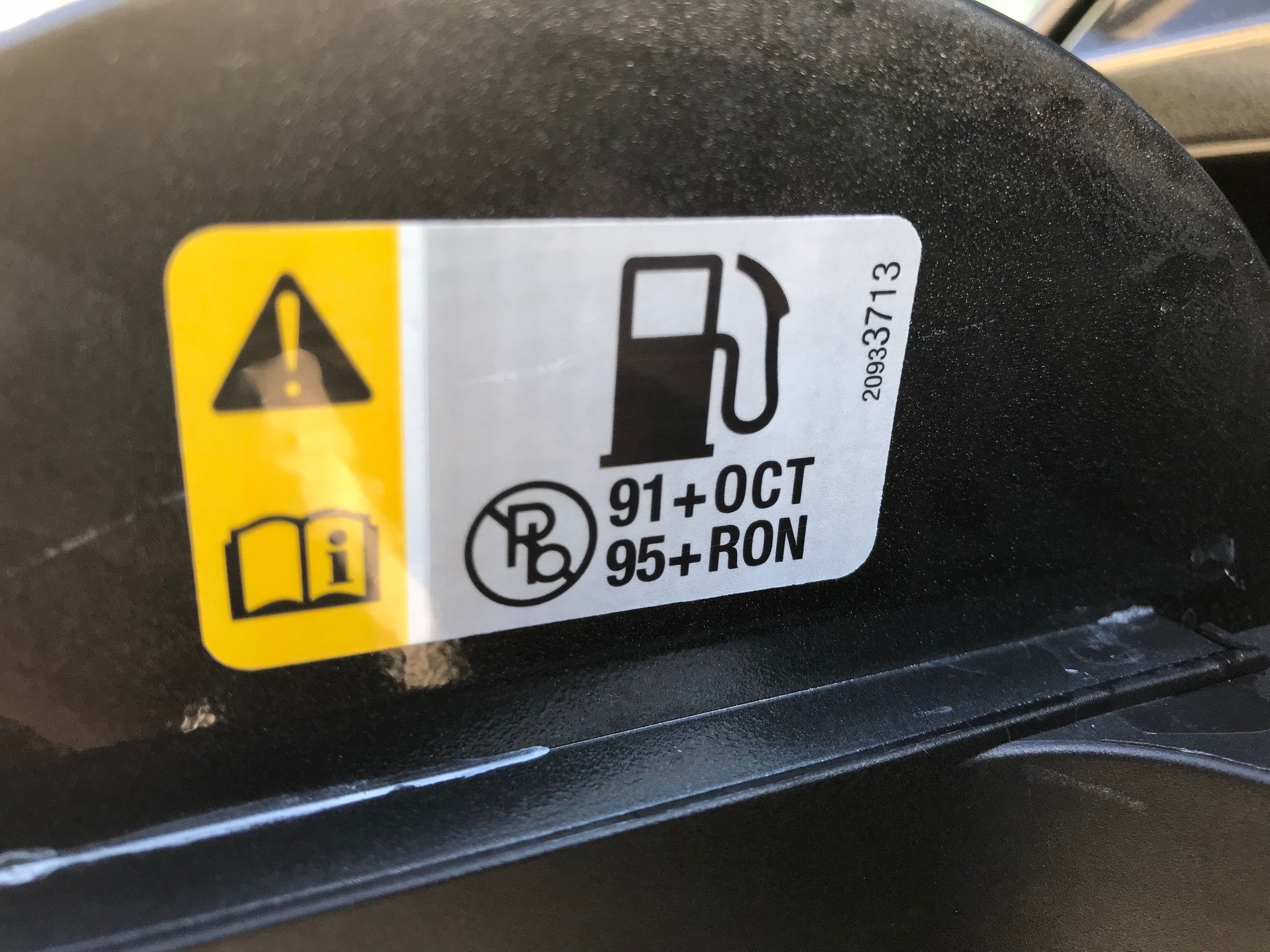

Anyone ever notice this little nugget? Fuel filler door on a non-native California car.

After some Google research, just couple of minutes, I found RON stands for Research Octane Number, MON is Motor Octane Number. Short answer 2 different ways of measuring octane thru similar test engines but with slightly different parameters (engine speed/preheated fuel/variable ignition timing). Couldn't even find the 91+Oct explanation but assume (ugh-oh) it just means 91 or more(?). Anyhow, just put what the OM says to use (LT1 versus LT4). There is the OCD way of doing 50/50 or 60/40 mix of different Octanes of fuel to get what you need/want, but seriously? Our cars computers can adjust for a wide range of fuel without tunes but I would err on the slightly high side if no other choice. There is agreement by most companies that is possible to damage the cats using higher than recommended Octane because some fuel is not burned in the engine & burns when entering the Cats. I suppose that is why tunes are done to run Meth or higher Ethanol blends for track/racing. JMHO

Yah. We Americans are a simple people and cannot be confused with TWO octane numbers, so they average them for us. Problem is when you actually need 92 RON but you've some low RON averaged with some high MON. It averages out to 92 but still detonates... just a contrived example.

I was merely pointing out the irony of a sticker that, at the same time suggests minimum 91 octane while also directing the driver to the owners manual (which we’ve all seen in 900 posts recommends 93 octane). I made the California comment as an aside in case anyone thought the 91 octane sticker might be a California-specific decal.

The sticker indicates 93 octane. That's (R+M)/2. And, I have the same sticker on my California car.
