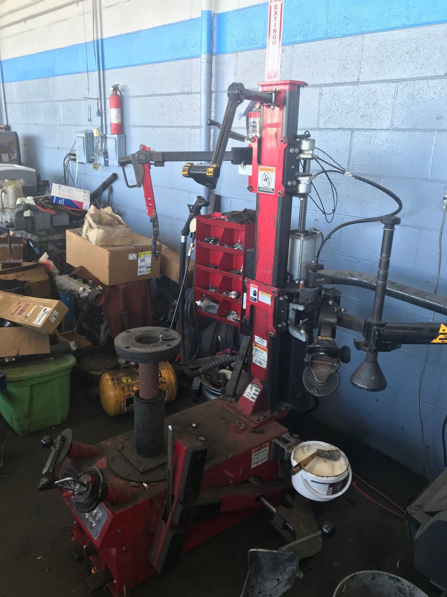

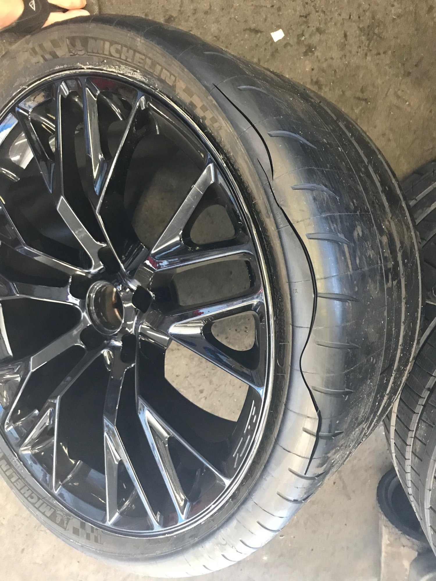

Brand new Michelin Pilot Sport Cup 2 ZPs going on factory wheels. 3 of 4 go on fine, then this. Tire Rack claims excessive force by installer and my trusted dealer tech who does these all the time says bs. Sounds like Michelin will cover and reimburse after 4-6 week process. Who should I believe?

Oh, and America's Tire will match Tire Rack (which I only found out when I brought the tires and wheels in for mounting)
It looks like they applied too much force to the transition point between the extremely stiff run-flat side wall, and the more pliable tread. These tires can take a tremendous amount of effort and energy to mount (and get the bead to set), and they WON'T be forced. They'll just fight you harder.

FWIW, the stiff sidewall of these ZP tires is the inner wall, not the outer wall.
Old Feb 12, 2018 | 01:54 PM
MacRoadie's Avatar
MacRoadie
Joined: Nov 2017
Posts: 473
Likes: 89
From: Yorba Linda CA
Right. So if you applied too much pressure close to the transition (too far up on the sidewall), you're, in essence, "stretching" the outer wall over the inner wall, basically using the inner wall as a fulcrum. That would explain the tearing. The outer wall is bonded (anchored) to the bead, so stretching it over the rigid inner wall could possibly rip the rubber if the tension load exceeds the elasticity of the rubber. Bending any material will place tension load in the outside surface and compression load on the inside surface.

Looks like the rim is kind of chewed up as well ...
