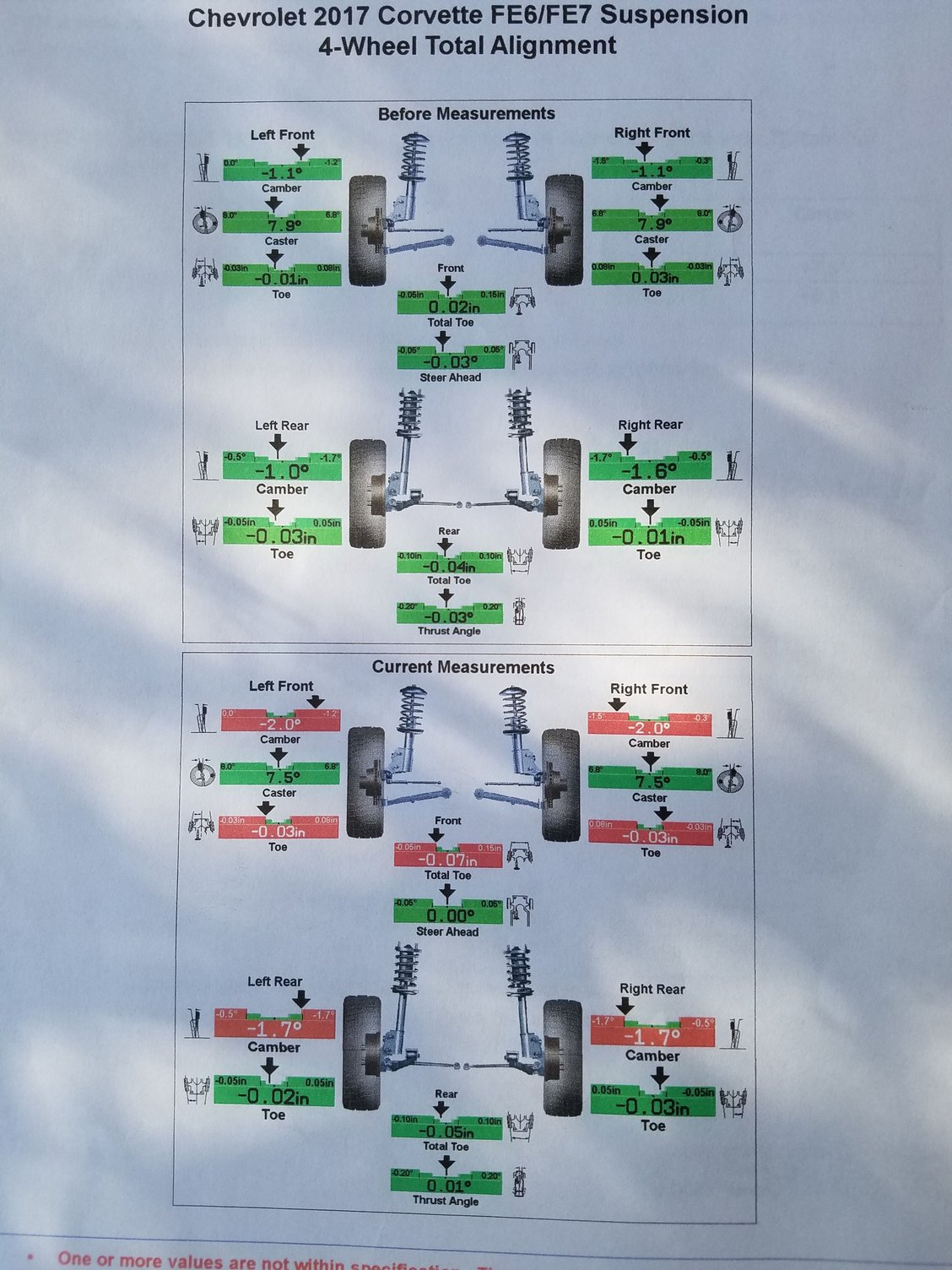

Mine After Alignment
Left/Right
Rear
Caster 1.00 /1.00
Old Apr 12, 2018 | 08:32 AM

FYI - my
Before Alignment Measurements
Rear
Camber -1.20/-1.50
Caster -1.00/0.00
Toe -0.01/0.06
After Alignment Measurements
Left/Right
Rear
Camber -1.20/-1.20
Caster 1.00 /1.00
Toe -0.04/-0.05

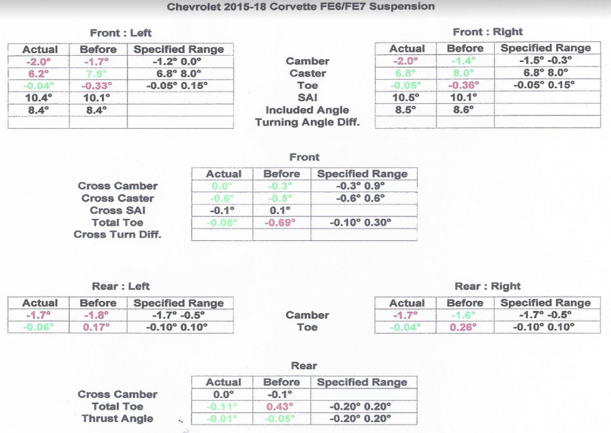

This is my alignment to DSC street/track, it feels "loose" on back roads. The stock alignment felt planted and confidence inspiring, this just feels darty and ready to break loose in the rear, less grip out of corners. Will be on track on Thursday to test it out.
Your feelings sound more like a rear caster problem it sure does not appear to be your new numbers. They should be very good for the track that's about where we started 3 years ago and now use even more camber.
Was on track tonight at Thunderhill, the car felt great. Really liked how the new alignment performed. Felt similar to my spring mountain Z06 but faster and with better brakes. I was running ferodo ds1.11 pads and with real 93 octane gas.

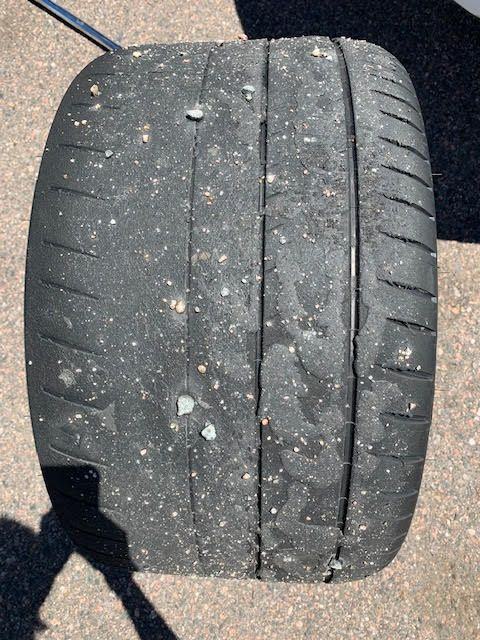

Hi,
I have a Corvette C7 Z06 that I track about 1-2 times a month. The "stock" alignment was horribly off when I bought the car, managed to cord the front tires pretty quickly. I did the DSC Sport "Track/occasional street" alignment with the washers removed (see attached numbers- "actual" is what they are now).
I bought a set of Sport Cup 2 ZP tires to see what the car could do with those just prior to this alignment. They felt great, nice and sticky throughout a weekend, but the wear seems uneven to me. Attached is a photo of the right rear tire new, and a photo of the right rear tire after ~ 500 miles (street driving and two track days (six 25 minute sessions)). I also included a picture of the LEFT rear tire off the car - see how good the inside edge looks?
Any thoughts on whether there should be some alignment change? I also wore through a rear brake pad shockingly quickly on one side this weekend, so I'm wondering if something is off.
This is the tire as it looked new, about 20 miles after putting it on.
This is the tire after I drove to the track and back twice and two track days, ~ 500 miles.
Tire off the car in between track days.

Those tires look great much less wear than I have after two track days.
