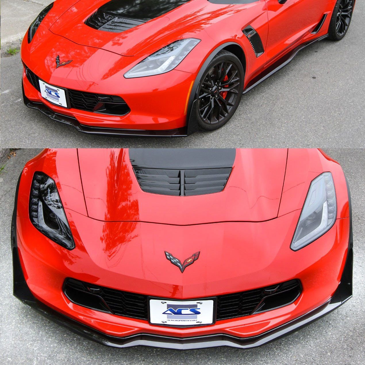

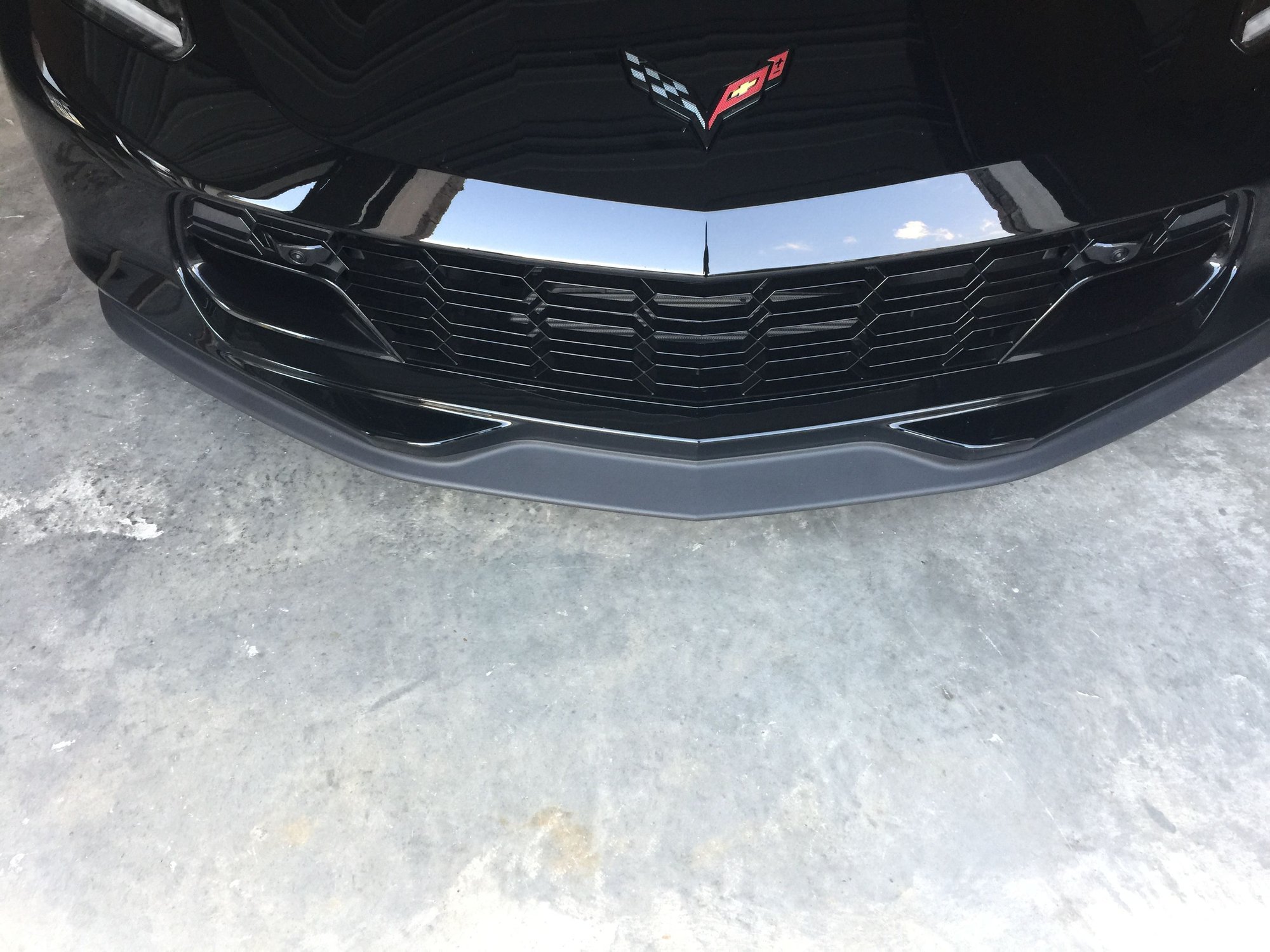

I am new to the C7 ZO6 world,
what parts do I need to order to take my front splitter ( Black ZO6)
to the look in the (Red ZO6) with the side winglets
aldo what is the best place to order the parts. Thank you in advance
in Carbon Flash Black

RPI has what your looking for

Yeah that's one of the first things I did to my car was take off my stage 1 splitter AKA poverty splitter and put on the stage 2 carbon flash splitter with the stage 2 winglets not the giant stage 3 winglets

you need to replace the plastic one you have with a painted stage 2 with the stage 3 winglets. Lots of vendors on here sell the stage three in carbon flash. I will be changing out my stage 1 next month, still not sure if i want to go stage 2 or 3 but leaning toward the stage 3.
