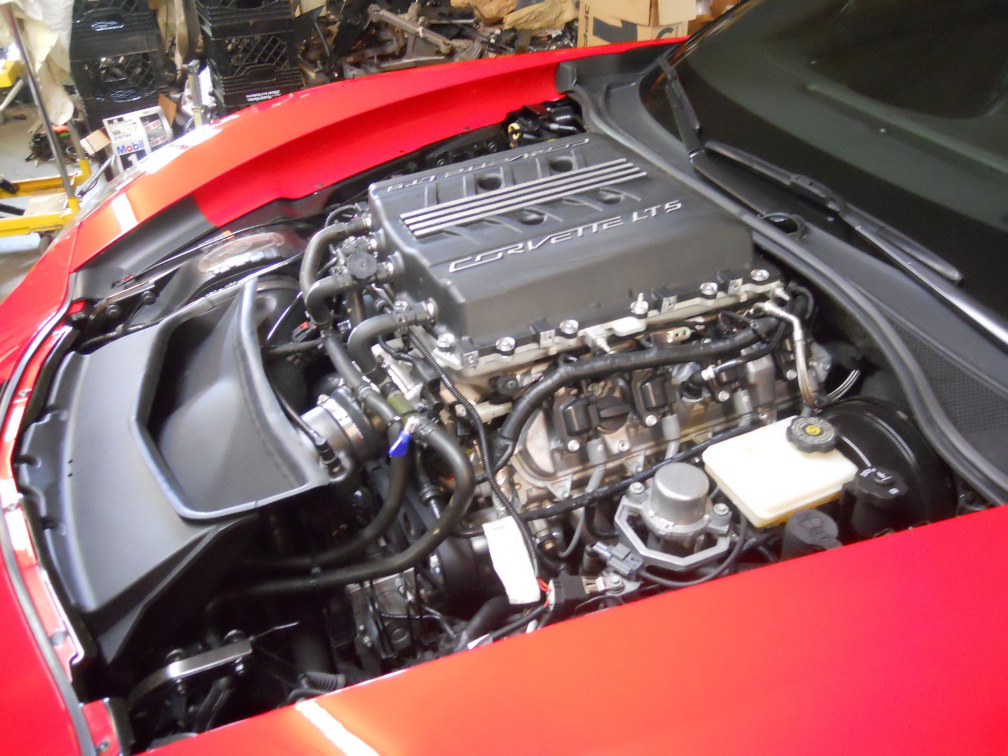

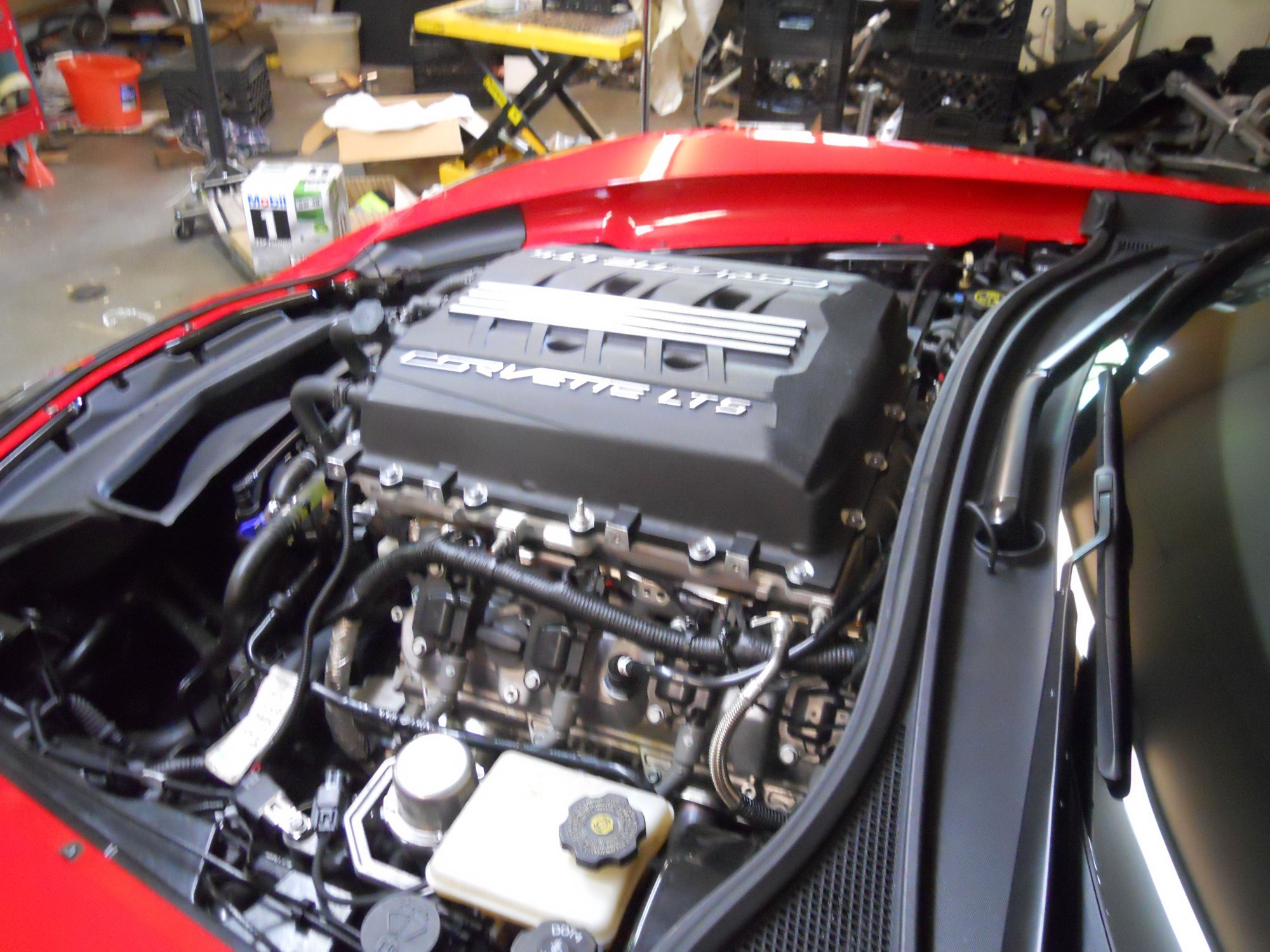

I installed a ZR1 create motor in my Z but cant find a hood that will clear the super charger Some of these Companies that makes hood needs to stipe up and make a hood that will clear the ZR! super charger
Congrats on the swap!! Here is my hood. Should clear
amazing work Sammy! Any reason for going full LT5 motor over just the supercharger? What’s did you do for ECU? Looks like there is bags of room at the rear of the blower!...
Will the main reason was the LT5 has a 11 rib pulley & the LT4 has 8 ribs you could have a 8 rib made for the LT5 blower but again you would not know if it would line up with LT4 pulleys to many unknows for me. You can run the LT5 motor with a LT4 ECU .

From these pics, looks like my hood should fit the LT5 blower just fine.
