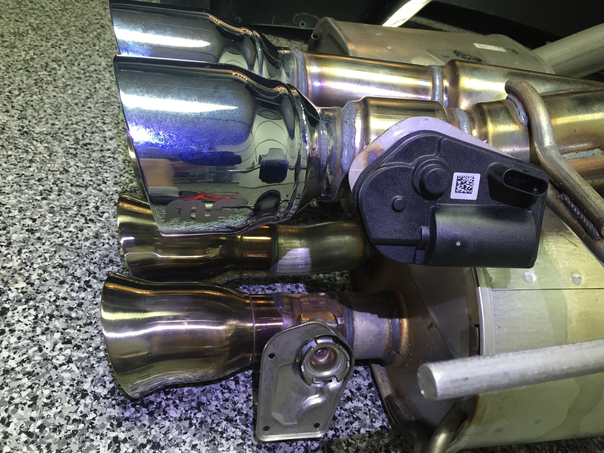

No, they are controlled by electronic motors mounted to the exhaust valve. You can often hear them move if you turn the car on but do not start and change modes.

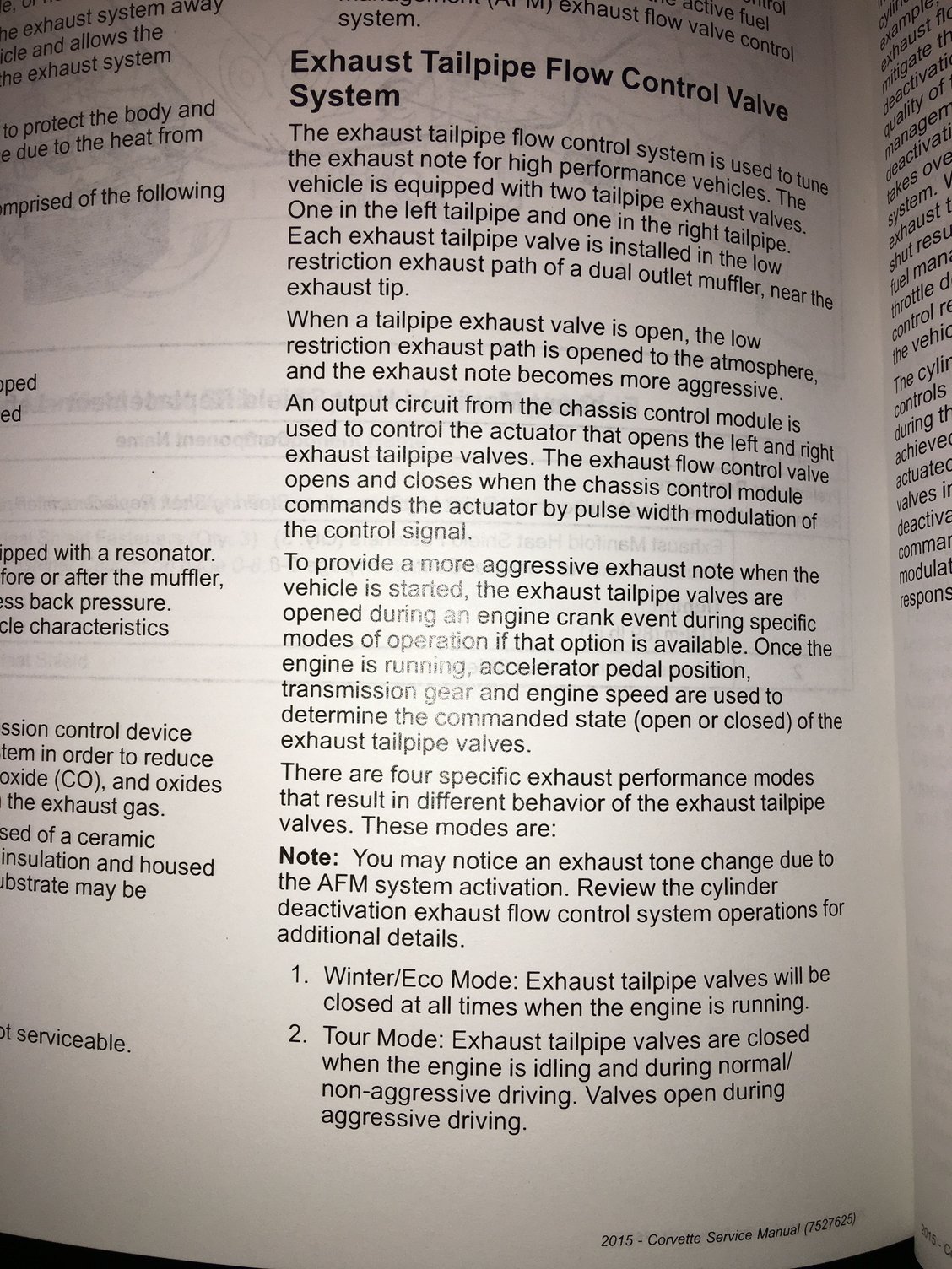

Since you have an M7 the exhaust will work in the following manner: Set the exhaust in Stealth Mode by using the Engine Sound Management system it will be quiet on start up. With the M7 and the Exhaust set in permanent track mode you will blow the windows out of the neighbor's house with a cold start in the morning. However, if you have the Exhaust Linked to Drive Mode with Drive Mode set to Weather or Eco the exhaust valves will stay Closed at all times. If you want a loud exhaust all the time then set the Exhaust to Track Mode and the only time the valves will close is when the car is in Eco Mode and the engine is running in V4 mode. The A8 cars are similar to this but they are programmed to run in V4 mode outside of the Eco setting so the valves will close anytime the engine switches to V4 even if you are in Touring, Sport, or Track drive modes. The only way to get around that is to operate the transmission in manual mode. Then it will behave like the M7.
You will still get people who swear the M7 exhaust doesn't perform this way but it does on my M7 and GM didn't make the cars that individualistic. The FSM isn't lying.
