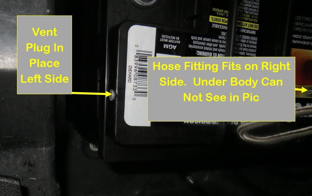

Does our battery case have the vent line to vent gases out of the battery outside the car like in the C6Zs? That was an issue when I replaced the battery in my 08 in 2014. My 2016 is just 26 months old now and won't need a replacement for a while.
Yep, hose is on the right side. Hard to see until you pull the battery partly out of it's hole.
Even the AGM I installed had place for a hose on both sides. The removed hose end fitting pushed into the new battery.
