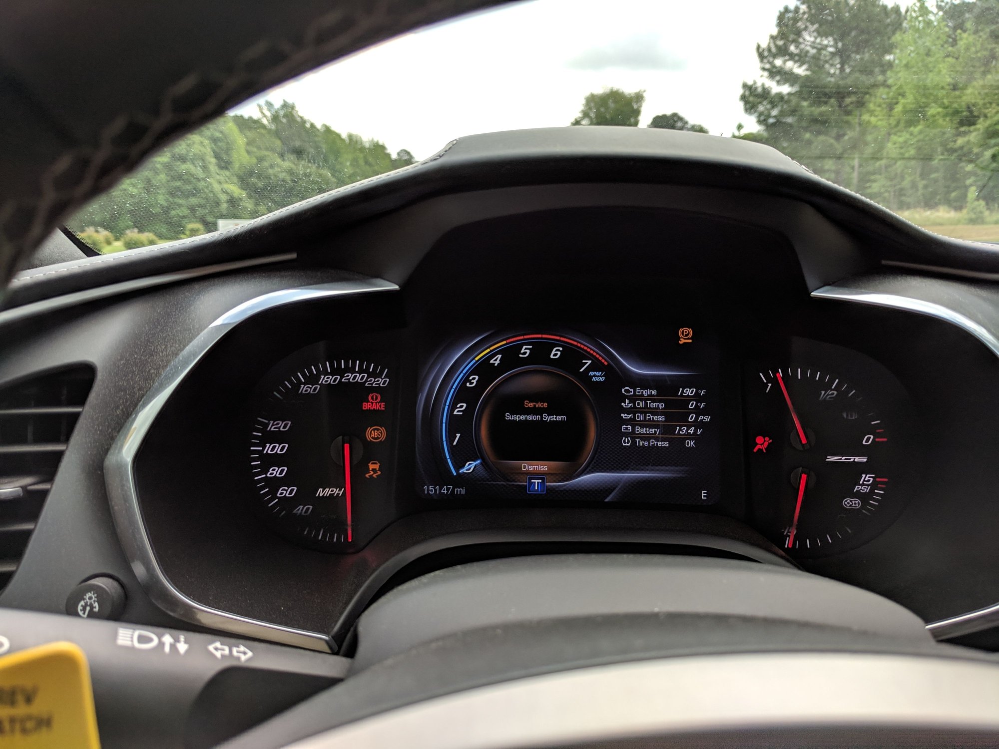

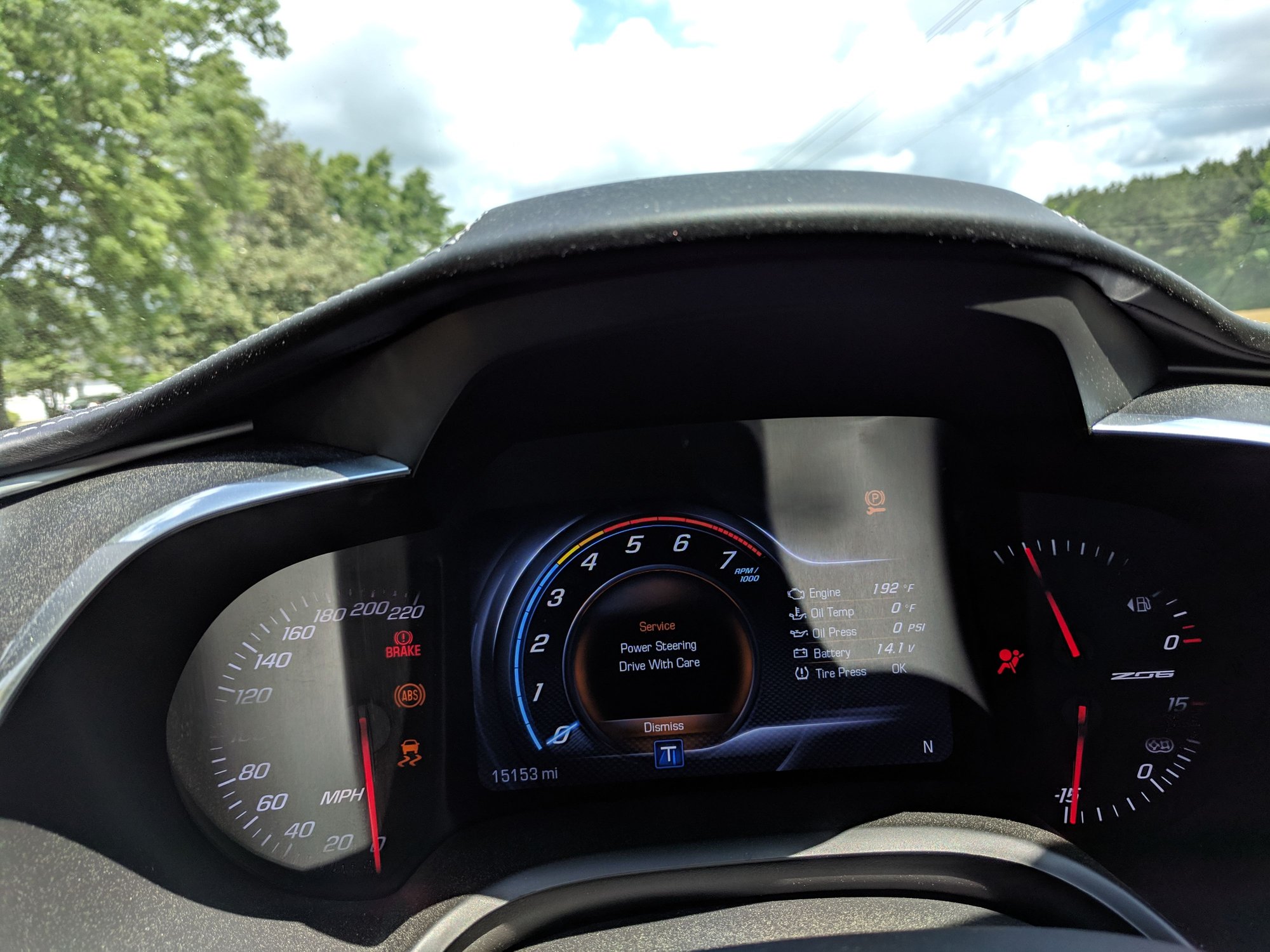

I had an appointment this morning and decided to drive the vette. On the way home service stabilitrac came on and went off several times. Then I got a bunch of messages, service suspension,service power steering drive with care, service stabilitrac
, speedometer stopped, mufflers went full quiet, oil pressure went to 0 along with oil temp, a/c stopped working. Then it all popped back on. This happened several times on the way home. I have dsc module and shocks but otherwise pretty much stock. Anybody else have this happen?

I put an odyssey performance 48-720 in it last summer so I don't think it's that. I disconnected all of the cables and made sure they were clean and put them on tight. I also disconnected and reconnected the EBCM but I haven't had a chance to drive it again. I checked the ground wire that's beside the alternator and under the a/c line and that was really tight so I don't think that's the issue. I'll give it a test drive later today and report back. The car is a 2015. I've used the battery minder since I replaced the battery and never had any issues starting.

Made it about 10 miles and it started roaring and died. Running really rough. Won't start. Got my trailer and loaded it up. Not looking good.
