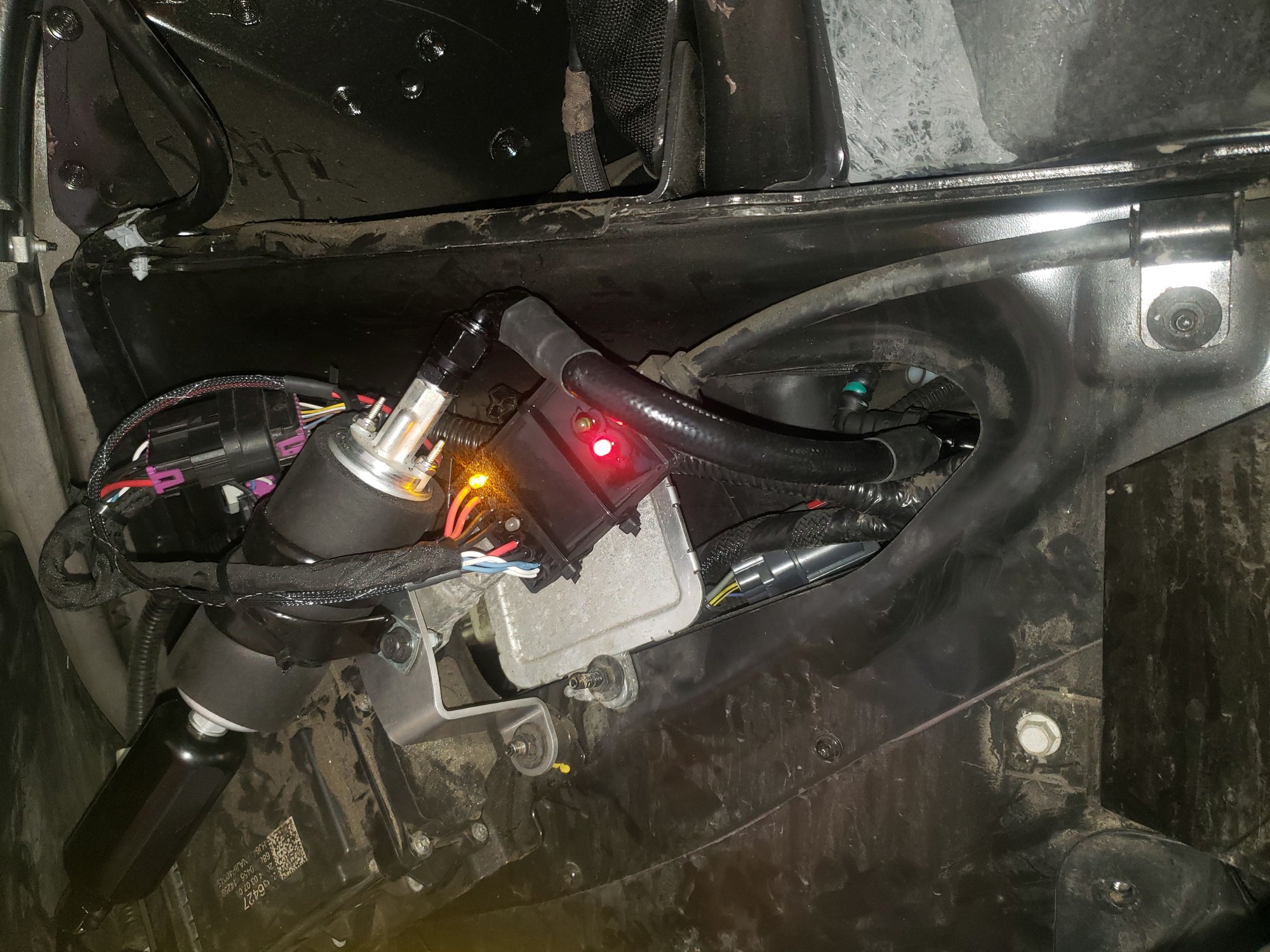

Hope these help. I drilled a little to the right of the furthest right yellow dot in your pic

You don’t want to tap anywhere that will be rounded. You need the tap location to be flat. Thats why I tapped it in a slightly different place than where the instructions showed
