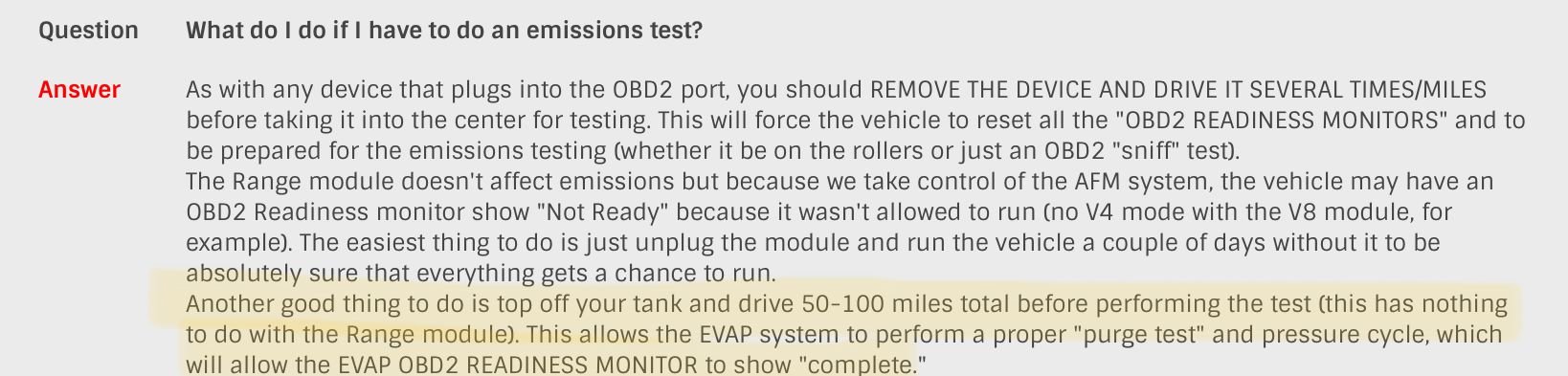

This attachment is directly from Range Technology's technical support website. Make note of last paragraph highlighted.

Bought mine directly from Range. Very nice folks and happy to answer any questions. I've had it in since I got it and it has done exactly what it's supposed to do. There is no "Down side". It receives the cylinder deactivation signal and returns a Command satisfied signal. I actually left mine in when I went to the dealership. Tech didn't say a word. It does not alter or tune the car. Totally safe and I like the fact that no matter what mode the car is in, cylinder deactivation is flat. No matter if I had the M7 or the A8, I'd have one.
