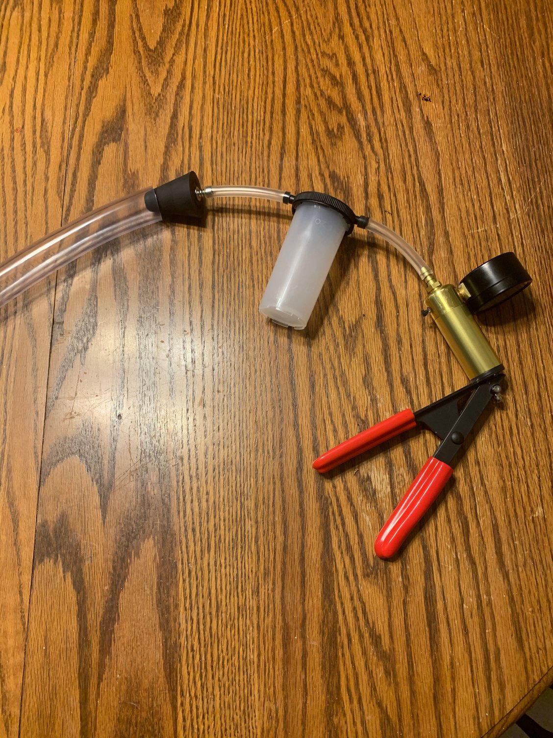

Do you have a pic of how you pulled a vacuum on the fill port?

I didn’t get pictures while doing it, but this should help. Also there is a write up on here with details.
Assembled
Remove cap by removing the wire retaining clip and then sliding the hose over it.
To reverse lock out help
