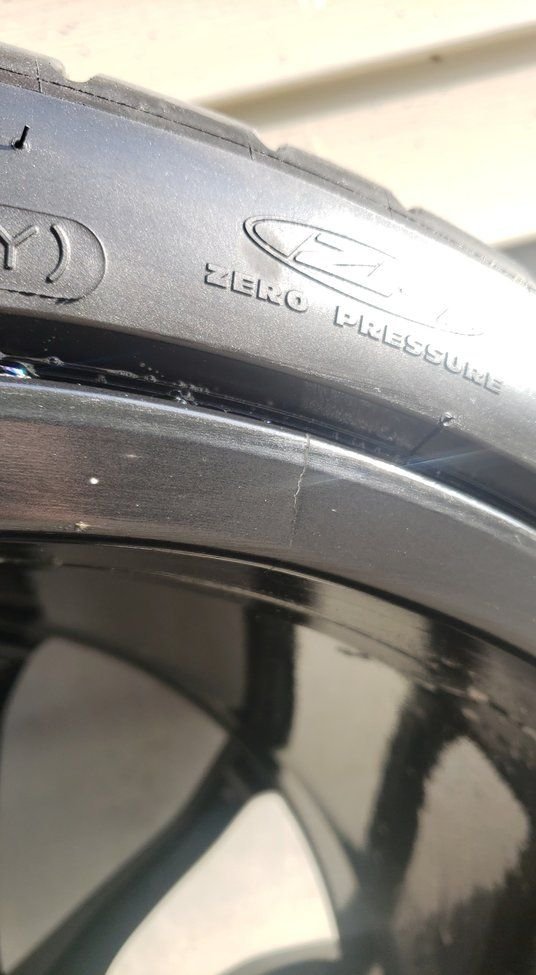

I have 15,000 miles on my 19 GS. Use it just as a daily driver, no track. So far no problems with the stock OEM wheel. However, I really expect it is just a matter of time. I have a rainy day fund if the cracks begin to develop. I closely monitor tire pressure every time I drive the car. If I ever notice a precipitous drop in any tire pressure I will check for a flat but also check for any crack development on the inner barrel rim where cracks will form if present. These wheels are structurally deficient. Regarding OEM on the track - absolutely not. They are not safe at those speed. Wheels will be most heavily stressed structurally going in and coming out of corners. Flow formed forged wheels are marginally better as the inner hub and wheel spokes are actually cast aluminum. Only way to go is mono-block forged.

The outward face (the side you see) of the OEM wheel is the strongest structural part of the wheel. You shouldn't expect wheel cracks there unless you hit a wall at speed. All Corvette OEM wheel failures are occurring on the inside rim face. Every one of them. This is the part of the wheel which is unsupported, the mechanical stresses are highest there in all high speed turns, the barrel depth has an exceedingly deep offset as well as the **** poor design of the OEM cast aluminum wheels make tracking OEM Corvette wheels on a wide body Corvette a crap shoot. Hope you have a good track insurance policy and your life insurance premiums are up to date.

I have been closely tracking the bent/cracked wheel issue for 2 years now. I have examined every photo posted on Corvette Forum of C7s with wheel cracks. They all occur on the inside inner barrel rim. They all look like this photo.
I assume your crack was not due to an accident. As you are the only one who has stated your crack is found elsewhere on the wheel could you post up some pics illustrating your wheel cracks/damage? The community would be interested in viewing these.
