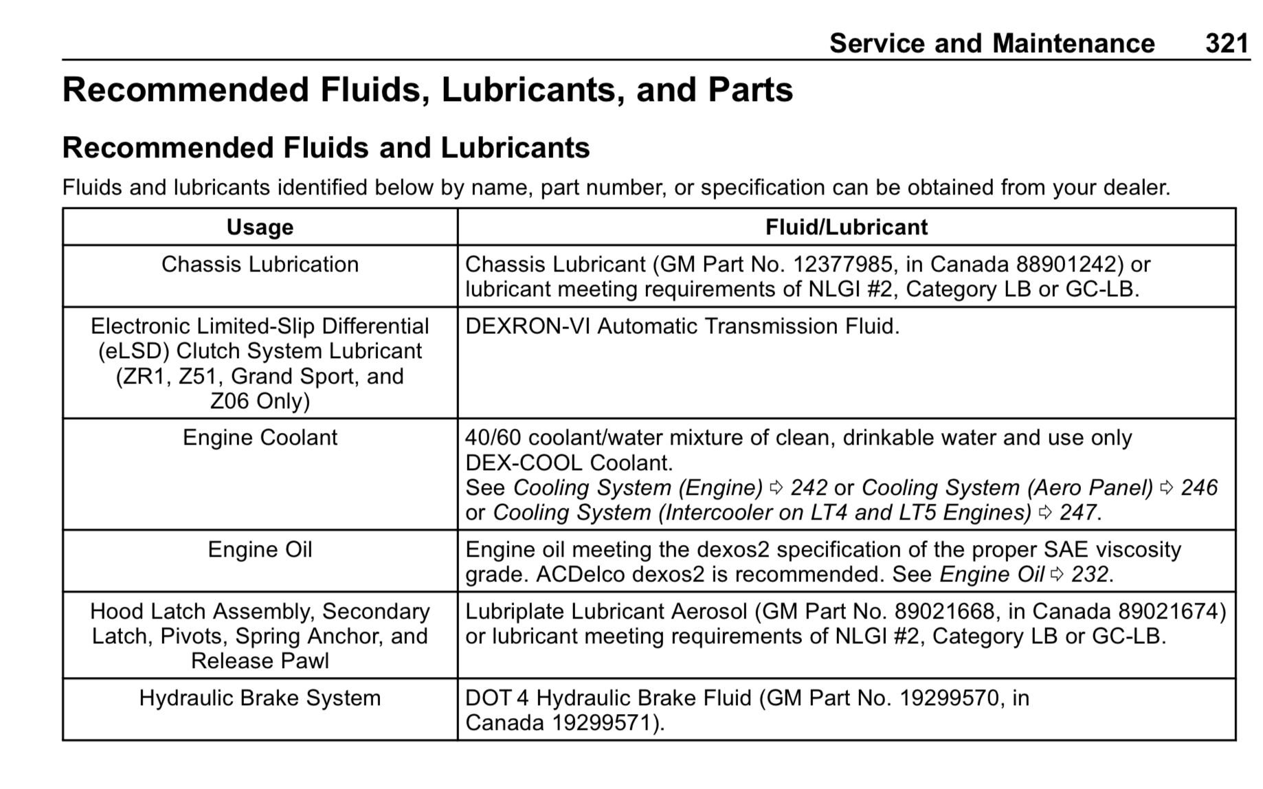

The ELSD is a little different in that two fluids are required.
Dexron-VI ATF is used in the clutch area of the ELSD.
The area of the ELSD that houses the ring & pinion gears uses 75W-90 gear oil.

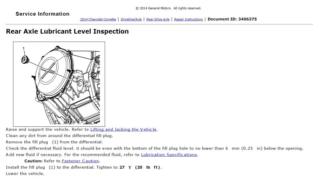

The part of the ELSD with the ring and pinion gears uses 75w-90. About 3 quarts if I remember correctly.

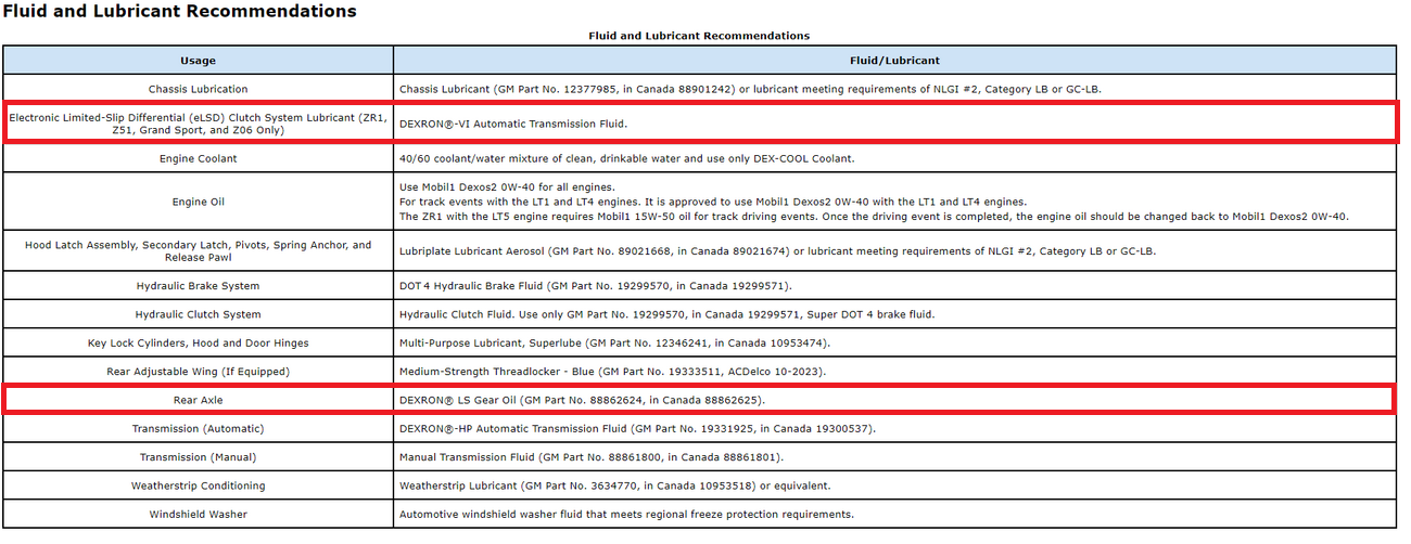

Credit to @sevinn who posted this in the OP's other thread on this topic.

What confuses people is reading posts like yours. The owner's manual clearly states which fluid is required. The eLSD is not normally serviced. ATF is used within the eLSD. The eLSD is to used to drive a hydraulic system which drive pistons, using an a computer controlled pump, that clamps clutch plates shut. This side of the differential assembly is isolated from the gear oil that flows within the gear assembly.

And yes, the owners manual states the clutch portion of the ELSD takes the ATF.
And the following page in the OM states the rear axle (where the ring and pinion gears are located) requires the 75W-90.

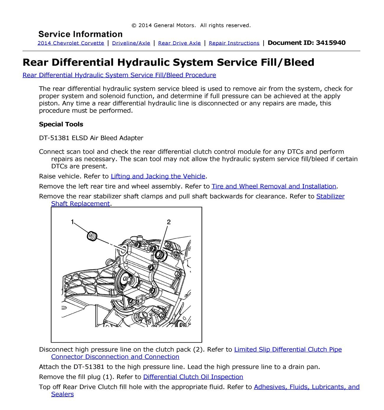

I would love to change the fluid in this, but after reading the manual it is much more complicated than just draining and refilling. It takes a special tool to circulate the old fluid out and replace with new fluid. Has anyone found a way to change it??

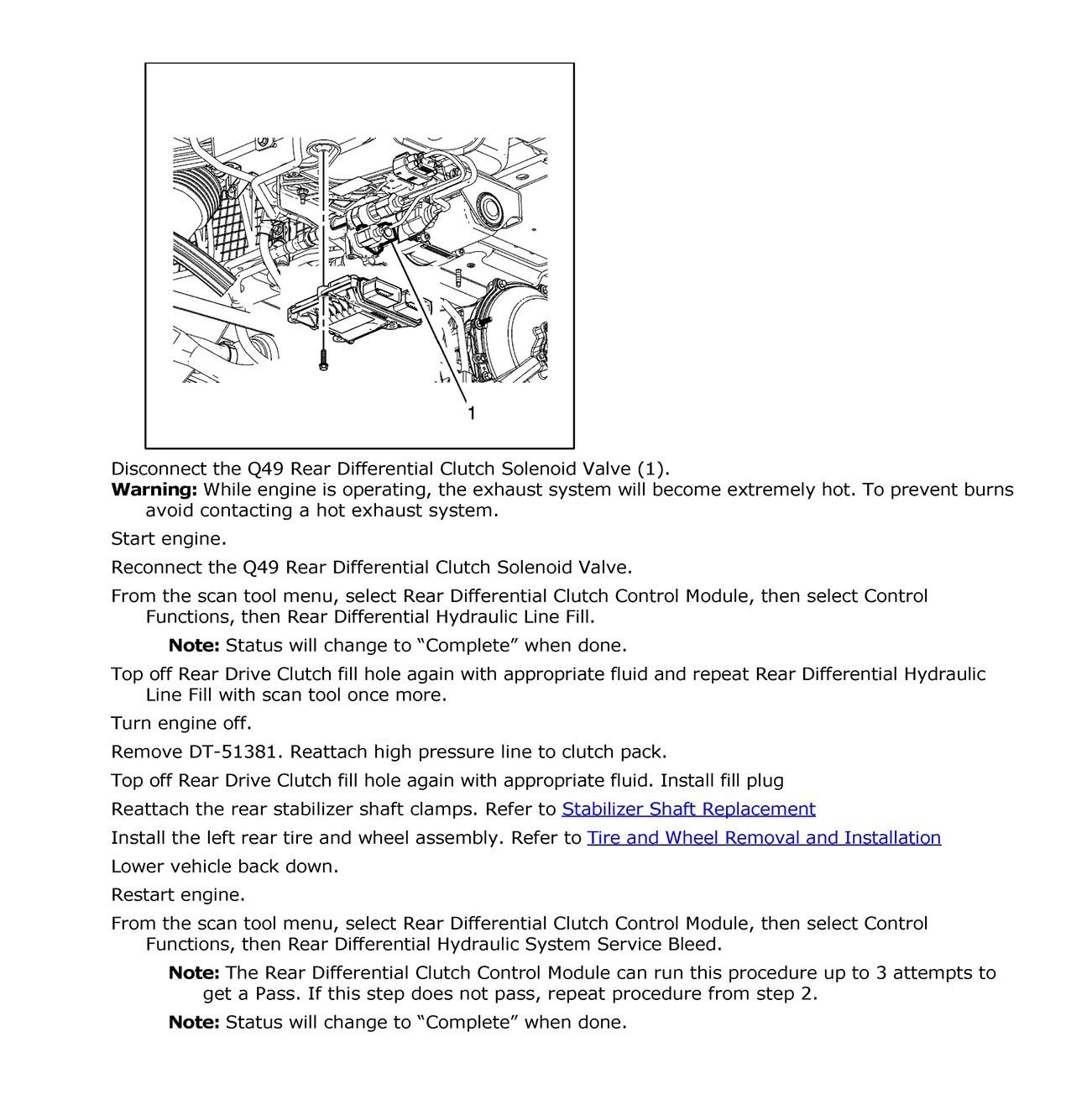

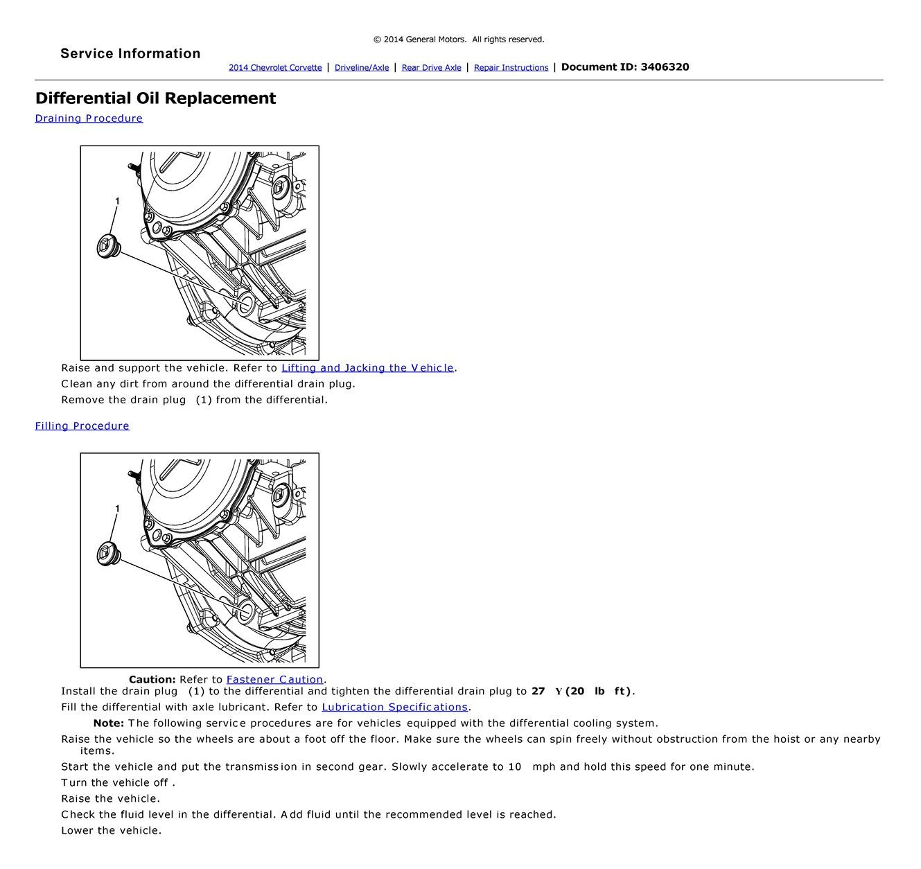

If you are tracking the vehicle you should get the eLSD serviced. You should have a GM dealer perform that service as it requires purging of air using a GM scan tool exercising valves within the pump. Changing the gear oil is another matter. If you do this properly you drain & fill. Then you should drive the vehicle around the block and lift the vehicle again and top it off. I didn't take this last step so my diff is a tad low on oil. I can live with this.

Change the fluid in what, exactly - the diff itself or the clutch system? Special tools aren't required for the former, but the latter isn't designed for DIY maintenance.

So no work around on the e-slip fluid. To bad. There is a procedure in the manual to change the fluid, and all fluid should be changed at some point. To bad there is no work around like owners found with the intercooler coolant. I really don't trust any of the dealerships in my area.
