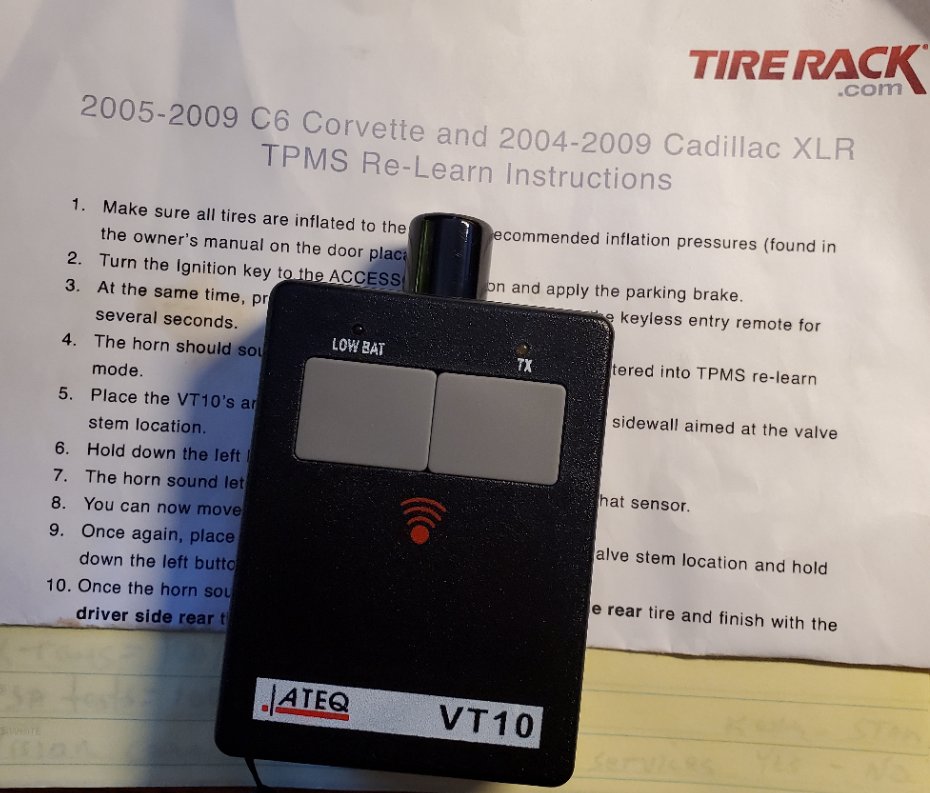

The programmer I ordered doesn’t seem to work. Could you tell me the model of yours?

Old Mar 26, 2021 | 01:10 PM

Does anyone know if my old ATEQ VT10 programming tool that I have been using on my C6 for the past decade or so, work with my new to me '17 C7 Z06? I haven't tried it yet.

I guess you could try it and worst case it won't work and then you'd have to do the learn mode where you drive the car instead

The old programmer should work. The manual learning procedure is to keep the engine either running or on "ON" position, with handbrake on you press and hold select button while it's displaying tire pressures in info screen. Once you hear the honk, just register sensors starting from the driver front, clockwise.
As mentioned, no need to switch to learning mode for auto learn. The auto-learn triangulates the sensors to figure out which tire they're at. Actually, auto-learn never stops. When I had finicky sensors, I saw it sometimes registering sensors in wrong corners...
In my experience, auto-learn sometimes works very quickly, but in other times it takes a long time, especially if/when one of the sensors don't comply well. Actually, if one of the sensors is broken, the learning will never complete, and it will not auto-register the remaining 3, either. For this reason, and since I sometimes cook sensors, I use a manual trainer. That way, I can figure out which one is not working well, and can get it replaced with my 'spare' sensors right away : )

Originally Posted by rtv900
Man, I'm embarrassed. I have this same "relearn tool". I must have bought it over 15 years ago and I don't think I ever used it. When I saw this thread, I went to my cabinets and found it. My TPMS have always reset on their own. I remember when dealers used to charge to reset TPMS and I'd need that when I switched from summer tires to winter and back again on dedicated wheels. Remember when the TPMS would pick up signals from other cars and you wondered what happened to the display? I've even had a display show the wrong pressure and then a few seconds later, it righted itself. I thought this tool cost around $60+ then. What's the price of these now? Just checked it and the 9 volt still works in it.
