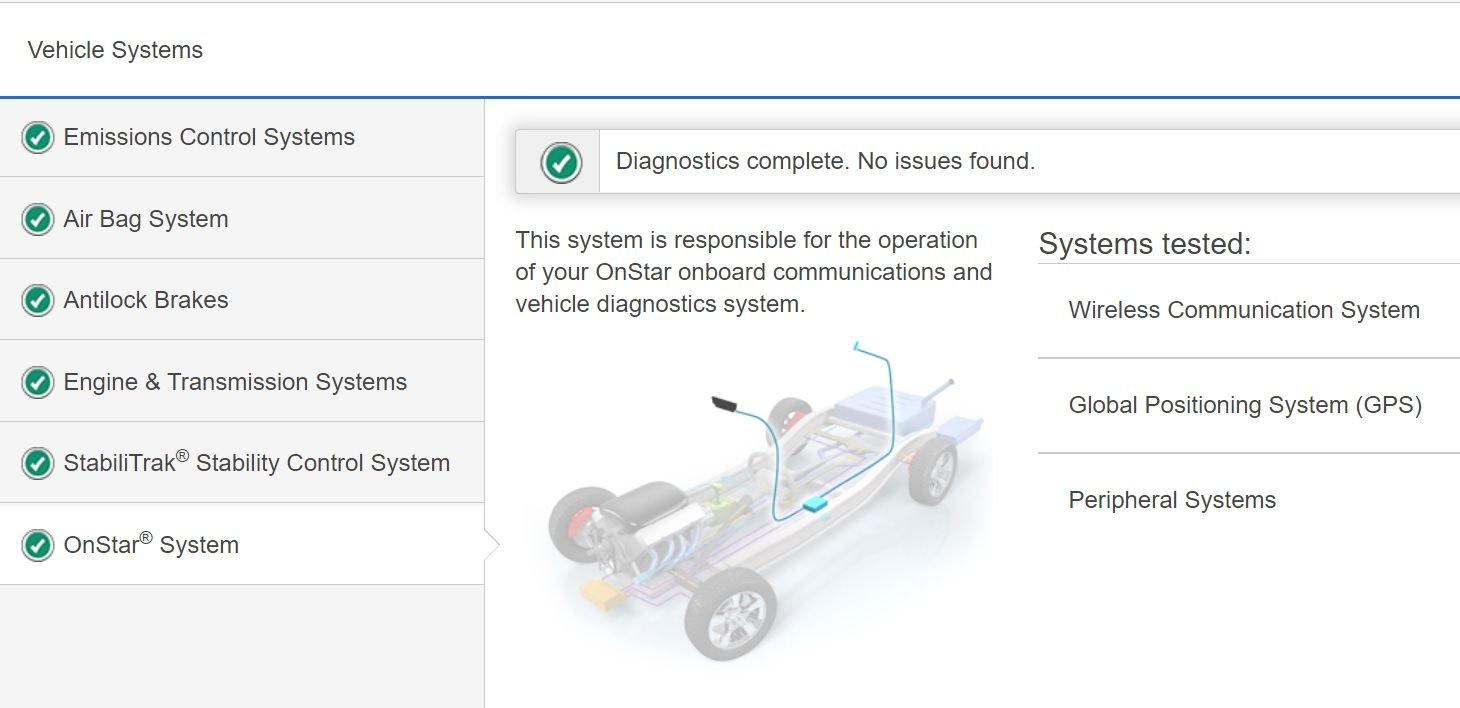

I don't think so - my last full status report from OnStar on 3/22/21 was clean with no warnings and I had the Range plugged in.
edit: Oh, checked just now and tire pressure finally updated to reflect the 30/30/30/30 I set last night... only took 12 hours. lol
I think it's just the new app being buggy. I think the update for the phone app was pretty recent IIRC. It was never a great app compared to the competition with it's responsiveness or appearance. They kind of fixed some of it to look better with the last update but it is certainly acting funky for me. I did test the remote unlock and other remote functions - those work fine.
