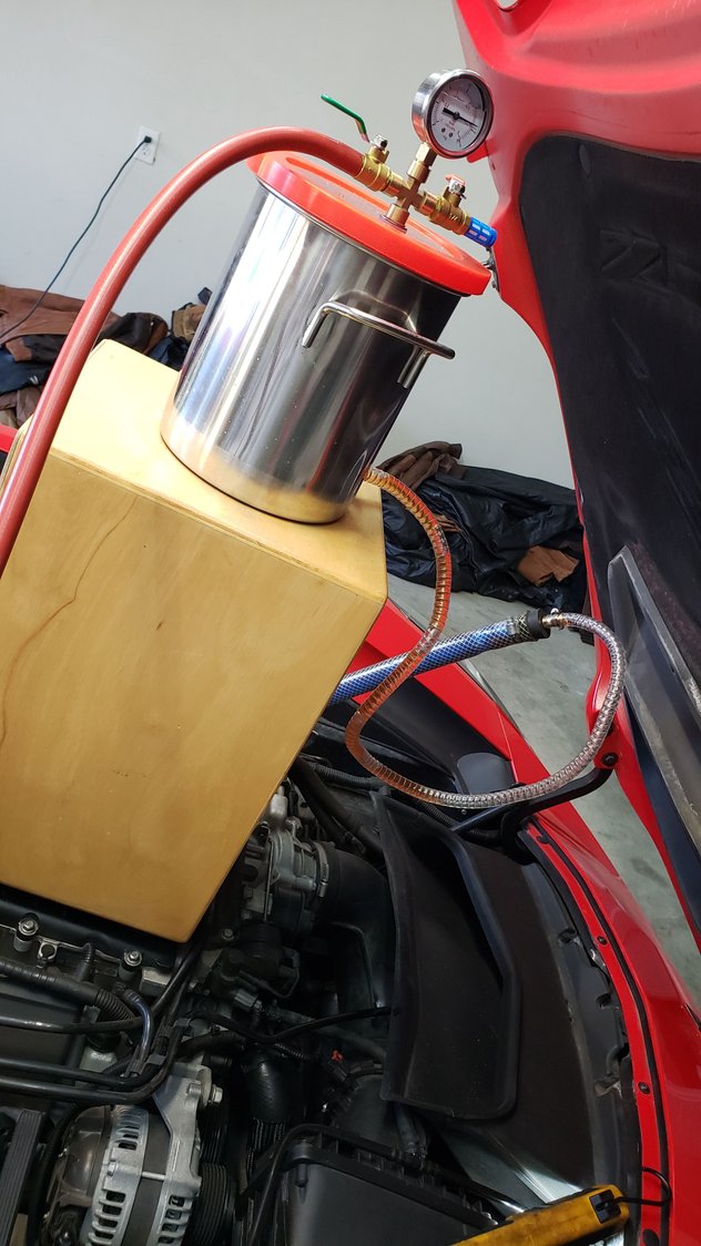

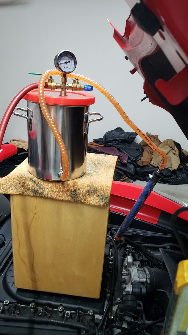

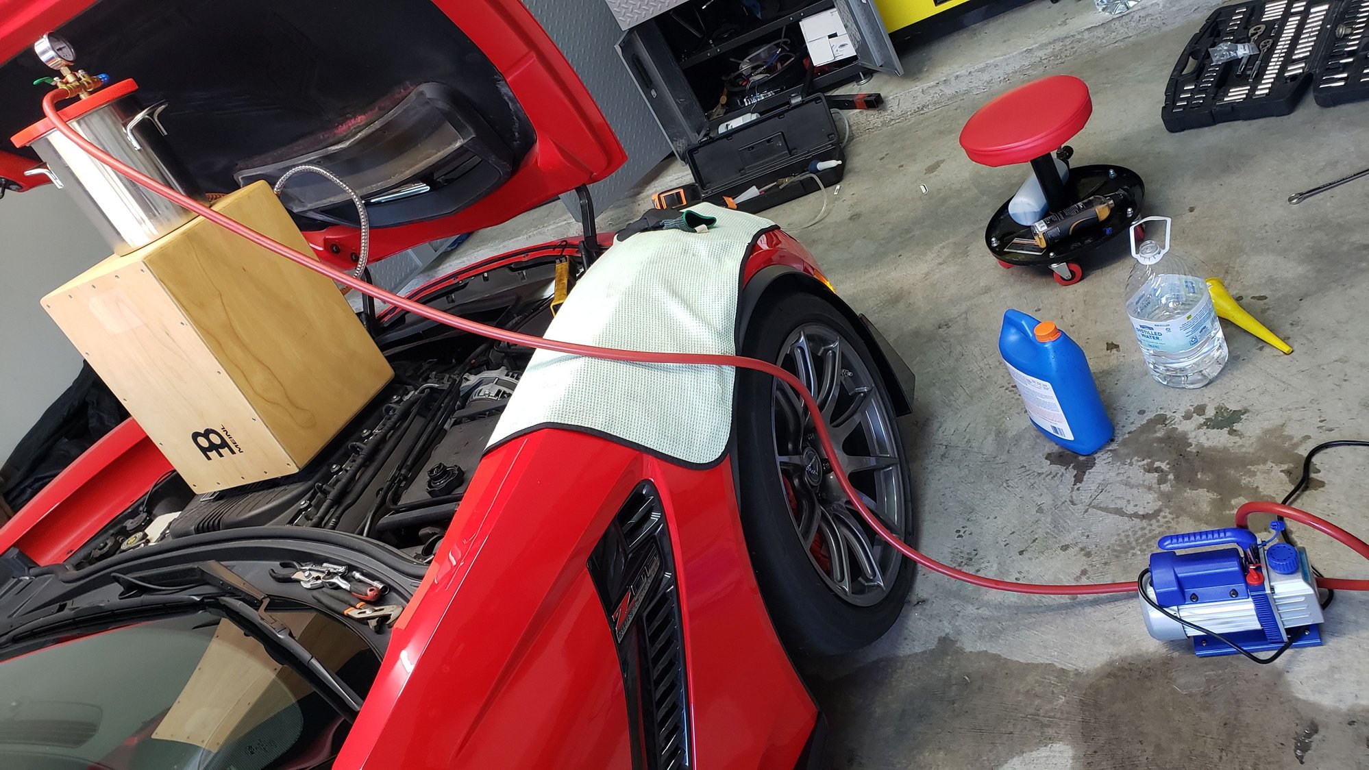

This is great!!!. Thanks for posting it OP.
There is still air on the system. I will try again with the car lifted when I change the front brake pads.
I used HP tuners to run the pump. I tried manual procedure last time, lifting the car and the hand vacuum pump. I couldn't get much air out spending so much time. Now, this is easy, 30 minutes including connecting everything and works great.
