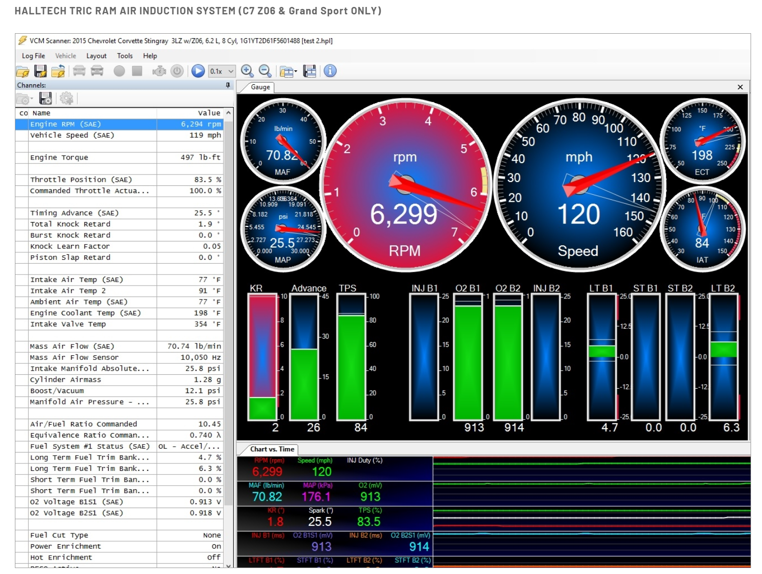

Here is a log capture, after 30 minutes of aggressive driving. Please note that this was with our TRIC ram air system, and the total boost was 12.1PSI with just the Stinger RAZ system. Check out the IAT

If you have the heat tape on the hoses, there will be no heat transfer.
All the major tuners like Vengeance Racing, Katech, Callaway, and around 150 other dealers have purchased our Stinger since 2014, and have not brought this up as an issue. We drove our Corvette for 2 years and this is an easy process when you loosen the hose clamps. They turn very easily, but you want to keep from crimping them in the process.

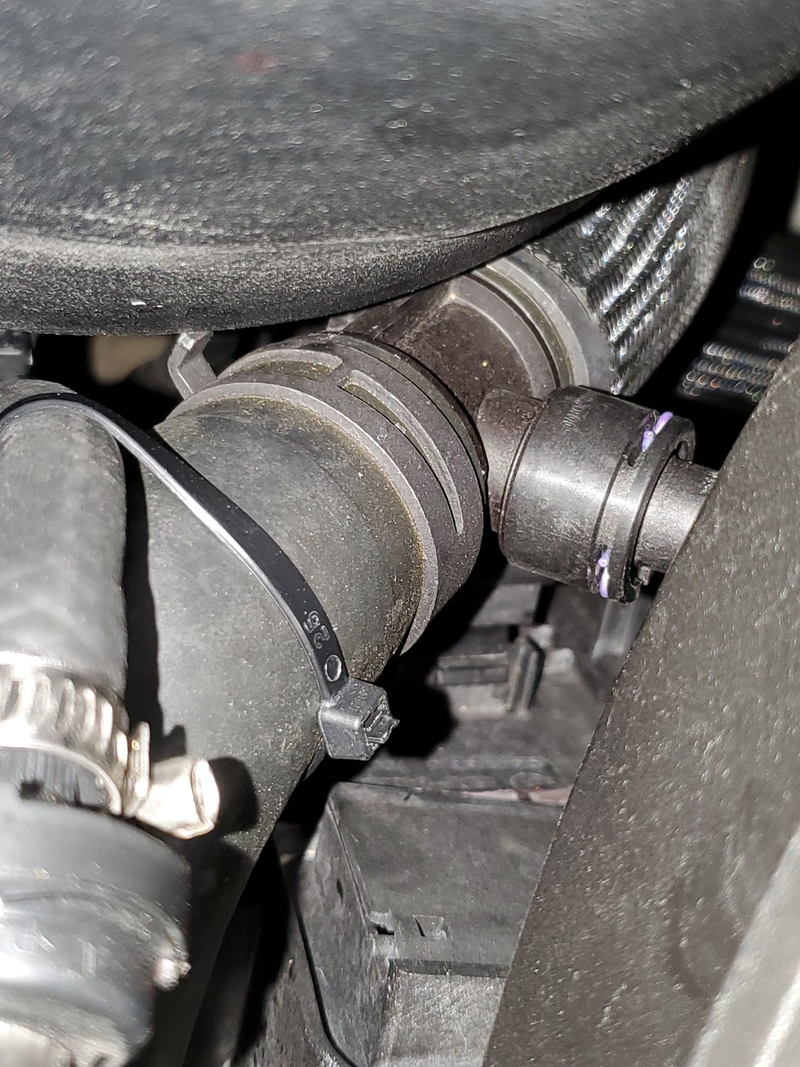

I look through at the front by the radiator and what do you know, more fitment issues. Looks like a metal clamp on the hose is pressing into the airbox. Let me guess something else the shop didn't do right?

You can rotate that clamp away to prevent any rubbing. Still though, the shop is doing a **** poor job for the install.

not to belittle you or your installer,but the pic you sent with the clamp hitting,is it not common sence for installer just to rotate it out of the way and finish the job?and then tell you the problem and how they fixed it?thats what i would do and any wrench with common sense.as you are finding out when you buy aftermarket parts they almost always need tweaking.that is the nature of the beast.thats why i do all my own work when it is bolt on stuff.youtube and common sense saves you a lot of headaches and money.

That's not something they were aware of I'm sure, I just saw that myself yesterday and snapped a picture of it.
