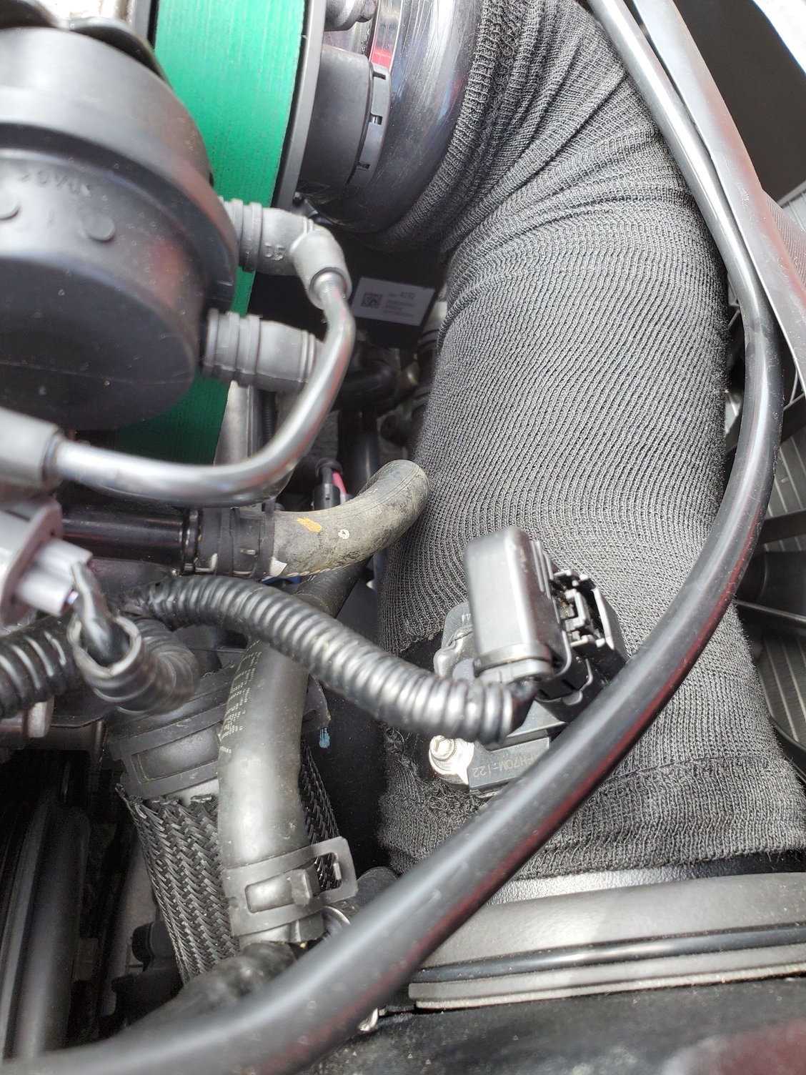

Couple other things I noticed that I just want to make sure won't cause issues are some of the rubber coolant hoses touch the intake tube and another looks to be touching the gasket seal for the airbox. These hoses get pretty hot, will that burn through the tube/gasket seal and is that normal for these intakes? Also noticed my airbox gasket seal looks different from some pictures I saw online for whatever reason, does mine look properly installed?

Also noticed both two big radiator hoses below the intake are touching the intake, one on the filter box and other on the tube. One touching the filter box has the oem heat shield around it while the other has no heat shield, none have the aluminum adhesive that came with the kit. Looks like the shop that installed it never used it for whatever damn reason. Is this a big deal? Will it increase IAT's or burn into the intake?

It really seems like you have enough slack to run that line closer to the engine. While in direct contact it will "warm" up the tube but doubtful it'll melt it. Coolant is hot, but it's not that hot. The ambient temp in the bay is worse at idle and 0 airflow, ie at a traffic light.
I would also rotate that clamp away from the airbox as vibration will cause it to gouge a hole in the box.

So after going back to the shop hoping to have all the hoses making contact fixed, I am definitely not a fan of the fitment of this Haltech intake. Even after following the directions of the installation videos they still claimed they are unable to keep the big hose from touching the bottom of the airbox, so they put dynamat insulator on the airbox and adhesive heat tape on the hose. The dynamat is not very pleasing to the eye to say the least. They claim all the Haltechs they install contact the radiator hose, I'm not sure how Halltech installs it w/o making contact then? Surely it has to be possible. It's pretty unacceptable especially on a car that's battling IAT's to begin with. Will this increase my IAT's even with the heat insulation? Hasn't anyone else noticed the same issues with theirs?
