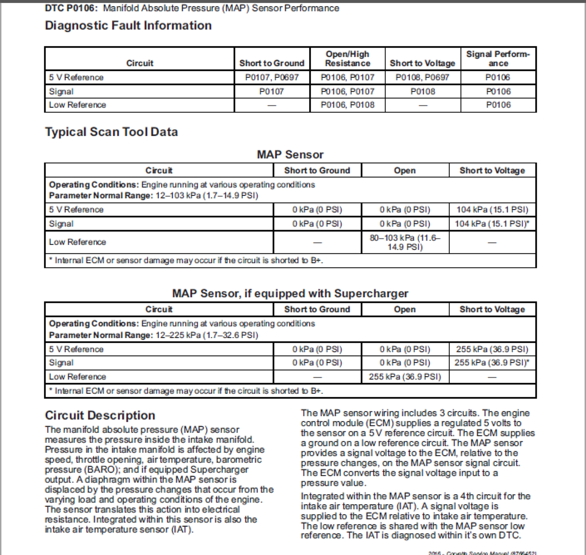

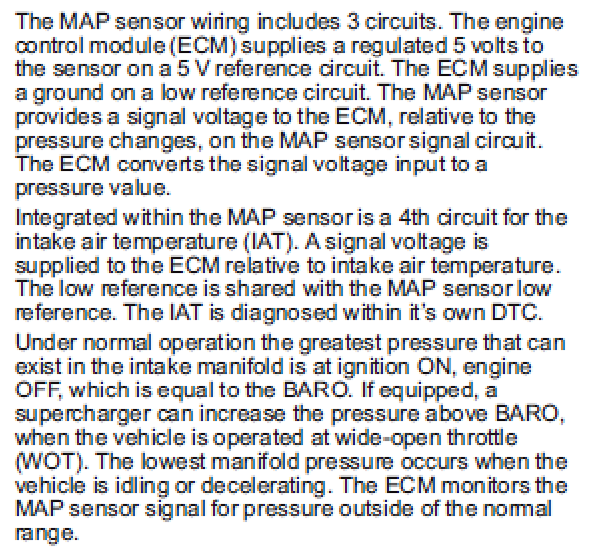

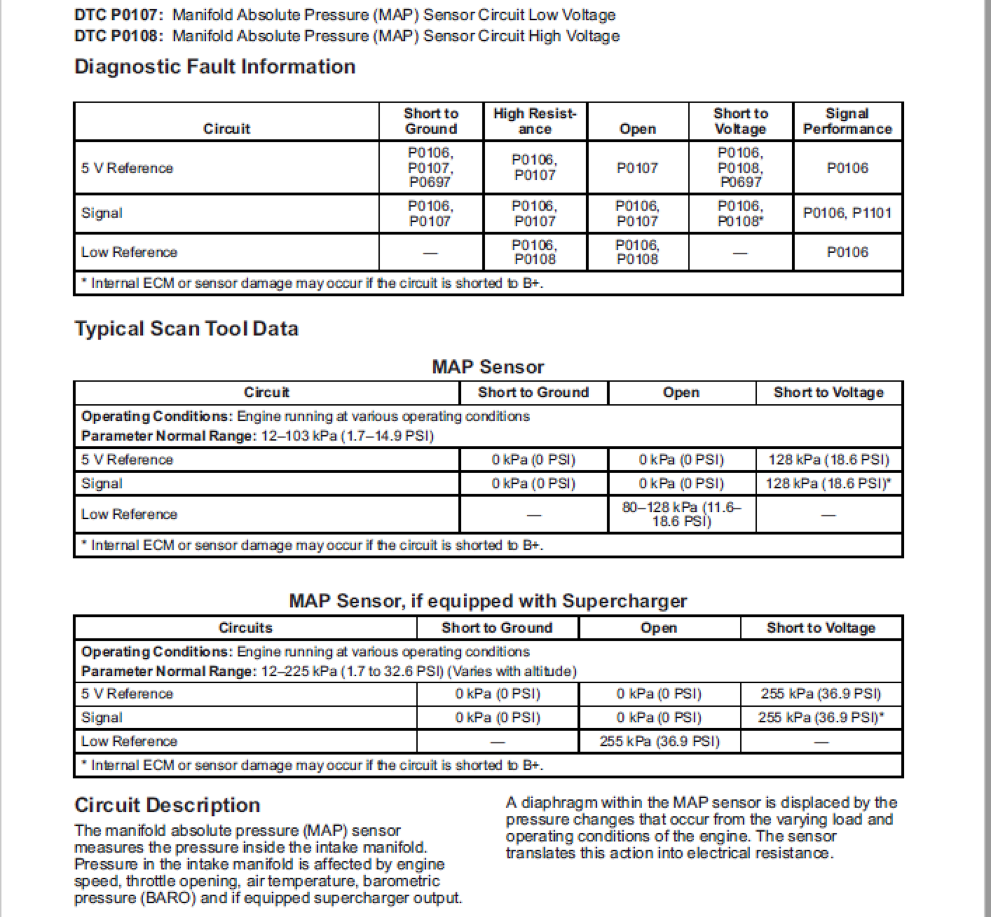

Those codes point to the Manifold Absolute Pressure Sensor which is located at the rear of the SC just under the hood opening flange on the driver's side of the engine. Check to make sure the connector to module B65 is seated correctly and locked in place. If it is locked in place you may need to unlock and disconnect it and determine if one of the circuits is open or shorted. Note the comment that ECM damage can occur if the sensor is shorted to B+ (12V). Make sure the wire going to the connector isn't damaged or pinched. Make sure the pins on both sides of the connector are making good contact with their mating portion.

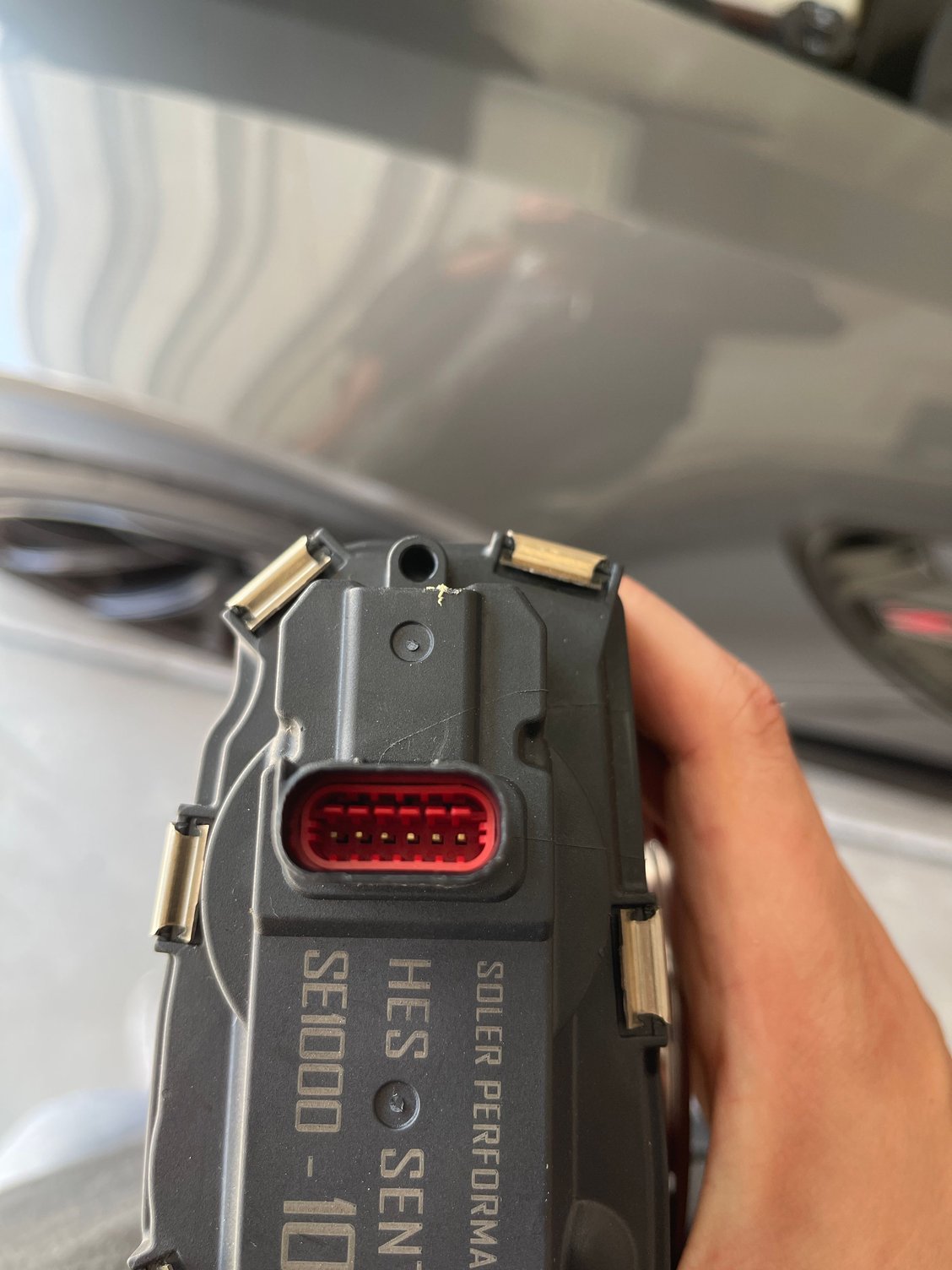

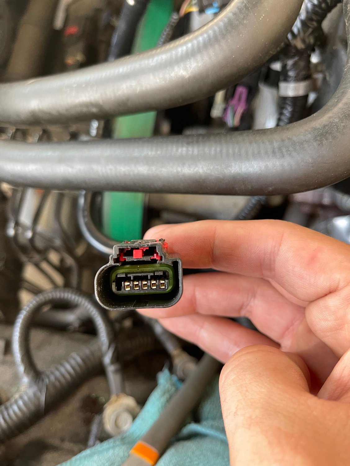

Took the throttle body off this morning & noticed the connector only has 5 pins whereas the throttle body has 6. Is this normal or could that be causing my issue?

Pin 6 is "Not Occupied".
