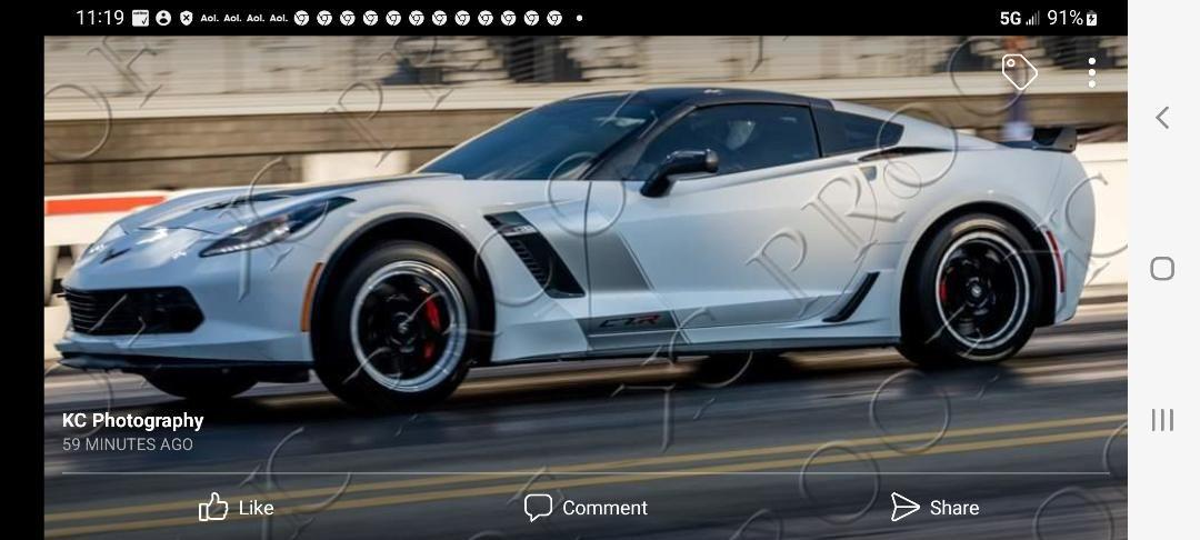

I'm very happy with my Kooks headers. I've put them on a C6 GS and my 16 Z06. If I remember they were both 1 7/8ths. On my Z06 2"s would probably give a few more ponies, but not that much. I haven't been to a 1/4-mile track in some time, but it should run high 8's in the 1/4.
