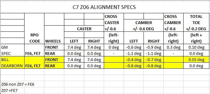

I've read almost all of them. My frustration was the inability to come out with some actual values to give the alignment tech. There was a thread where @Bill Dearborn did provide the stock specs with a suggested adjustment to minimize tire wear. I believe I have captured the numbers in the attached image. I was going to add the DSC specs to my table, but they use mm and not degrees, making the comparison useless. A couple of thoughts:
Per Bill, the factory specs aren't really that aggressive. We do often see owners who are surprised to see their tires worn to the chord at approx 10K miles. Do you guys think that's just how it is, or were those cars an anomaly, and they came from the factory with a bad alignment?
If those examples are an anomaly, I'm thinking I'll just go with the factory specs (with a much tighter +/-). With the ridiculously low amount of miles I put on my car, maybe it won't be a problem.
Goals: I do like to carve up the twisty backroads, although I don't plan to track my car. I do plan to ask the locals who they recommend for C7 alignment, along with the rear caster requirement.
What is a reasonable (+/-) to ask the tech to achieve?

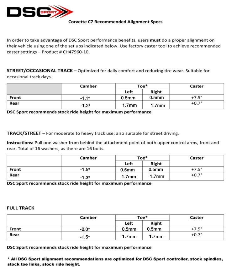

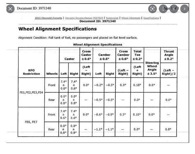

Thanks Slade. This document states degrees for toe?

afyer cording tires on my first vette, I've totally sworn off gm stock alignment. DSX says 0.5mm. 0.5mm is like 0.02 in.

Slade, is this the one?

yes, I've run 0 in on front and toe in 0.05 in rear. Toe is by far huge factor in wear, been running -1.2 camber and near stock caster.
The reason toe is measured in degrees is because it is the most accurate way of measuring toe. When using distance measurements such as mm or fractions of inches the measurement changes with the diameter of the wheel. A 1/32 toe setting on a 20 inch wheel doesn't provide the same angle as a 1/32 setting does on a 16 inch wheel. When measuring the toe angle of a wheel using degrees it doesn't matter whether the wheel has a diameter of 1 foot or 20 ft. The angle will always be the same number of degrees.
I know it is hard to measure degrees if you don't have an alignment machine, however, there are conversion formulas and charts that let you convert between the two methods of measurement. For example:
A key item to remember is wheel diameter is actually the two points where you make your measurement. If that is on the edge of the rim or outside of the tire diameter. When using a string method to measure toe most of the time you will be measuring to the wheel edge. However, if you are using toe plates with tape measures stretched between them you now have a wider distance (maybe 24 inches) between the two measurement points and you need to recalculate for that change.
Bill

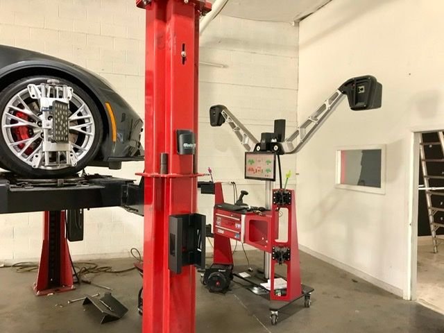

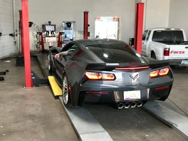

Here were my final alignment specs that I had done right after I had my Z06 lowered.
So did they have the tools to measure the rear caster and did they set it if they did? The alignment machine can't measure rear caster since the alignment heads aren't fastened to the knuckle under the car.
Bill
Yes. Forza here in Phoenix is one of the best and they knew all about the rear caster. Let me be out there with them when they set it and explained what they were doing. Is sad how many people / shops are unaware of this adjustment.
