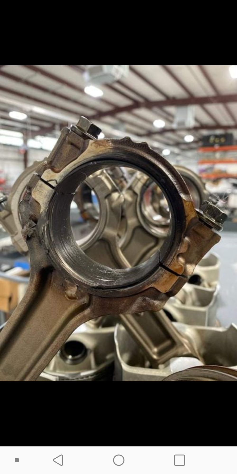

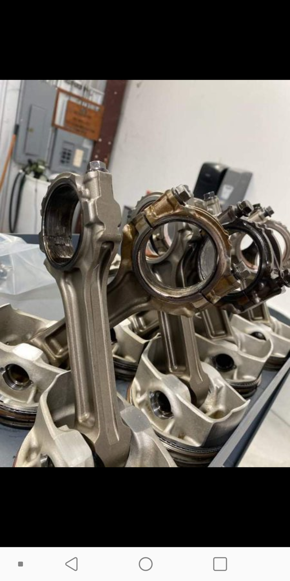

That's exactly what happened in my 16 Z06 when the reciprocating assembly seized-up. Hope that's not what happened to yours. Mine was so bad we couldn't even save the block.
