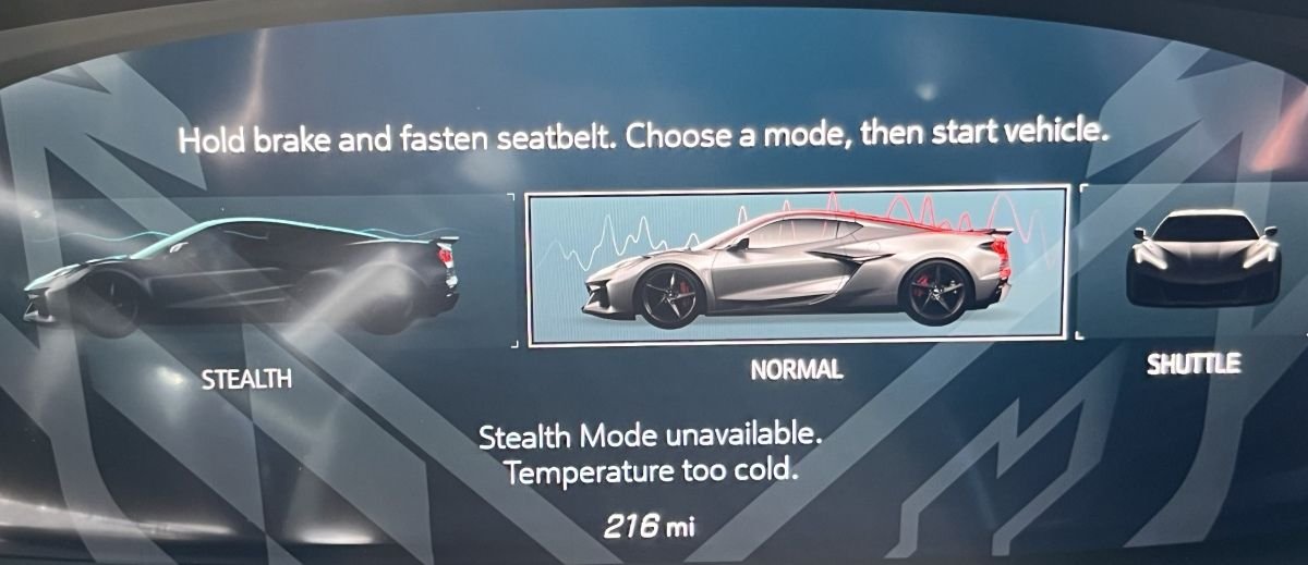

I have 1400 kms on mine now. My Stealth mode never works from a cold start up even in a heated garage @ 17C or 63F. It says Stealth mode not available. What is everyone's experience with this. GM stated Stealth doesn't work in cold temps 10C but 17C is above that threshold. The Hybrid battery is 3/4 charged in all cases.
I would expect Stealth Mode to work for you under these conditions. It's the temperature sensor that needs to be at least 50º F. Are you saying that when you start the car normally, the temperature in the Infotainment screen reads 63?

Yes 63F

I have another thought. Is this the screen you get? I think not, since this gives temperature as the reason Stealth Mode is unavailable. Does it say something else in place of that statement at the bottom?
Also, do you have your seatbelt buckled?
I haven't tested it, but it's stated above and in the Owner's Manual sounding like that's required.

The seatbelt is a must to be able to get into the Stealth mode.
It just says Stealth mode unavailable.
Good point - I will check on the seat belt routine as I can't say for sure if it was buckled.
Thanks - seems a bit odd that I can drive away without a seat belt in normal or shuttle mode.
