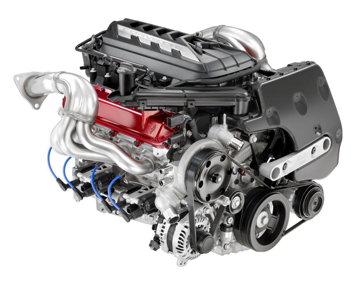

Agreed! I wonder how hard relocating the dry sump and oil filler would be. A blower would need that to get started due to packaging of that piece up front Looks kinda cheesy too. Not a fan of the plastic.

Originally Posted by NICK YOSKIN
I highly doubt it..I've seen this car up close apart and its right up against the firewall. Moving the the dry sump tank is a large liability and will not be easy. Least path of resistance will be turbos for sure.
After looking at this hi res pic, I have to pretty much agree that a PD blower is not going to be easy at all.
