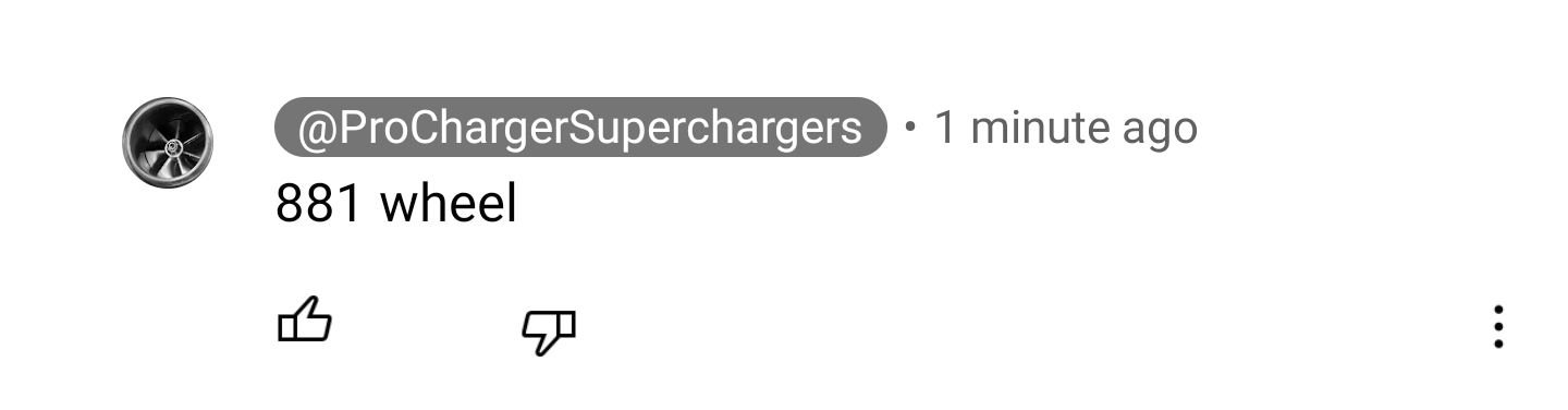

Old Jun 16, 2023 | 12:18 PM
OkieVette84's Avatar
OkieVette84
Joined: Apr 2020
Posts: 406
Likes: 303
From: Oklahoma
Originally Posted by degfu
And you are bang on with your math, he said about 815 WHP on their dyno.
