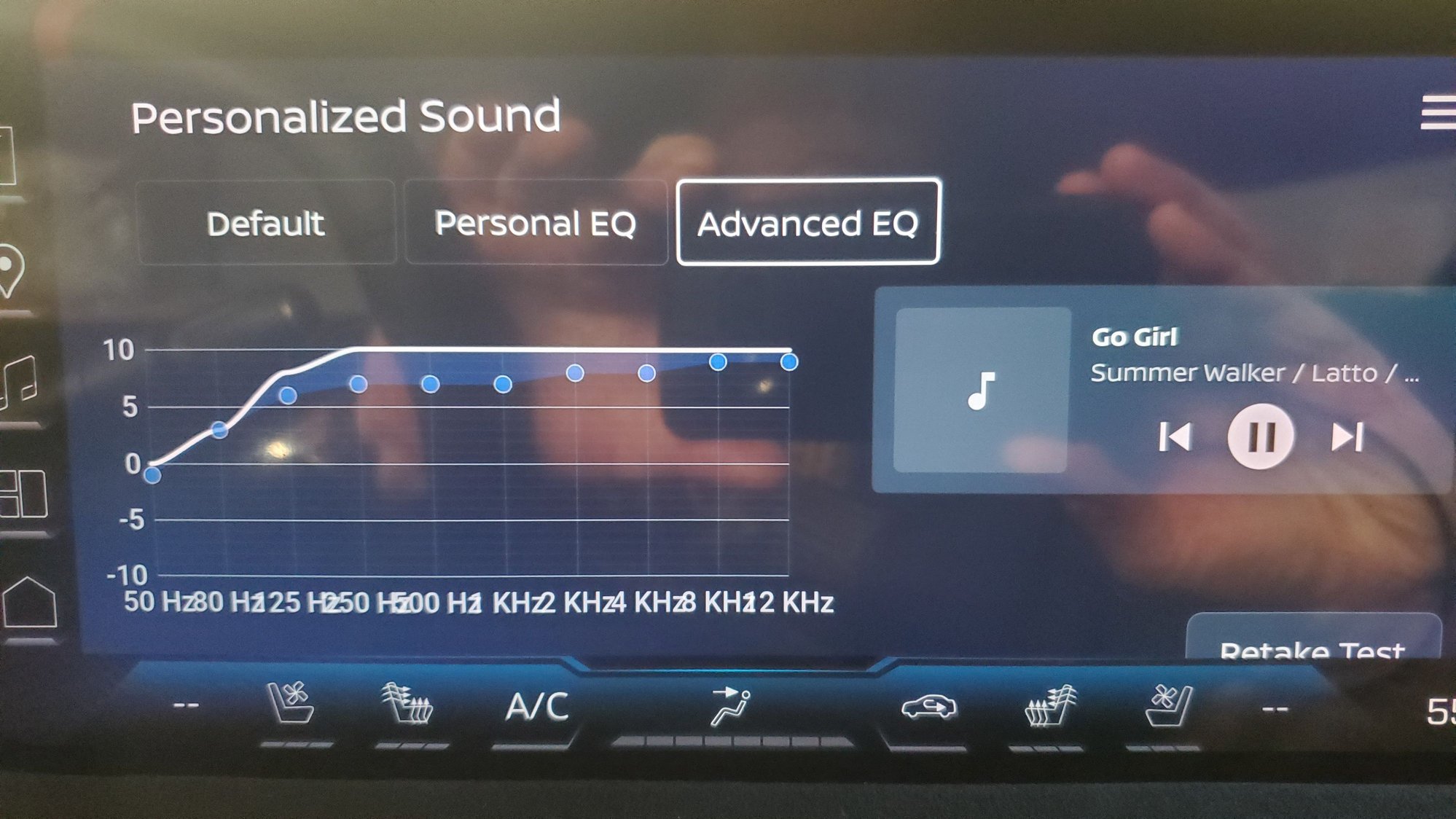

There are two "modes". In one mode, it slowly increase the level of a tone associated with a equalizer frequency, and you hit a button when you start to hear it. It uses your ear as a level detector.
The other mode is a normal graphic equalizer where you manually set the band gain.

Originally Posted by C8ZZZ
This app works well for me in the C8 infotainment system (2026 3LT with sueded interior - may impact some dampening/dispersion). The windows were up during the calibration. I used a calibrated microphone and spectrum analyzer.
The Personal EQ method does not put out pure sine waves and it relies on your "ears" for calibration. I tried this method as a test using a spectrum analyzer/microphone instead of my ears with a trigger at a certain dB. One issue is this starts at a low frequency with the EQ at 0 dB which can create a problem if the bass is boomy or you need more high end boost.
Then, I used the advanced EQ with the sliders and white and pink noise usb wav files for calibration. Here are my results if you want to try this as a starting point. The dots are my settings; the curve is from the Personal EQ run.
I used several different types of music to test my settings, and I am very happy.

Originally Posted by Grand_Wish
How do you manually adjust it to match your settings? The screen doesn't respond to my finger if I try to drag the graph. Thanks!
The solid line is from using the Personal EQ test. To manually move the dots, select Advanced EQ, and then you can slide each dot to gain or cur each frequency band. In Advanced EQ, there is not line connecting the dots. My current curve (set of dots) is about 5dB lower everywhere so I have headroom to the max gain.

From: Raleigh, NC
I may have to reload my app. I do not see those dots on my screen
