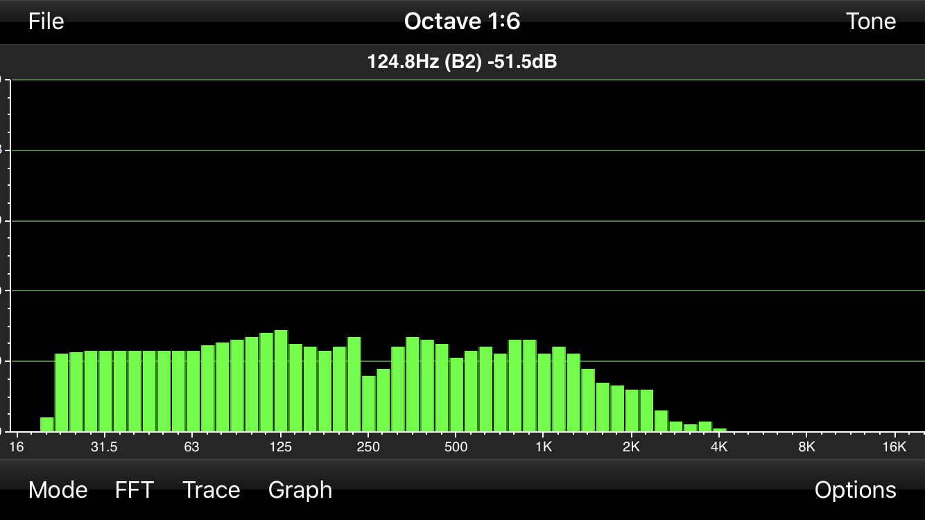

I will use my audio calibration microphone and software to take measurements before and after, so folks can see the impact this has.

As a point of reference, here are the before and after measurements from my 2005 GTO:
Before measurement:
After CLD + CCF + MLV measurement:
This completely transformed the driving experience in the GTO and I am hoping I can achieve the same reqult in the C8

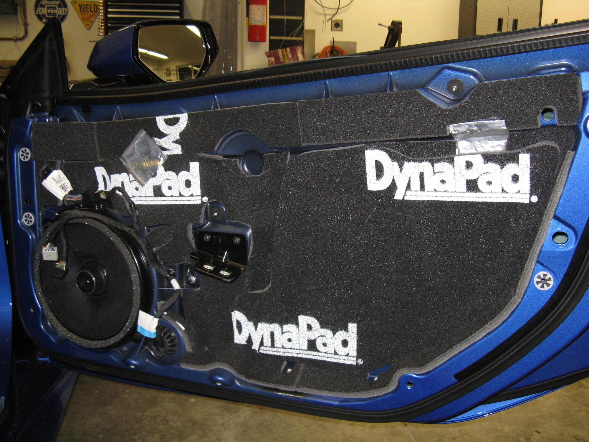

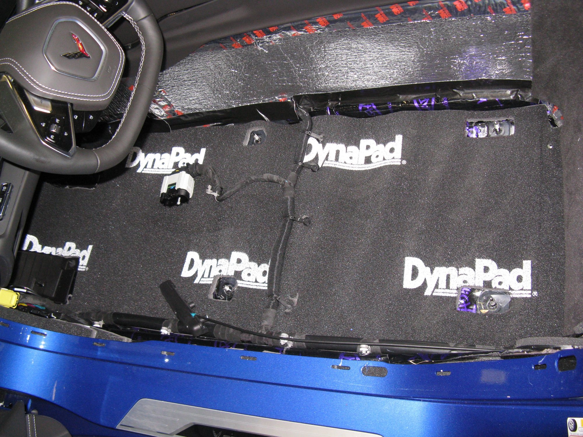

I started out using a commercially available sound deadening kit for the C8, however I was disappointed with the results only showing a 1 Db reduction in road noise.

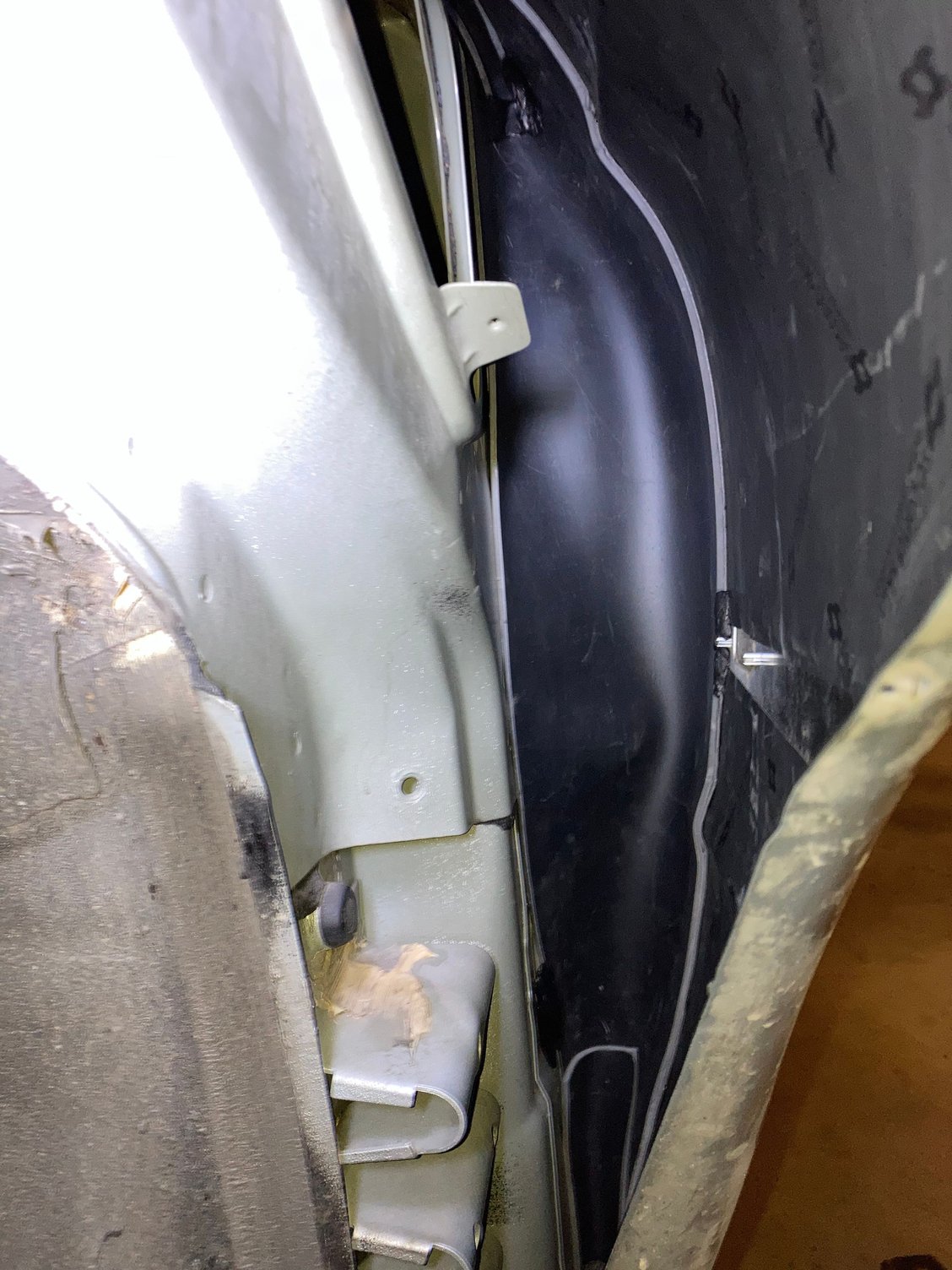

Next, I removed the wheelhouse liners and added Dyna-liner (closed cell foam) to the back sides of the wheelhouse liners. The Db results did not show a noticeable reduction in tire noise. After reading the OP's post, in hindsight this probably not the best product to use for this particular location.
For the next step I removed foil backed "bubble wrap" type of insulation that came with the sound deadening kit from the floors and replaced it with Dyna-pad. Dyna-pad is a multi-layer product that is fairly thick and has a dense rubber material in the middle. The Dyna-pad did show a Db reading of about 87-88 on the same stretch of freeway @ 70MPH

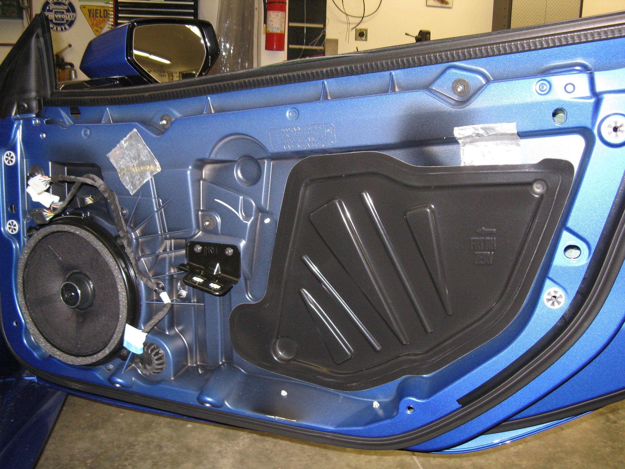

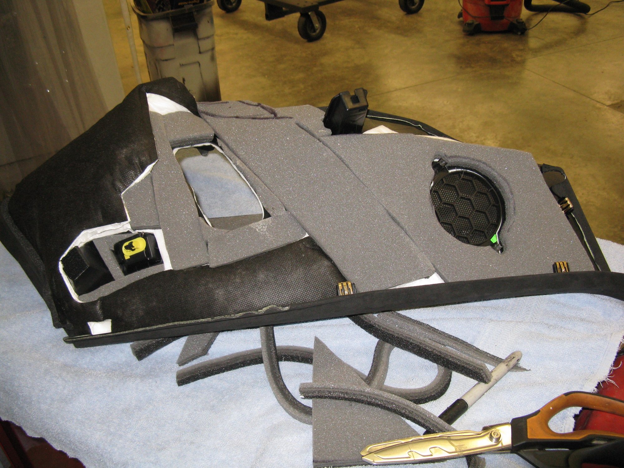

I decided to work on the doors next and to my surprise there is virtually no sound deadening in the doors, other than some light insulation on the back side of the interior door panel. So, I lined the inner door structure with Dyna-pad. This reduced the road noise to about 86-87 Db. Interestingly enough after doing the doors the sound system does sound better though
I'm not a sound engineer and was trying products based off of my limited experience/research. I was able to reduce the road noise somewhat, that being said I was hoping for better results and will be interested to see how much success Stoopalini has.

Nice ... so a few thoughts on your project.
First, note that a drop of 3dB is not insignificant. 3dB for audio represents a doubling of energy. For example, if you have an amplifier and a speaker playing a sound at 87dB loudness, and you want to increase it to 90dB loudness ... you need to double the amplifier's power output.
That said, how we perceive sound is different ... 10dB is generally accepted as the level in which humans perceive sound levels as being double loud. So while going from 87dB to 90dB takes double the energy, it's not until 97 dB that a person would perceive the loudness as being doubled.
The material you used is essentially a layer of MLV sandwiched between two layers of CCF. They try to market the CCF as sound absorbing (which CCF does do), but it is way too thin to have any real effect for this purpose. The CCF is really acting as a decoupler here, just like the lead based product I plan to use. The Dynapad website states the MLV layer is 1lb per sq/ft, which is on par with industry standards for standard MLV. So it should be pretty effective at blocking sound, but only if you have 100% coverage with no gaps. Any seams need to be sealed to really be effective. Like your doors, that really should have been a single piece of the material, draped from top to bottom. If you needed to use separate pieces, then you really should seal the separate pieces together to be effective. Having the seams not sealed is like my analogy above about te lawn mower ... if the window is closed and sealed, but then you just barely crack the window the slightest amount, the lawnmower sound will penetrate the room immediately.
I used MLV on my inner door skins of the GTO ... this is how I draped it. The C8 door cards may not allow this with thick MLV though, due to tight tolerances, not sure. This is one reason I'm going with the ResoNix lead product instead, because it is so thin.
In that vehicle, I also put MLV at the trailing edge of the front fender, to stop tire noise from entering the leading door edge. Here's a pic from the front wheel well, looking back toward the door. CLD on the fender (right side of pic) to stop if from resonating, and then MLV to stop airborne noise from the tire entering the door.

I like the idea of the ResoNix product for the doors. Not sure if you have pulled the door panels off of your car yet, but there are a lot of irregular shapes to work around and in some cases the clearance between the interior door panel and door frame is very tight. (upper tweeter speaker) The fact that ResoNix is moldable will be helpful in this application.
