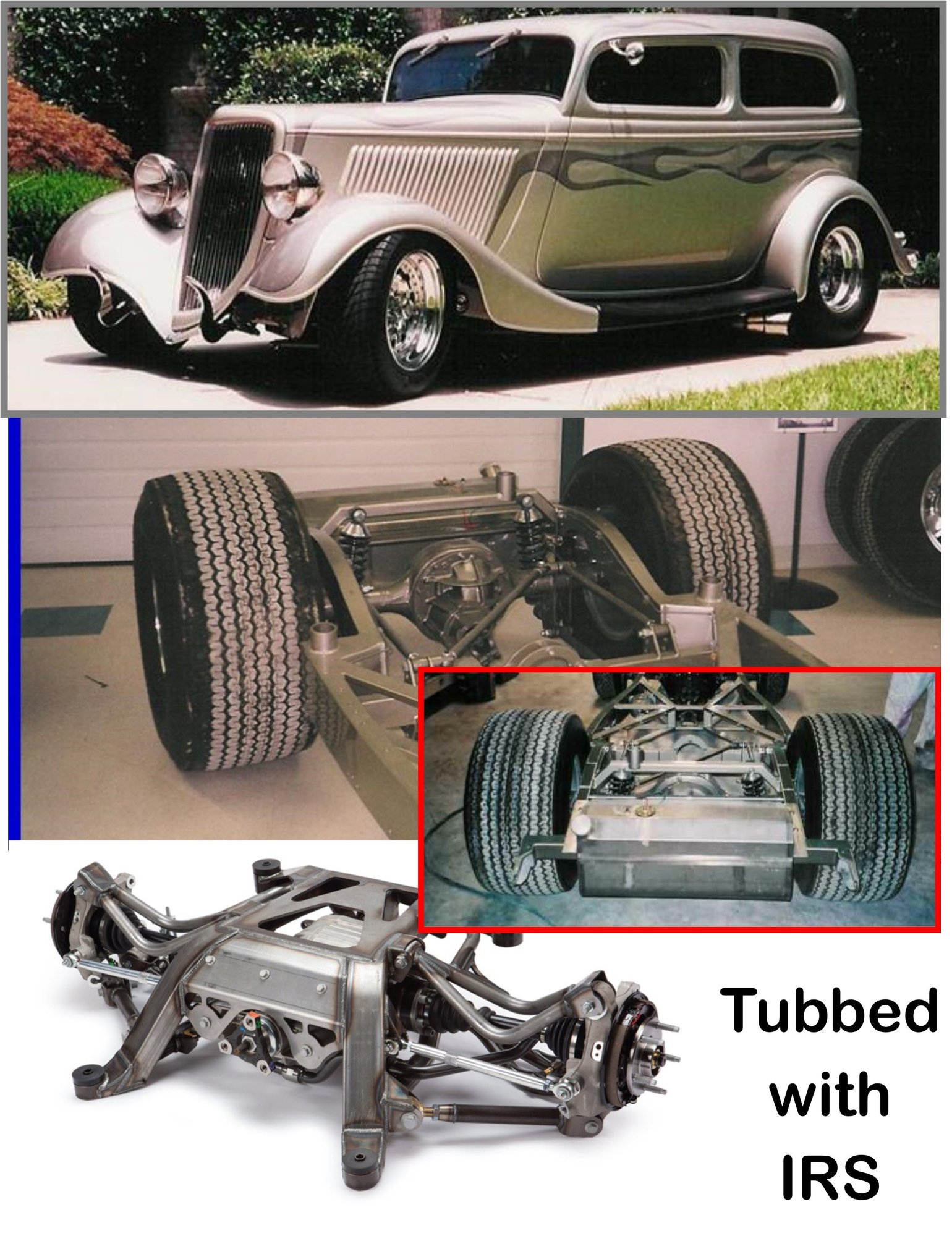

There are other ways to fit wider tires, a tubbed chassis or foolish (IMO) looking spats! My ProStreet Rod uses a Tubbed chassis to fit the 420 section width (16.5 inch) wide tires in the original width fenders. Yep it can de done with a transaxle and IRS!

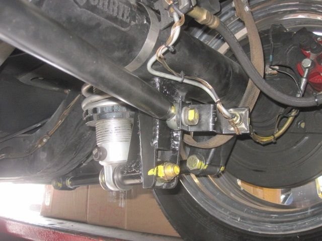

Many mid engine cars have 305's as did the C8 in Germany, however the current Ford GT with it's 3.6 Liter V6 has 315s and both the old Enzo and la Ferrari have 345s!

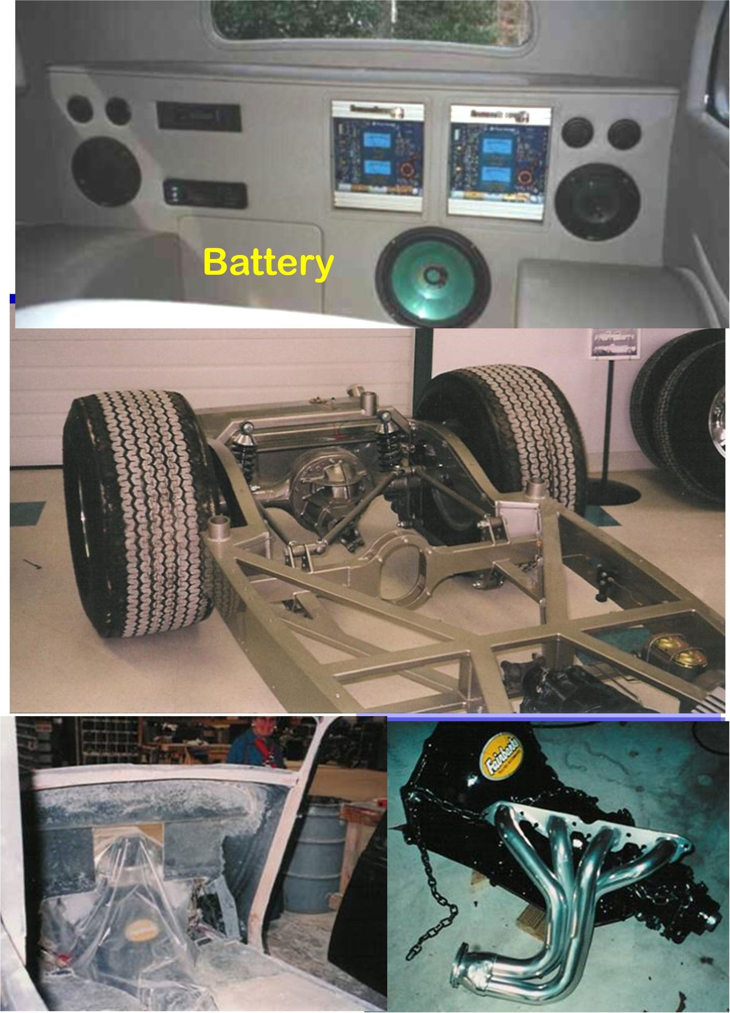

RE my ProStreet Rod; it has 53% of it's 3000 pounds on the rear wheels! First the engine is set back (see pic below of firewall and floor cut during construction.) That TCI ridged Chassis has a heavy Currie 9" Ford rear as is the very ridged 4 bar link adjustable rear suspension and chassis. Adjustable coil overs are set for even tire load under launch. Lots of heavy "stuff" in the rear interior as no room for a rear seat!
Perhaps the biggest reason for being traction limited is the ~600 ft-lbs of torque from that 502 cid BB with long tube Sanderson headers, 850 Holley double pumper and straight thought Borlas in 3 inch pipes help. The race prepped TH400 with high stall converter and rear gears give optimum launch. Yep slicks would get more traction but the 420 equivalent Mickey Thompson Sportsman tires using tubes and low pressure are good enough for me!
Bet the Z06 or ZR1 version of the C8 will have wider tires!

What's that diagonal link on top? Be careful with your design of a Panhard or Track Rod. Must be behind the axle mounted lateral and horizontal and designed with a spike load of twice the load at the rear tires. This is my design for a 4 link 500hp 60 Vette. Watch end float of drive shaft into gearbox. At least 1/2" Design for pinion and output shaft to be the same angle. Drive shaft no more than 3' standing and 6' max. Move that axle all over the place while checking everything before installing coil/overs. Your life depends on your design.

What's that diagonal link on top? Be careful with your design of a Panhard or sway bar. Must be behind the axle mounted lateral and horizontal and designed with a spike load of twice the load at the rear tires. This is my design for a 4 link 500hp 60 Vette. Watch end float of drive shaft into gearbox. At least 1/2" Design for pinion and output shaft to be the same angle. Drive shaft no more than 3' standing and 6' max. Move that axle all over the place while checking everything before installing coil/overs. Your life depends on your design.
A lot of the 1000+ hours I have in the ProStreet Rod are my designs BUT that Chassis design is TCI's in Ontario CA! Visited them before I bought it! They have built many thousands of tubbed street rods! That is their arrangement for a Panhard rod as with a tubbed chassis not much room. It does have a sway bar front and rear. The front is conventional with spherical ball heim joints. The rear bar goes through referenced welded tubes in the boxed frame with plastic bushings. The ends of the bar are splined and fit matching splined aluminum rods and spherical heim joints attached to the rear. Has handled fine for 18 years. That is in a straight line, which it is designed it to do best! It's not a canyon carver! All drive shaft/pinion angels are fine, lots of adjustment to get them right. Note the chassis member that doubles as a driveshaft loop just in case! It is the weak link!
The handling issues are at launch. It has posi but if one of those tires loses traction due to the pavement it makes a hard turn! You get about 1/2 second to back off and steer! A lot more exciting than a launch in the Grand Sport (and quicker!)

Sorry, I meant Track rod and not sway bar. I use the term ARB for sway bar and Panhard bar for track rod. The Panhard rod in the TCIs design above can't possibly work and is very very dangerous as it is mounted. Please change it. The dude with the 60 Vette bought an after market kit. I can't mention the name, but thousands have been sold.The company should not be in business. Most of the after market producers ensure job security for lawyers. Post a picture of the back of the axle and frame with gas tank removed. I'll show you what MUST be done.

Appreciate your passion but TCI is one of the best street rod chassis builders in the country. Not the cheapest. Before I purchased their product I visited their facility, now 32,000 square feet, and talked with the GM as I toured!
There are a number of ways to build a quality rear suspension (by the way my front suspension is double wishbone adjustable coilovers with sway bar and have disk brakes in all 4 corners.
Yep would be perfect to have a Watt's linkage to keep the rear perfectly centered (better than any arrangement of a single Panhard rod BUT not much room in a tubbed chassis!
Have a number of text books on chassis design and use Chris Alston's book on setting up an adjustable 4 bar link rear. Bit of math with instant center calculations, identifying the CG etc. But then I like math!
Below is from the TCI (Total Cost Involved.) website. They have built thousands of street rod chassis and mine has run just fine for 18 years! In fact they were a help in supplying hi res pics for the book I wrote for CarTech Pro series in 2015 (on advanced welding.) Great folks, great products.
"In 1974, Total Cost Involved Engineering began to set the standard for quality when we built one of the first Model ‘A’ reproduction frame. It took the Classic Car restoration market by storm. Today, we own 32,000 square foot manufacturing facility, where we deliver a broad mix of products serving Street Rodders, Hot Rodders, Pickups and Muscle Car enthusiasts nationwide. We’ve earned numerous design awards, including the coveted ‘Manufacturer of the Year’ Award from SEMA-SRMA. Through a well-trained team of experienced engineers and machinists, we’re still setting the highest standard for reliability and performance, as we’ve done now since 1974. We promise to achieve this standard in all the products we deliver to you. We take quality very seriously which is why we offer a 6 Year/60,000 Mile warranty on wear & tear items and a lifetime warranty on any part we manufacture in house. Quality doesn’t cost, it pays."
PS: Know all about "lawyers for injured people!" I consult as an expert witness (for insurance companies etc!) The last case paid for my Grand Sport and a current "wrongful death case" will pay for my C8!

These are 3 of the many pics from my CarTech Book. The painted one is from my chassis that was all TIG welded. The two of an unpainted chassis are pics TCI supplied for my 2015 CarTech book on advanced welding processes. They now also use Pulsed MIG welding. You can see the excellent quality of their work. Note, lots of holes for mounting the 4 bar link rear suspension arms so the instant center controlling chassis dynamics at launch can be placed wherever you like!
