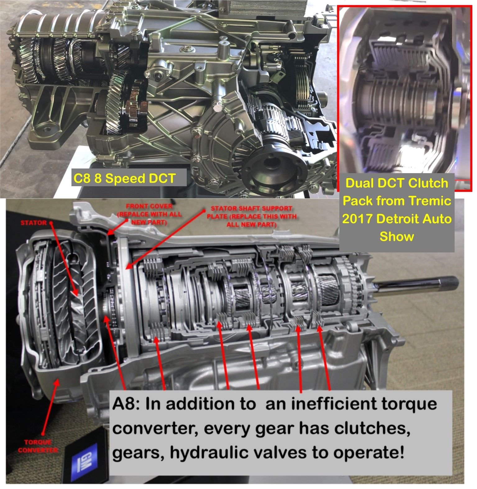

Originally Posted by Phil1098
Not sure why everyone is trying to apply solutions for an automatic to a DCT. A DCT is not an automatic, it's a manual that will shift for you. There is no torque converter or a ton of other components in an automatic. I have already told my wife there will be a learning curve on the feel and how a DCT works, it will not have the same feel as an automatic because it isn't one.
Folks are comparing the issues with an A8, mostly related to the torque converter. As you say big difference between a "slushbox" and DCT!
