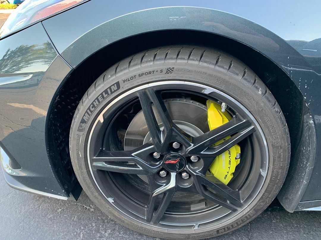

Originally Posted by bhvrdr
Well then its not the ps4s on the pre production cars. The ps4s is not a runflat. The all season ps as4 is
Here you go, a Z51 with PS4 ZP (look to the right of the "Pilot Sport 4S" (in the little oblong circle...."ZP")
