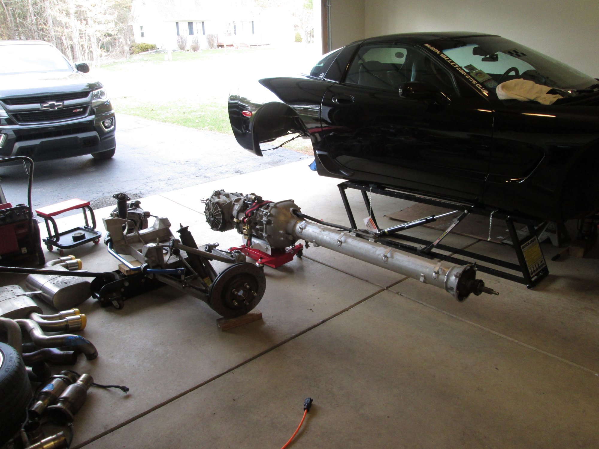

Originally Posted by dsevo
Quickjack 5000 has been a fantastic purchase for me. Weight distribution isn't a factor for the Porsche and I can't imagine the C8 would be an issue.
yes I agree, I have the 5000 also, would be great if someone could post up the dimension or distance between the frame lifting points of the C8...
doing clutch changes on my C5, this lift is rock solid with the trans/differential/torque tube removed.
