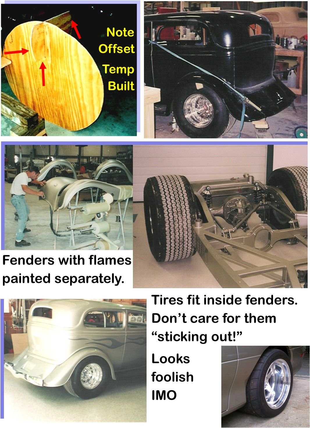

Originally Posted by AzDave47
I went thru that with Enkie wheels on my '83 Mazda 626 Touring sedan. Tire Rack said they would fit. I mounted them, drove 5-6 miles with some corners and bumps, unacceptable rubbing. I called Tire Rack, "our guy in (state)" said he had no problems. At least I had no problem returning them. Good luck.
Now I am usually conservative on "going wider" as I do road course events that will generate rubbing. I have seen some fitments where car show guys drive easy on the street and have no problems with fitments that I know would tear up the tires or fender liners on my car driven hard.
Yep, recall doing that when I went Plus 1 wheels with Pirelli P7s on the last car I bought when I lived in CT. Just had to hammer the metal fender lip and bend the support bracket for the performance exhaust I had installed. That worked. Tough to get composite fender lips to bend!
For my first new car, a 1967, did a lot of measuring to go Plus 1 with Low Profile tires (when Plus 1 and Low Profile were not words used. Had to carefully review specs of those Continental 714 radials. Lots more effort to get the 16.5 section width (420 metric) Mickey Thomson's to fit the ProStreet Rod I built 20 years ago. Those tires sit inside the fenders. IMO tires sticking out look foolish.
Made wood template with offset sections so I could fit the largest tires, 420 metric section thickness, make the Z06 345's look small! With fenders painted separately all had to fit well when assembled. All clears but not by much and turning radius is limited by front's hitting fenders! No big deal as it mostly goes to shows.!
