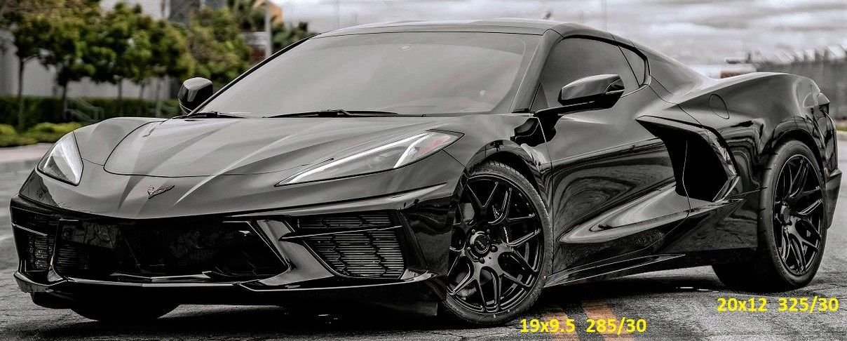

We test fit 285's on the front, and 325's rear on my car last week at MRR Wheels.
Specs in the link:
https://www.corvetteforum.com/forums...t-options.html
