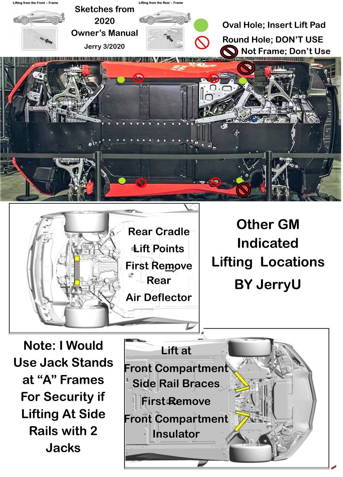

Currently I'm able to lift the complete front or rear end of my C4 by locating a floor jack in the center of the front or rear. I'm guessing this won't be possible with the C8 because: 1) I don't know of any good central lift points and 2) even if there are, belly pans would have to be removed to access them and how would you get those off while the car is still on the ground. Am I missing something here or is that just not going to be possible?
Originally Posted by Broken Halo
I don't have a Quick Jack and didn't know if THAT was my only alternative or not.
No way could I get even my long reach jack under my C7 centers. My MO is to use Jack Pads and two jacks from the sides and then jack stands. BUT as you note, to use jack stands on a inside frame would require removal of the aero panels. My plan (as soon as I get the C8 home after it arrives at my local Courtesy Delivery Dealer) is to change brake pads (so I don't have to clean the rotors (did that with my current 2017 Grand Sport.)
I'll probably only lift one end at a time and place a jack stand under the exposed "A" frame. Will keep some tension on the jack for security. When I change oil in the C7, this pic shows my MO. I won't use jack stands on both ends of the car so support the rear wheels on Stanchions to get the car level. Below is a pic I made on Jacking the C8.

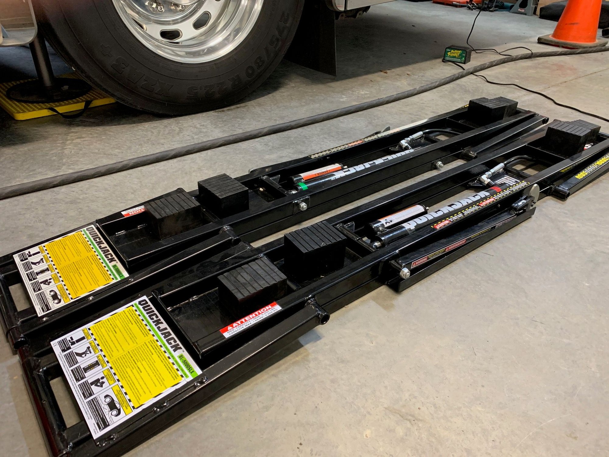

Below is my standard-size, Quickjack BX5000. As you can see it comes with different height lifting blocks and lays flat. There is a lot of room to maneuver the blocks to fit the lifting points. If it doesn't work in one direction you can turn each jack 180º, which I've had to do to lift my C7 vs. our MX5 or 718.
I can't imagine it will interfere with side skirts. The defining issue is here length between the tires.

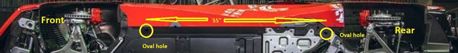

C8 spacing for the lift points (oval shaped holes).
Quick Jack SLX models will reach out 60". EXT models go to 66".

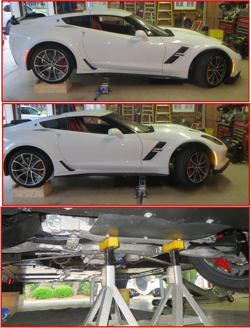

Understand the thought that Quick Jacks are a safe way to jack up the C8 - BUT so are other safe methods!
I plan on installing low dust ceramic pads as soon as I get my C8 Z51 home (as I did on my current Grand Sport.) I'll do one wheel at a time, use a 1 inch high Jack Pad and one of my jacks to remove the wheel. I'll use a Jack Stand under that lower "A" arm for security (keeping some tension on the hydatic jack.)
But the next thing I'll need to lift the car for is installing the "C7 Carbon" Side Skirts I have on order. A Quick Jack would be in the way. I plan on using my two wood stanchions on one side of the car as I need access to the area where the jack pad and jack are located. So, use a Jack Pad and Jack, insert both stanchions under that side front and rear wheel. Very secure. I have normally use the stanchions under the rear tires and jack stands in the front of my C7 to change oil.
Pic of the Install of Full Length Side Skirts On My 2014 Z51. Masking Tape Was Marked on Where to Drill for Rivets

Based on this diagram and 55" information, the regular QuickJack SLX should be fine.

The 55" value is from a post made from an actual measurement made early this year.
The 59.5" measurement is from a photogrammetric measurement (scaling from a photograph).
