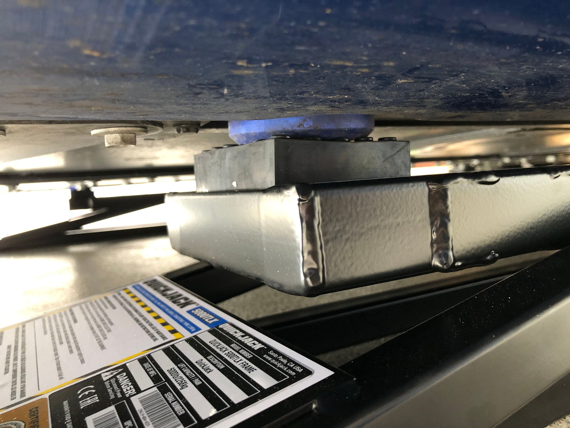

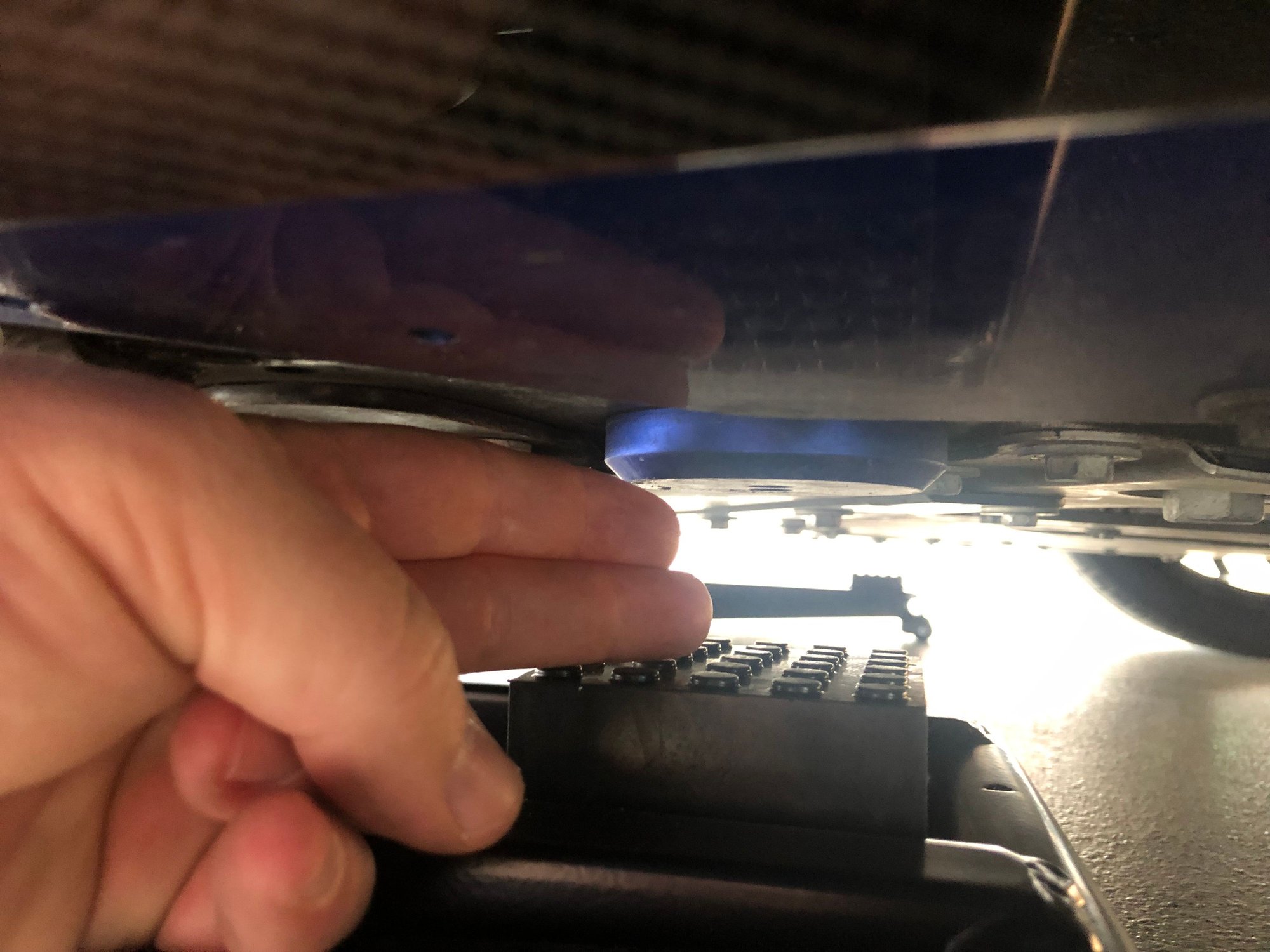

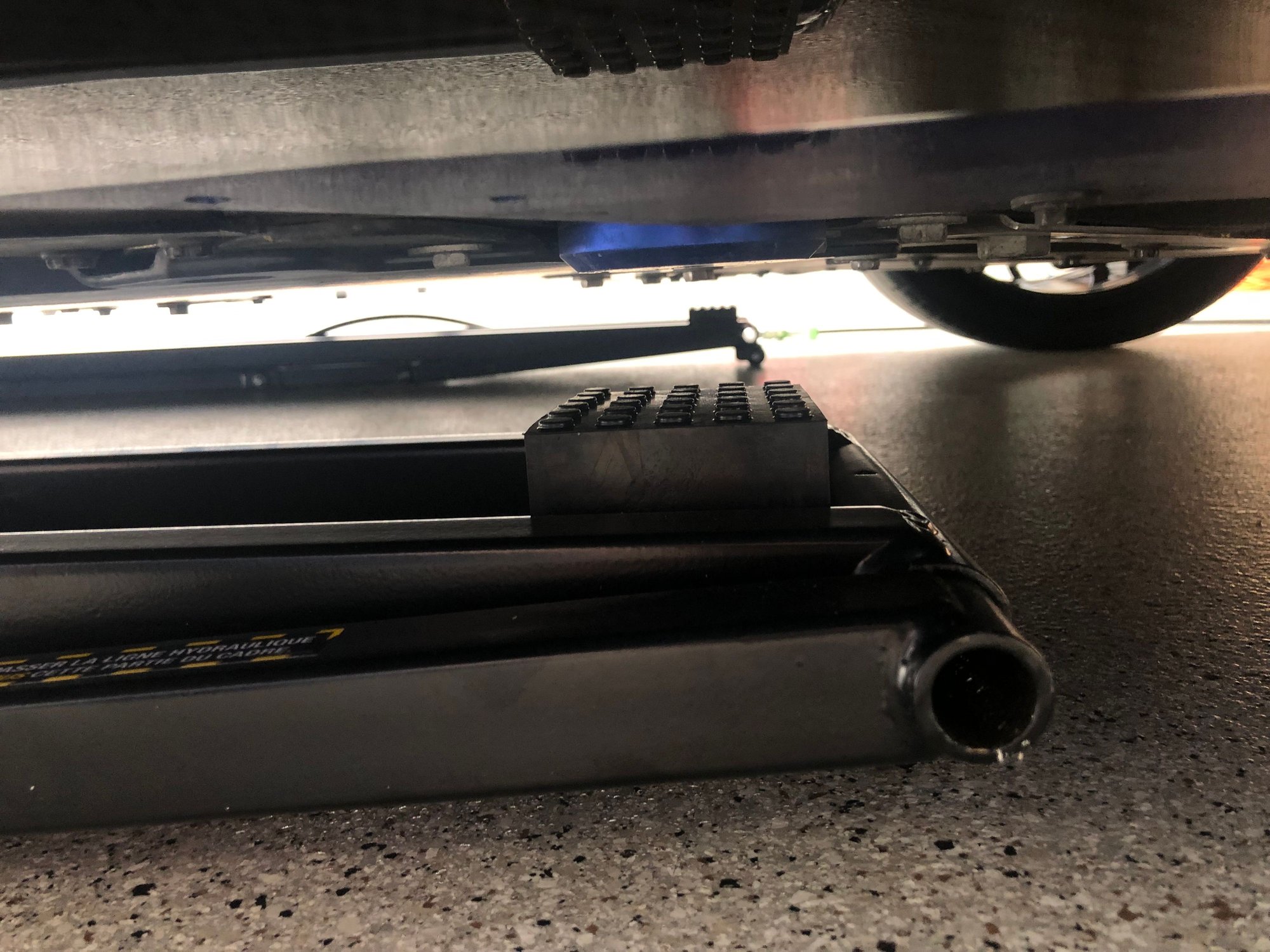

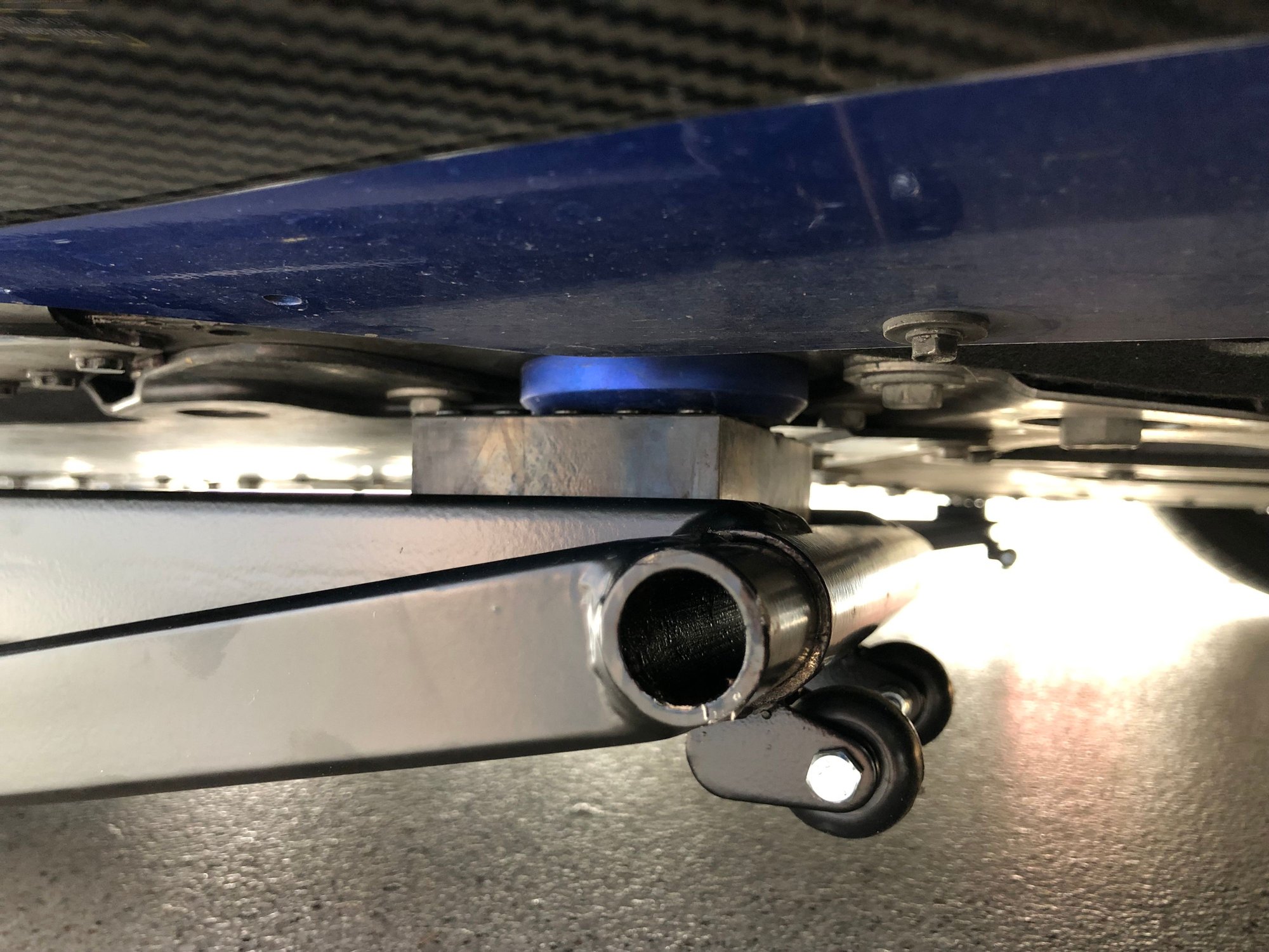

I apologize for the lengthy delay in the response, the 5000 TLX was on back order, but I received it long before the carbon fiber parts that I expected to be here quite a while ago. The parts of finally arrived, and I put the C8 up on the lift for the first time today. I will say that I personally think the 5000 TLX is required the lifting points even on the extended Quickjack are barely long enough for the C8. Please see the photos showing that the Quickjack pucks are all the way at the end of the tray, both front and back and showing the spacing with the Small Quickjack pucks while in the lowered position.
Front
Rear
Amount of room before lifting.
Front contact
Rear contact
First notch of the quickjack

A big thanks to you. I installed the Paragon jack pucks and received the 5000 TLX, but have not yet assembled it. Your post shows this will work.

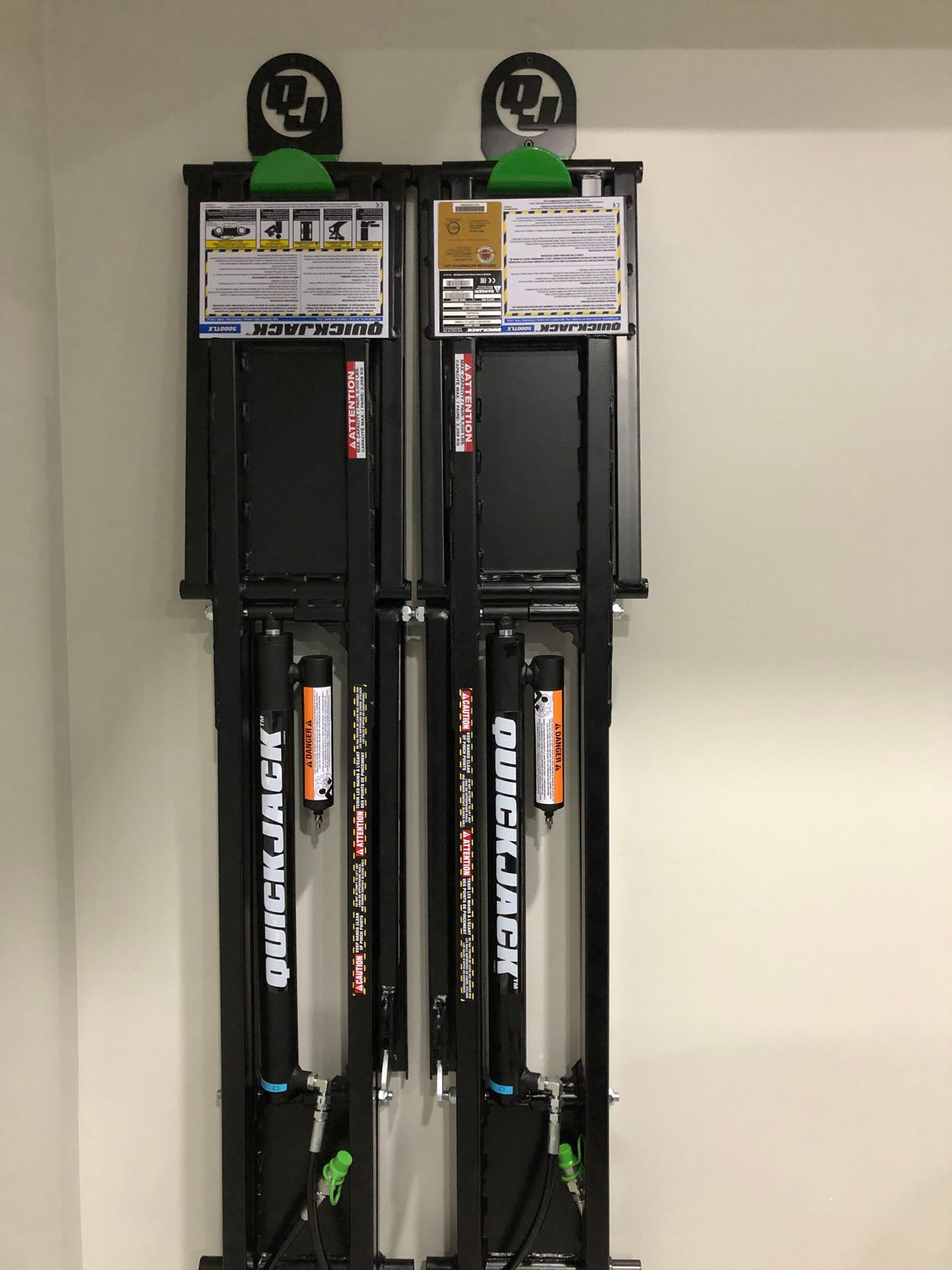

One more thing, the first vehicle I lifted, was my wife’s Mercedes as it needed an oil change. I did that fairly quickly after receiving the Quickjack.

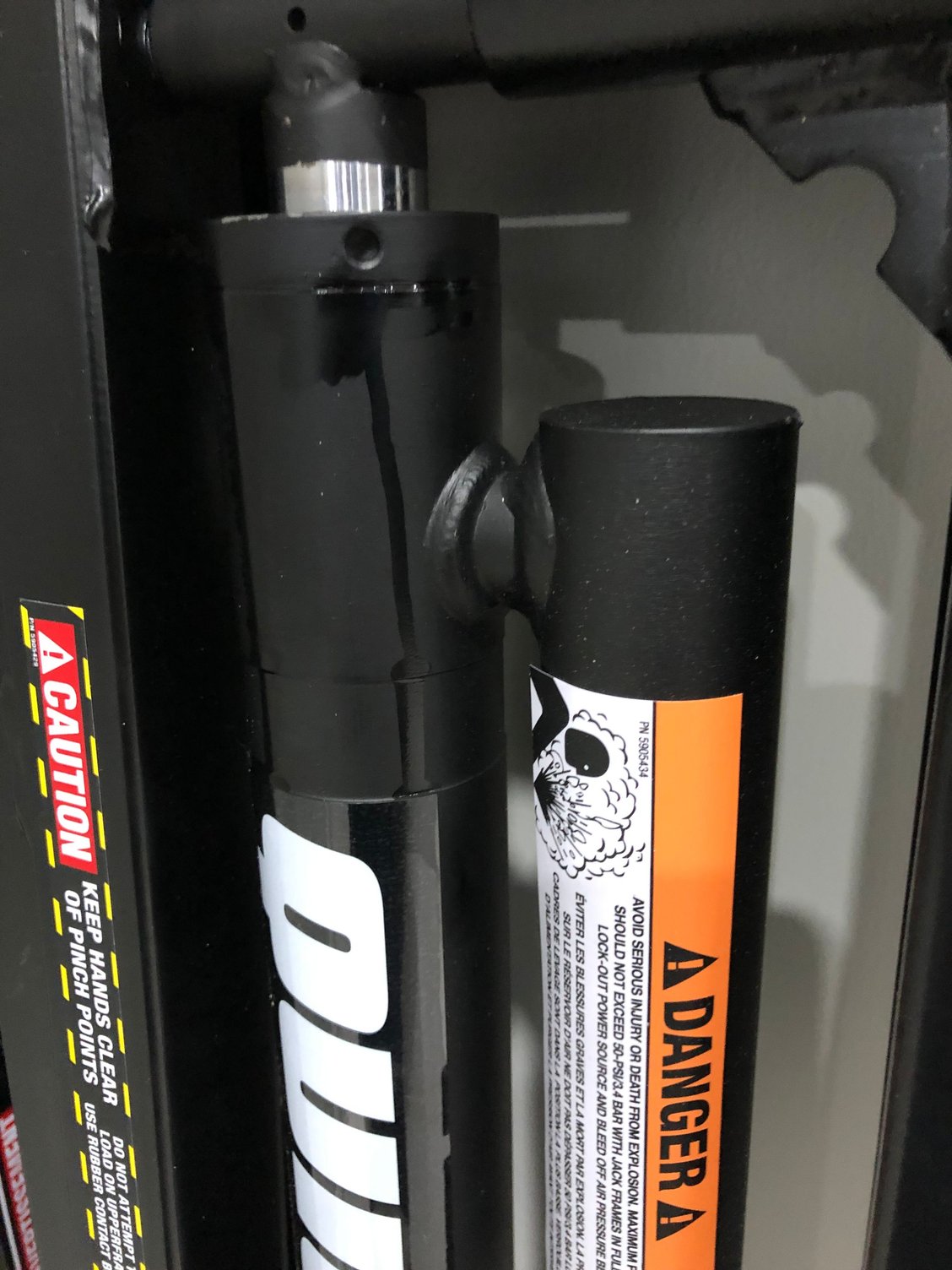

After using the Quickjack, one time and hanging it on the wall hangers as shown below I noticed a leak in one of the cylinders. Please see the attached photo.
I sent this information to Quickjack and they immediately replaced the cylinder. Their customer service was very good, but please be aware that this did happen to me.

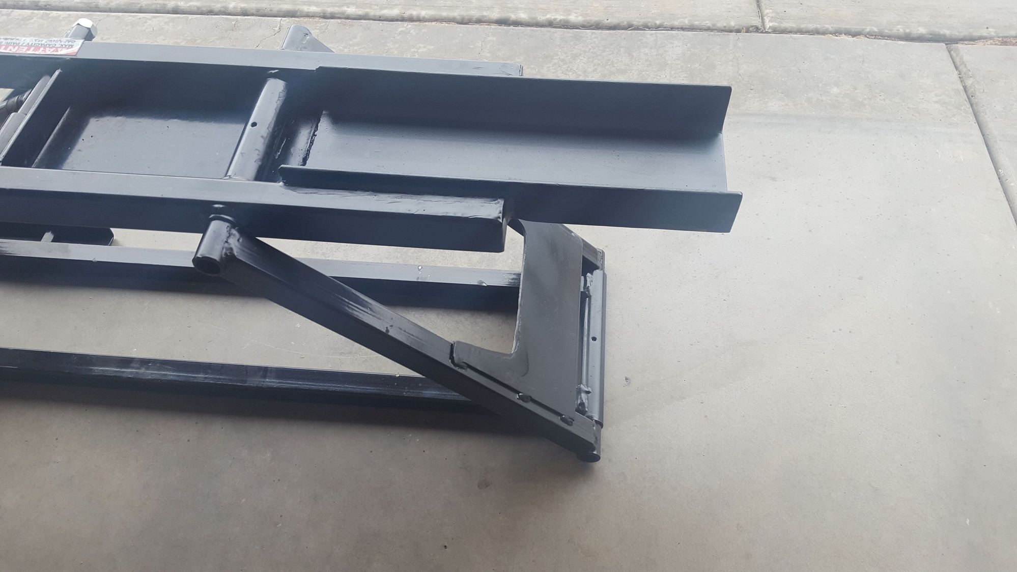

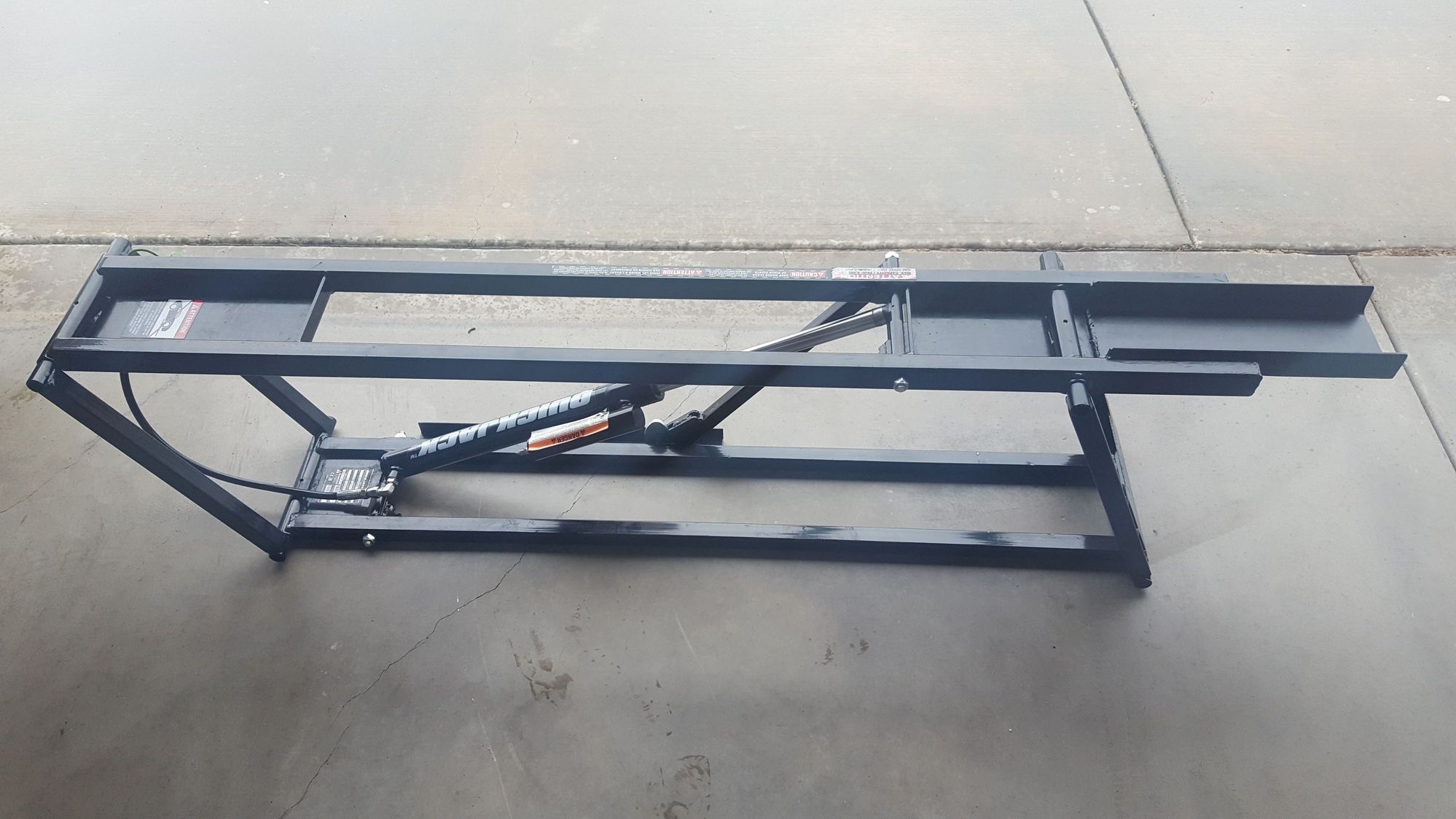

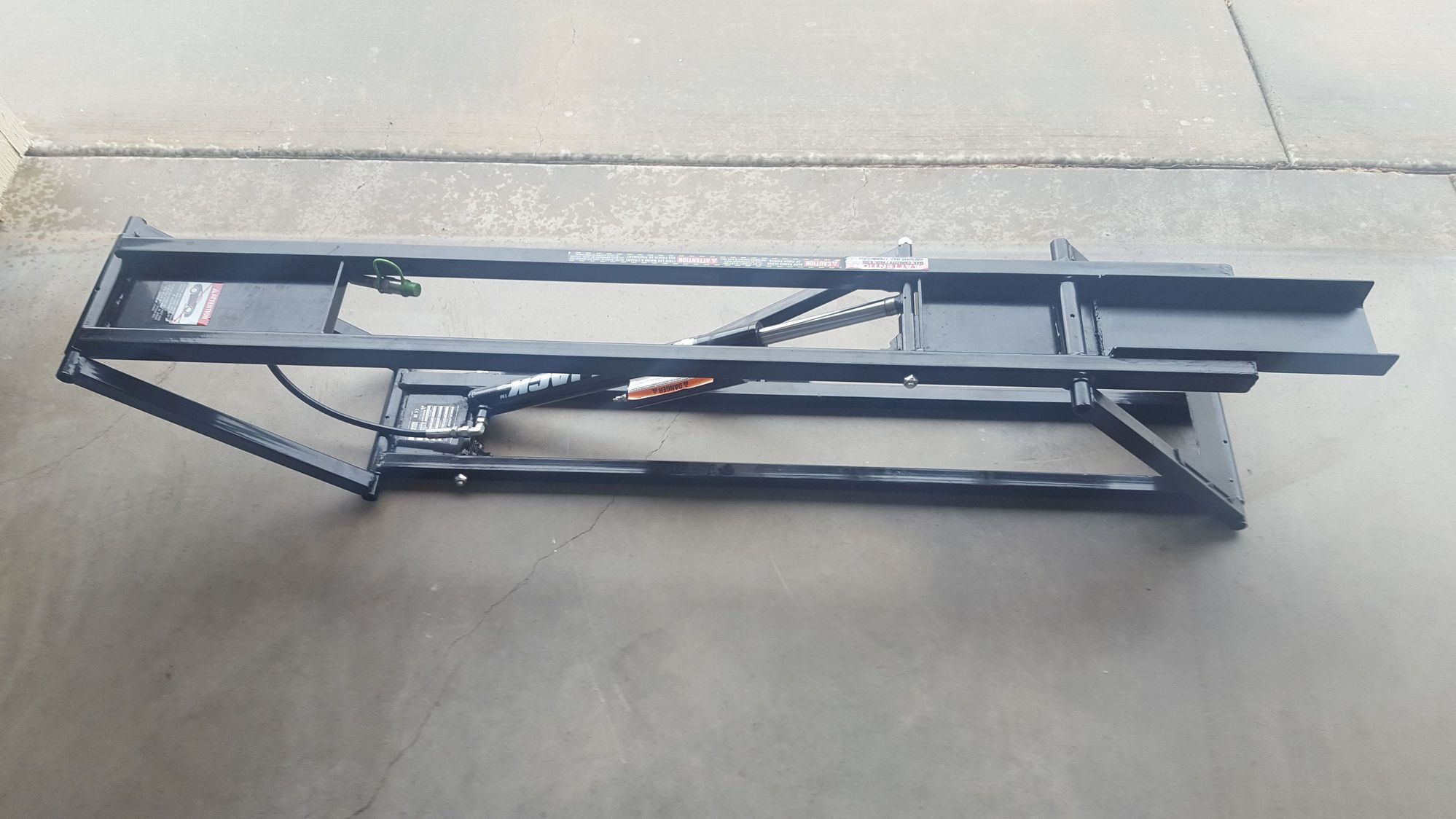

Originally Posted by blackvetterzo6
you need the TLX 5k , it’s like 6” longer
For $200 I had this mod done, 14" long 5" U-channel lengthened the 5000TL by 6", fits the C8Z nicely, much better than a new 5000TXL and trying to flip the 5000TL. Note in picture 2 how the lower brace for the lifting arm was U-cut, which allows the QJ to go low for clearance of the extended U-channel.:
