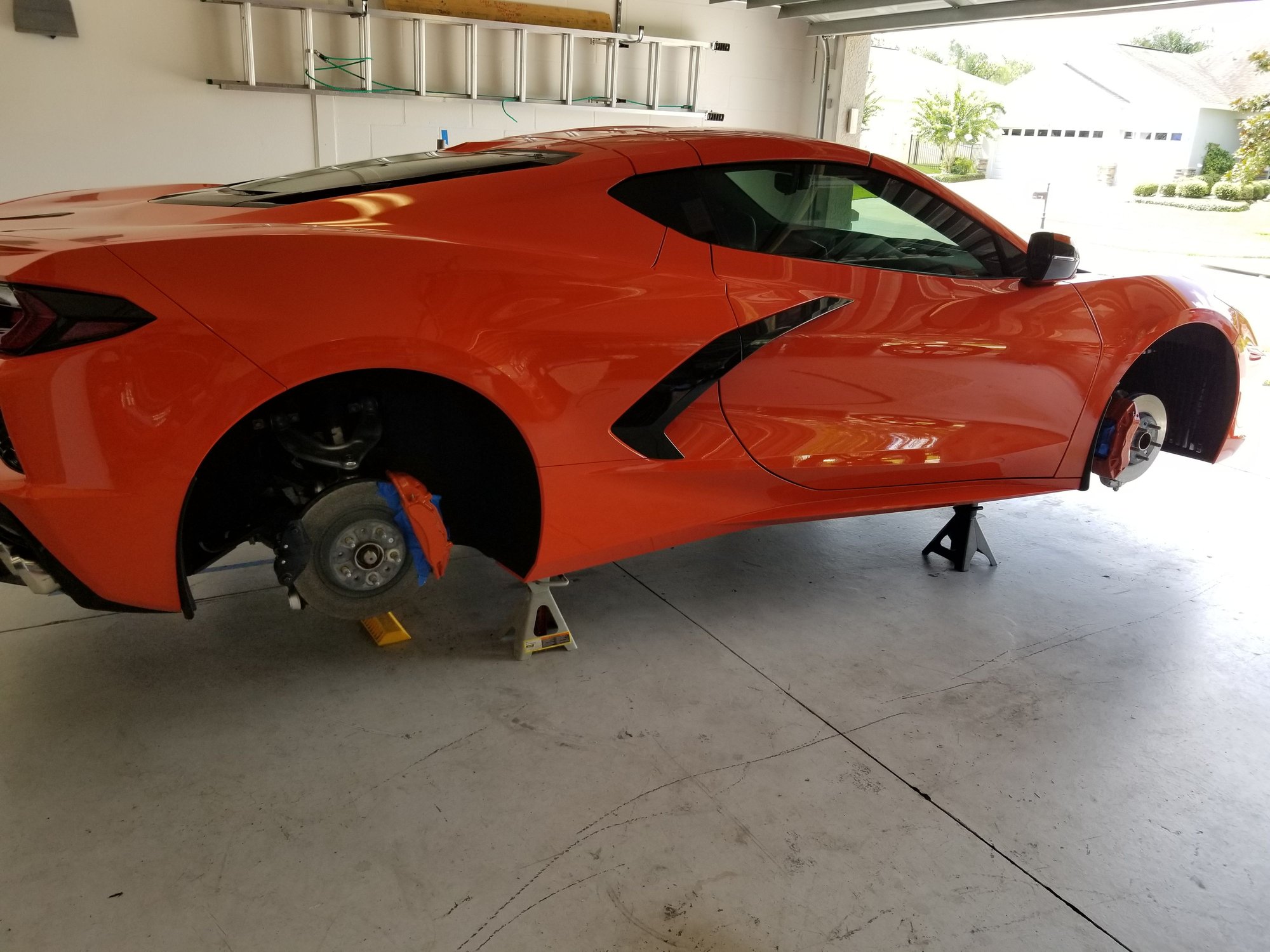

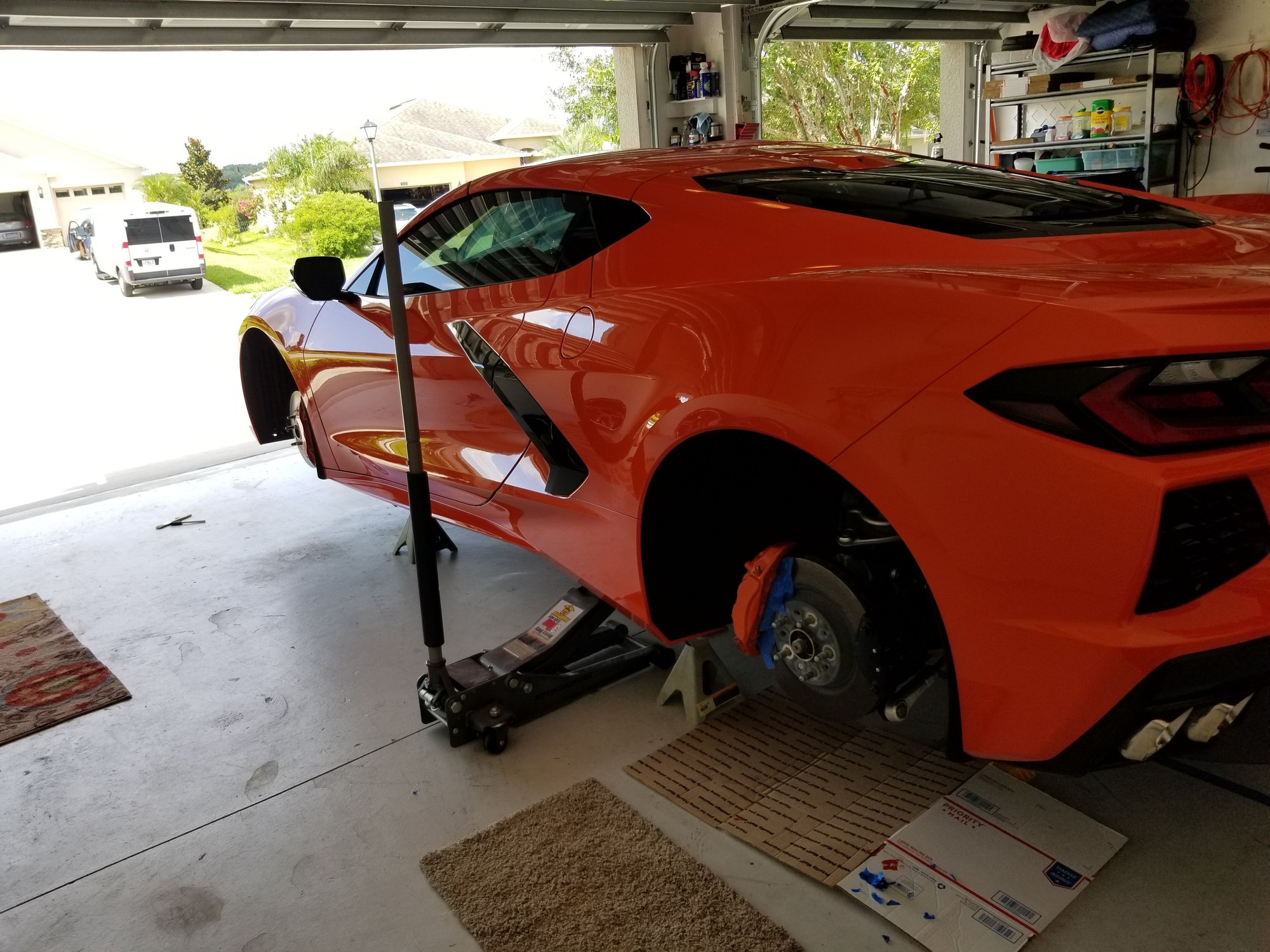

I put my car up on stands yesterday. I used a hockey puck and a jack at the circle cut out on the frame (not the official jacking point) to lift the car (rear one first) and put the jack stand and jacking puck in the official jacking location. I did the rear first to support the heavy end and then did the front.
No panels needed to be removed and there was not a tipping issue as the jack stand was placed in the proper location.
It worked great for me.
