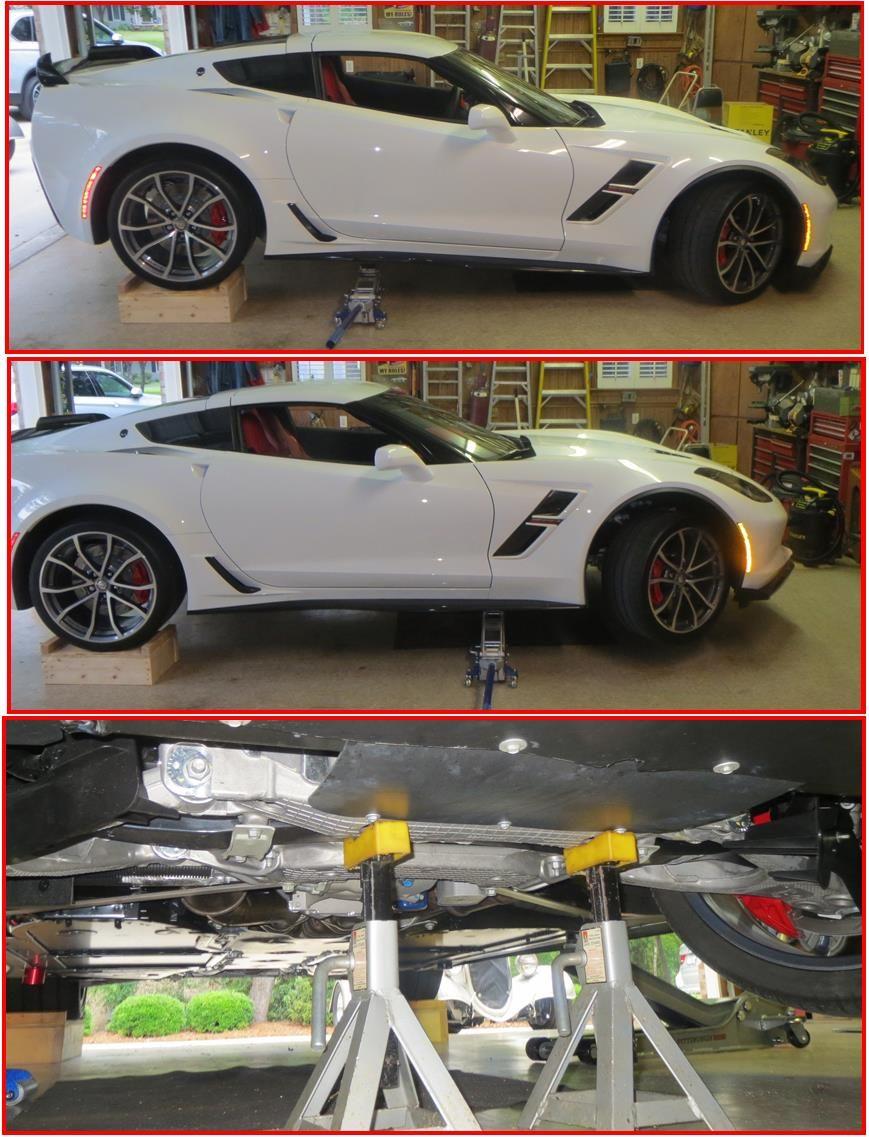

Here is my lifting Pic with GM suggestions for jack stands:
Note my comments, as rather than remove the underbody panels as GM suggests I'll place jack stands under the lower "A Arms close to the wheel." As I often do now I will keep the jack on the frame jack pad with some tension and use the jack stand more as security. I never use jack stands on both ends of the car and if both ends need lifting will use my wood stanchions. Where I normally put the stanchions under say, both rear wheels, when I install the side skirts on my C8 will use those on one side under that front and rear wheel. Need access to the full rocker panel.

Funny while you were posting I modified my Jack Location Pic since I used the wrong word, "A Frame" when referring to the lower suspension "A Arm!" Note my Edit was posted 11:03 after modifying my Pic and you posted 10:56
BUT if like the OEM I would use a Stanchion under the front wheel and a Jack Stand under the "A Arm." I have used that location on my C7. However could also remove the air deflector panels as GM suggests, they are just bolted on. Would not want to do that every time I needed to use jack stands but in this case would not take that much extra time. When I watched the OEM Side Skirt Install video that one fastener in the back appeared to be placed in a poor location for install. We'll see if C7 Carbon moved it somewhat making access easier. But if it's the same, one way or the other I'll lift so nothing is in the way, even if it requires removing the air deflection panels.

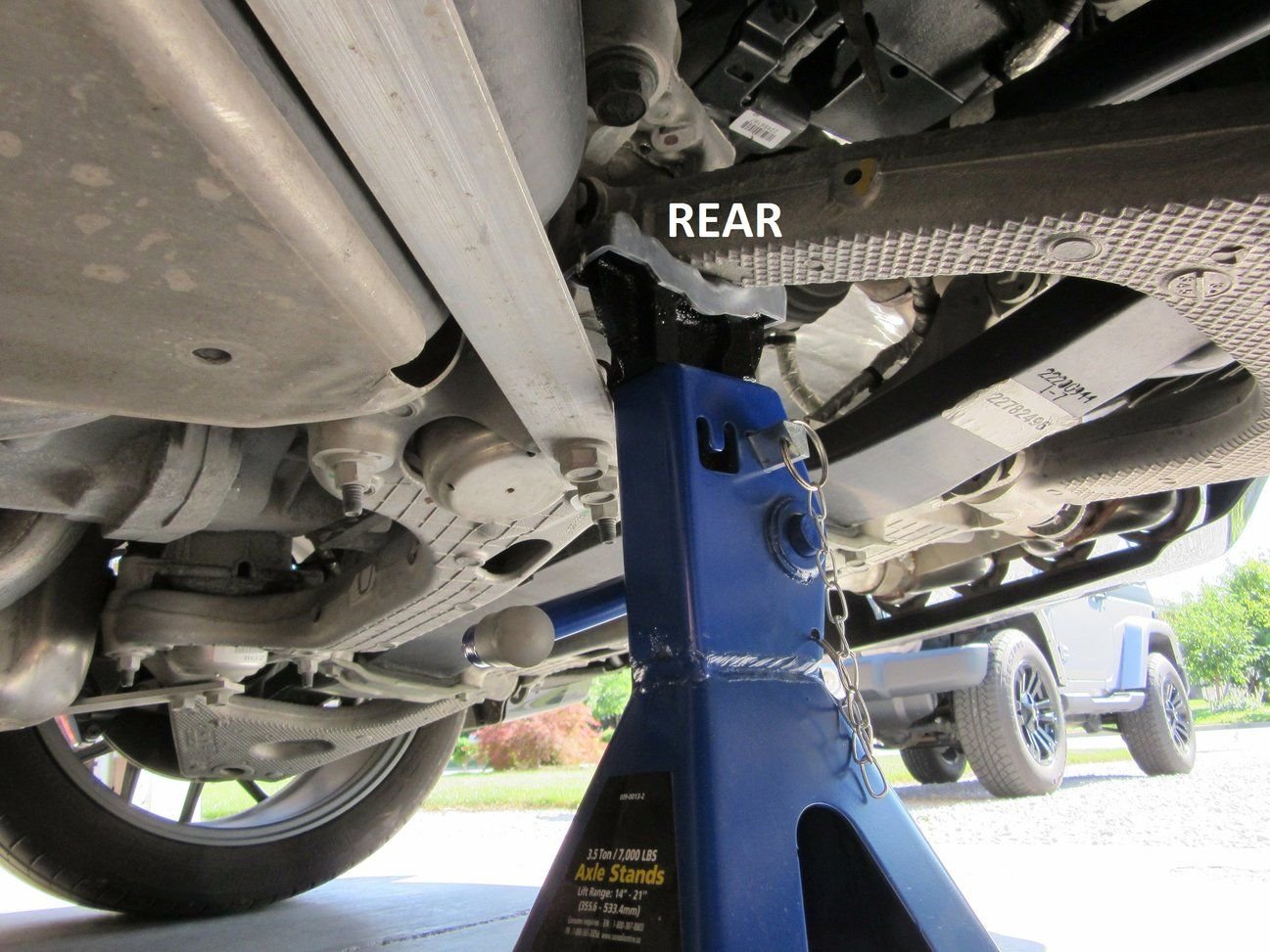

Made a new Lift Suggestion Pic to be clear about the "possible" use of Jack Stands on the lower "A Arm Suspension," near the wheel or with the wheel removed. Note I use the yellow rugged flexible plastic pads on my jack stands to protect the car, spread the load and provide better grip. Purchased many years ago but checked Amazon and there are similar.

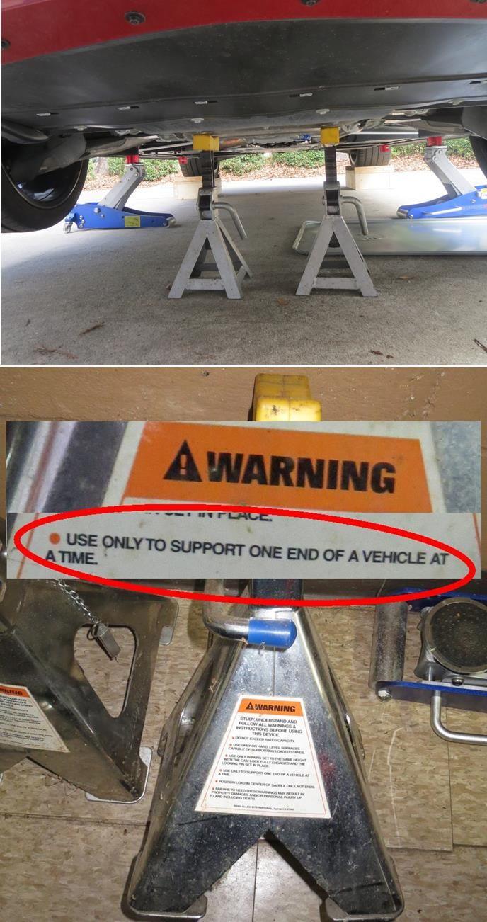

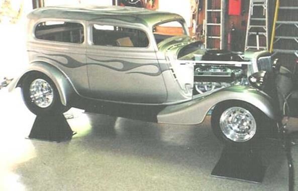

One safety thought! I would never use Jack Stands on both ends of the car. See warning on one of my several pair. I use the wood stanchions I made for ~$10 but you can buy them. I even have a set of 4 that raise the car 12 inches that I used when building my street rod but they took a several step jacking proceedure to get that high. Fine when I worked under the car for several months!

Never seen the control arm as an approved stand location in any C7 docs? They’re hollow cast. Additionally, that won’t let the suspension droop fully for room to do a myriad of things.

Used many times! The cross members on a C7 are also hollow! GM says can be used with a pad. BUT you can always remove what GM calls aero panels and put jack stands on that "hollow cross member" as GM suggests and I show in my post!
