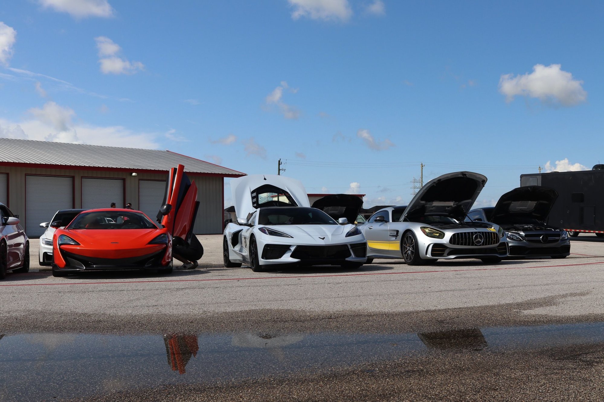

Originally Posted by autodesign21
Who's trying to hit triple digits on public roads with ALL SEASONS!? Noob move there captain, especially if you're complaining about "floating".....
Sell the car
There is nothing magical about triple digits. I used to drive at just over 100mph all day long in my MB 230E, 2.3 liter, 4 cylinder, 134hp, 4 door sedan. That was on public roads as well, in Germany on the autobahn, so no legal infractions. Trucks going slowly and sports cars going 150mph require everyone to pay attention! Nobody but the really fast movers would EVER cruise in the left lane. If US drivers knew how to drive it would help a lot. If the tires are rated for the speed, which the C8s are, all season tires can cruise at speed all day long. At 125mph the sedan was definitely “floaty” hence I didn’t drive that fast but it was perfectly comfortable at 100.

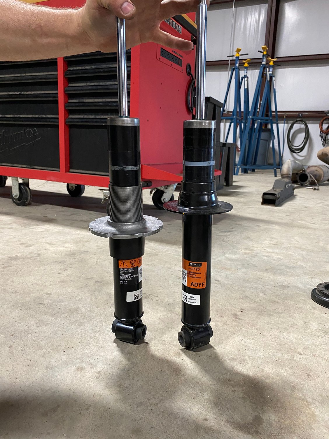

The springs are the main difference - the shocks, by what me and my mechanic have been able to tell, are nearly identical in valving/etc with the only difference being the adjustability. I swapped the rear in my non-Z51 Ti the FE3s and lowered the car the max to match the Cicio front lowering collars - dialed in a good alignment at -2.1 front / -1.6 rear camber and fixed the caster discrepancy as delivered. Did my first track day today at MSR Houston and the suspension held up great - just need more tire (when I get my new street setup I’m doing R888Rs on the stock wheels) and some track brake pads - those were really the weak points but the A/Ss still put down decent lap times for what they are and held up fine wear wise.
