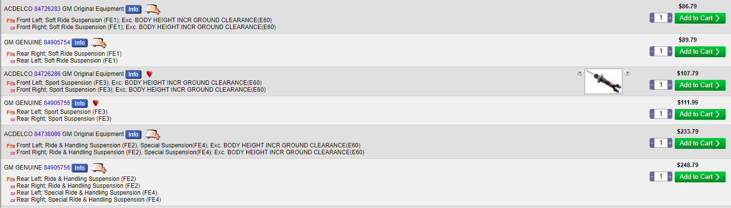

Well 3 options:
1. Go out and purchase the FE3 spring and install on your car. rockauto.com has them for $150 set.
2. Purchase the Z51 FE3 Coil overs with the new spring set about $500.
3. purchase rear z51 sway bar
purchasing all those items you will havea standard car that handles like the Z51 car.

Originally Posted by 2019C7
So what do I order? I like the ride on my nonz51 FE1 shocks but I just want to lower the car 1”. Do I just replace the shock and with adjustable Z51 shock?
yes but do you have front lift?
