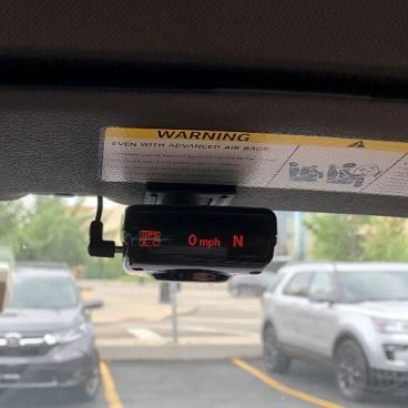

Originally Posted by LJT
Radenso Pro M
This is more than I need, but First And ONLY one I have seen with a Visor Mount option.
Very few Detectors have this option anymore. I was surprised the Valentine Gen2 came with one.

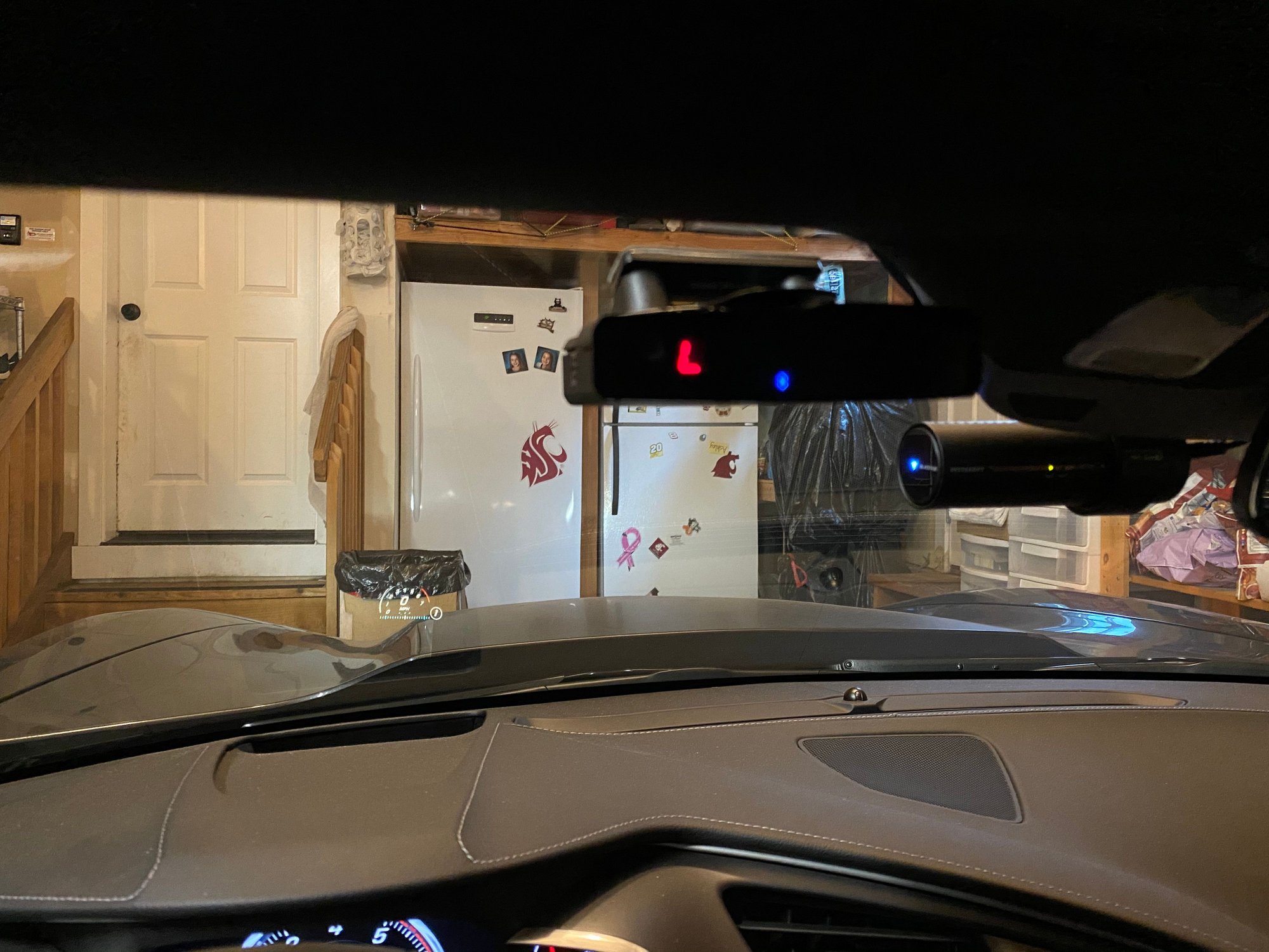

I got this 3m mount off eBay and it works perfect for the Valentine. You install the Valentine cradle on it and it fits high and tight on the windshield. It also comes with the hardwire kits as well. Made for an easy install.
Are you able to get your rd level with that mount? I have it also, but there is no way I can get the thing level in mine.
Yes it’s perfect. I installed some thicker black 3m tape. It gives a bit more room to level it out and blends in better with the detector on the windshield.

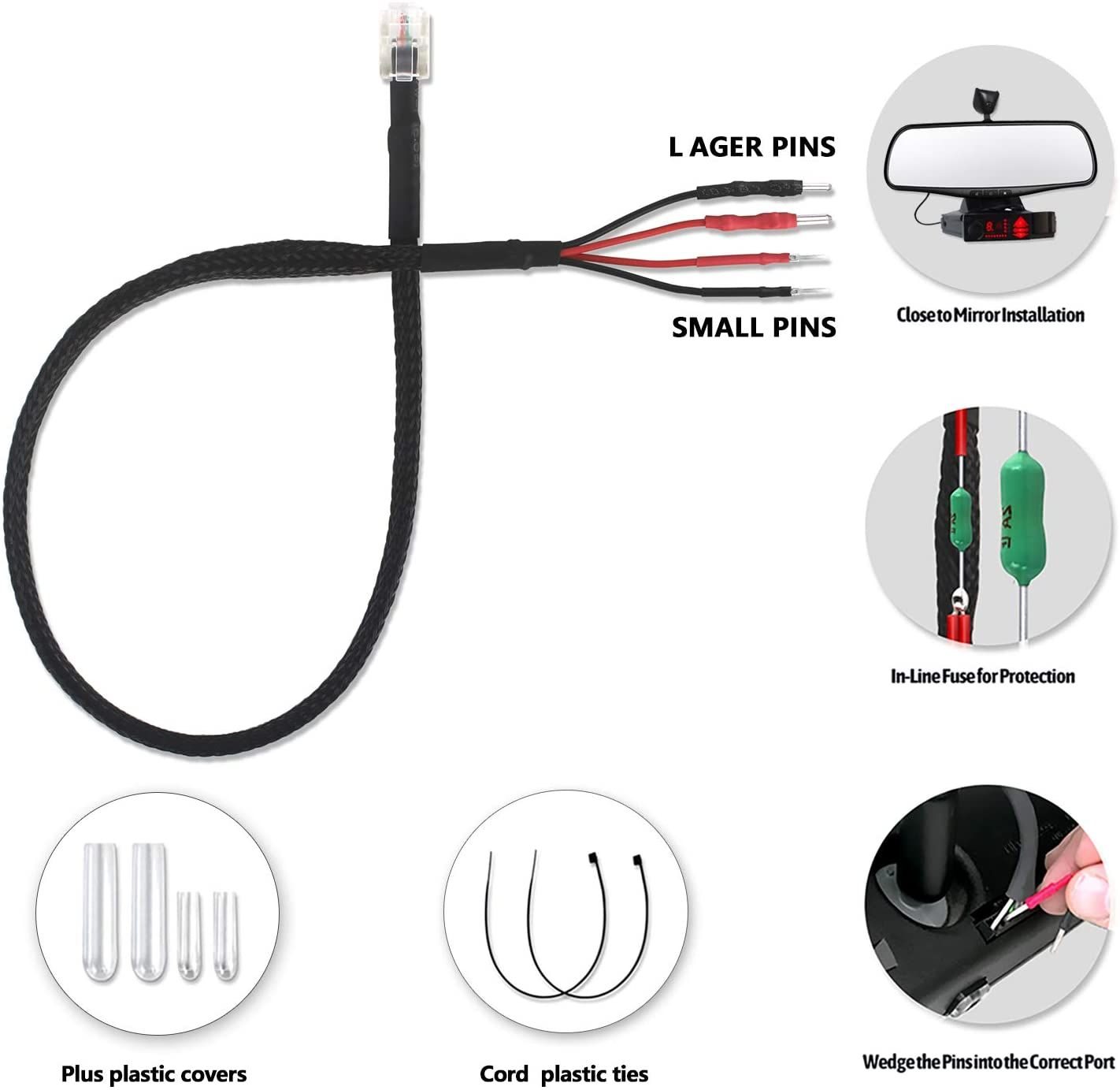

I went with the Uniden R1 ($199). The R3 adds GPS that I don't need for $299.
  • Has anyone Hardwired to the C8 Camera Mirror yet / Is it possible / Anything special / problems / Don't do iT?
  • Which Hardwired Kit did you select? Example shown.

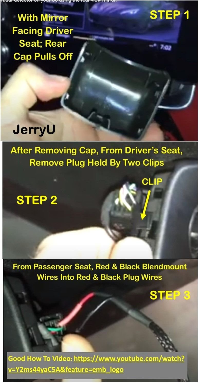

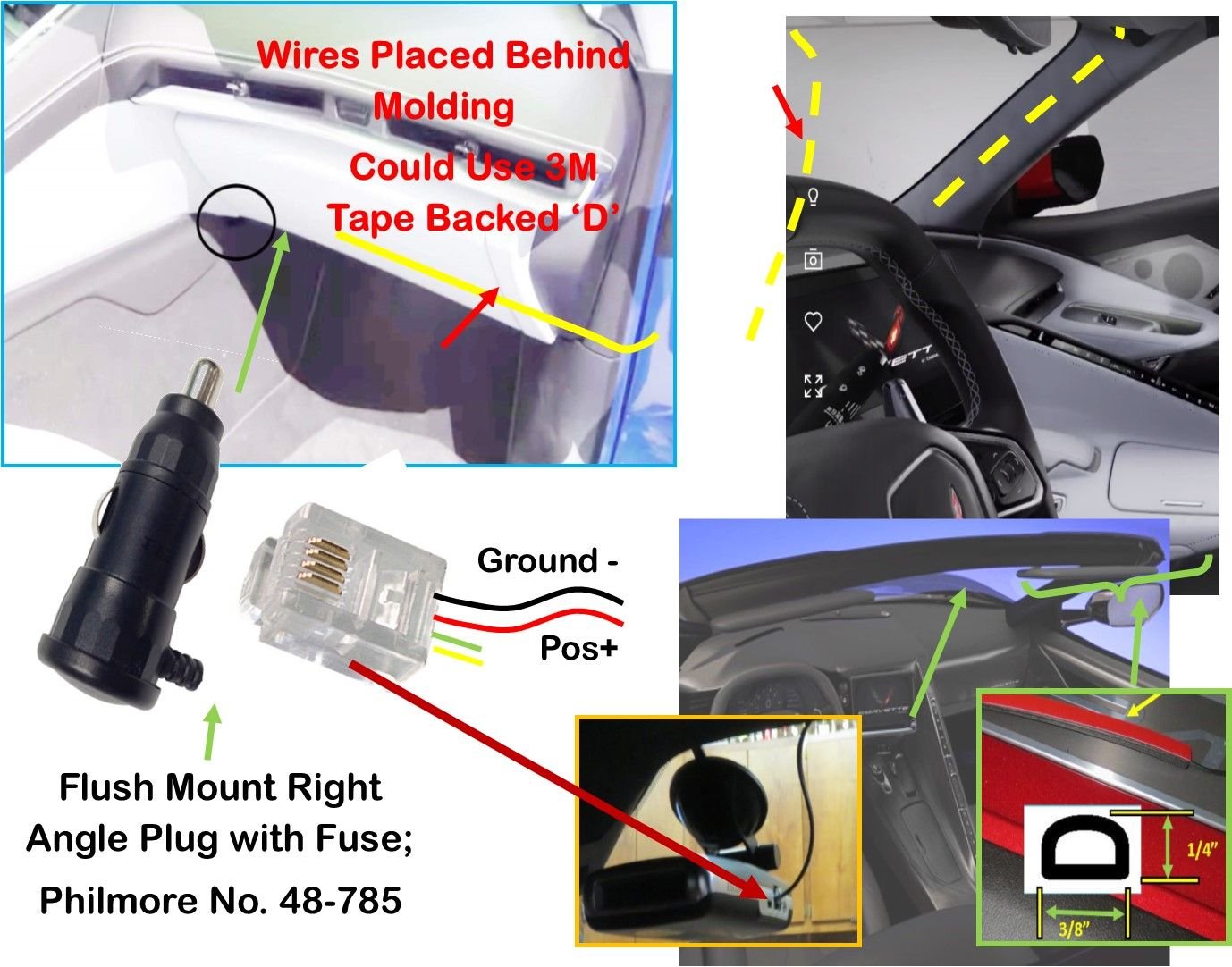

Two options. Depends on where you want to get power. Mirror or receptacle under the passenger glove box.
Mirror: Link to video in bottom pic. I'll use my C7 Blendmount wire to my detector.
What I Was Planning Until It Was Found Mirror Was Easy

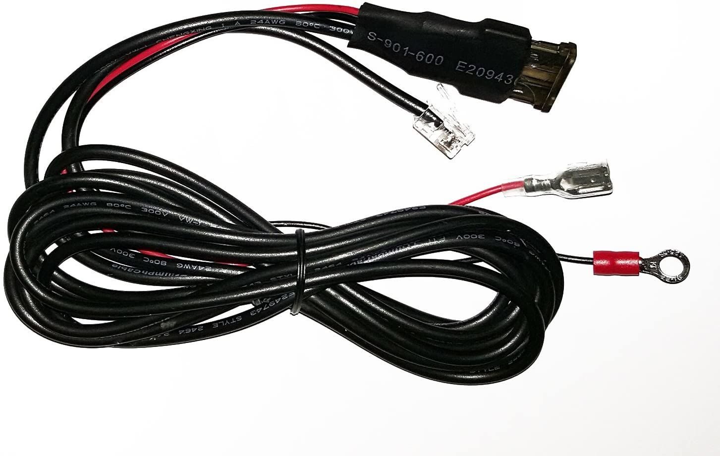

I just found the other wired adapter to use direct power This is nice with dedicated external fuse. I'd have to still get 12Vdc + & -
Yep, have my V1G2 hardwired to the mirror. Took maybe 5 minutes at most and cost $15. I'll PM you info since I'm not sure we can link to other boards on here.

Thanks again. The image with the url for the video doesn't work. Watched the actual video from PM. Explains everything nicely. The correct URL follows.
https://www.midenginecorvetteforum.c...rror-for-power

What is the best tool/way to pop the cover off the back of the mirror?
Watch the video that the URL was shown on the last pic in my post #34:
He said he used his fingernail. When I get mine (built last week, still in Bowling Green) I'll use what I did on my C7, one of my dentil picks! You can use a dental pic to make room in the electrical connector for the pins from the detector wire. Let us know what terminals you used, i.e. how far from an end etc.
