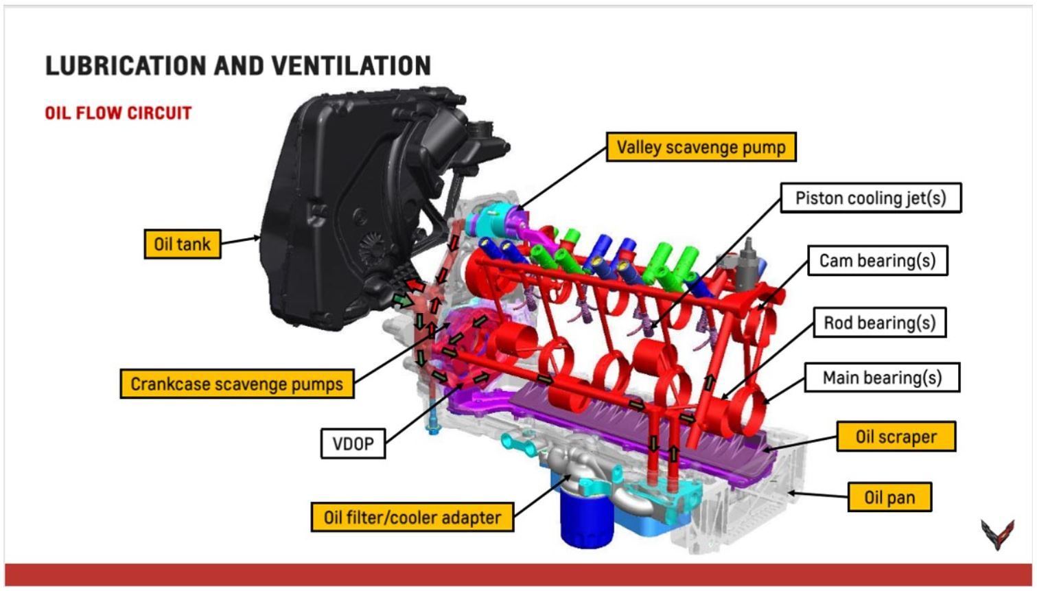

Horsepower Obsessed recently put up a video where he showed the installation of an oil catch can on his C8. It’s a nice piece of kit and looks to be an easy project but I’m confused about one thing. Doesn’t the C8 already have an air/oil separator? If so, why would I need a catch can in addition? Would it really make that much difference?
Does anyone have a link to a searchable parts catalog that includes engine and accessories? How could I research this?
Thanks for any help!

A catch can would take the oil fouled air from the valley cover that now goes to the intake manifold and get burned, and separate out the oil so that you still get crank case ventilation but do not fill the intake manifold and intake valves with oil residue. In normal driving very little oil flows thru that system. On a road course in a C6Z, running 4-7K RPM and then hard throttle close under braking will generate about 4 ounces of oil per track day. That oil would otherwise puddle in the intake manifold, foul the intake side of the intake valves and reduce the effective fuel octane burned in the combustion chambers. Just a couple hard pulls on the street or at the drag strip won't generate much oil flowing thru the OEM system.

Originally Posted by Zymurgy
Let's see. GM has a 5 year 60,000 mile powertrain warranty on the C8. If they felt it needed a catch can, it would come with it. The debate will rage on.
Those drawings are great! Thanks so much for providing that. Is there any way to view the entire set? What document did those come from?
Search Google for C8 powertrain media briefing.

Originally Posted by GTUnit
C8 has an air/oil separator under the intake manifold.
See diagram up above where the Foul air (oil soaked) from that valley oil separator is BURNED IN COMBUSTION. An oil catch can would strip that oil out and keep it from being burned in combustion (knocking down the fuel octane).
I understand that GM would not want a high maintenance device like a catch can, which would have to be drained after every track event, to be included on the regular production car. On the street you could drive 5000 miles and maybe pick up 1-2 ounces of oil. You would get 4 ounces in one track day. This is one area where those that need it should just expect to add it and take care of it's regular draining maintenance.
