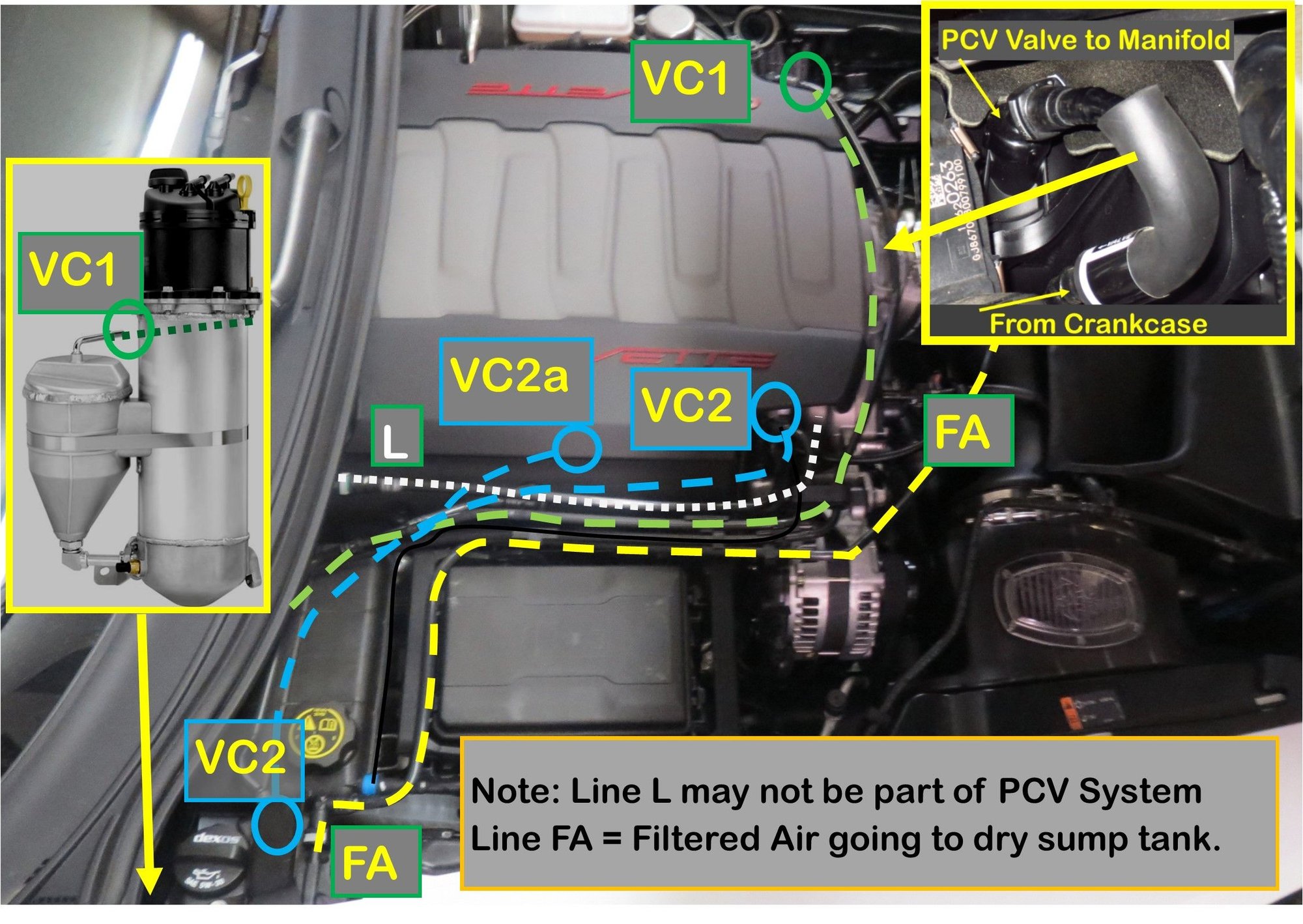

My Grand Sport PCV System is much more complex than my 2014 Z51 Dry Sump. Many more lines and internal baffles.

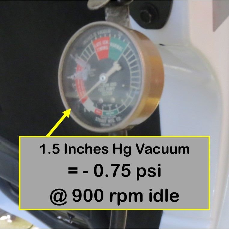

I used this vacuum/pressure gauge to define how the two hose system going to the air intake in the 2014 dry sump was replaced with one! Where did the fresh air that needs to replace the PCV "stuff" come from? Found out!

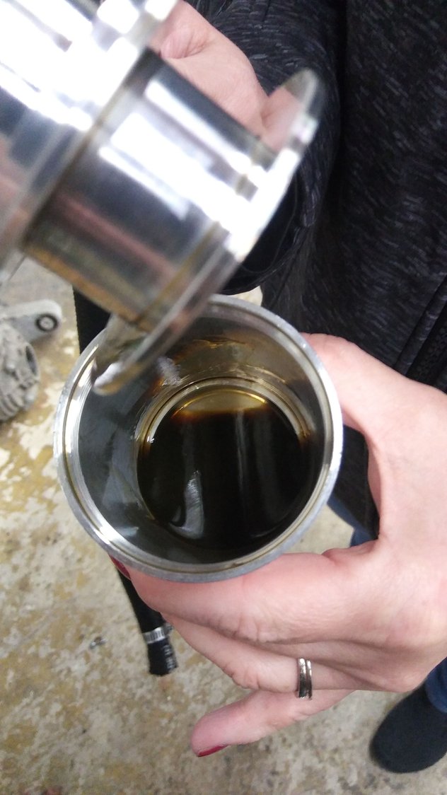

1000 miles with my catch can (clearly not my hands).

So what? That's not evidence of anything other than a little oil in a can.
However, as I said, if you makes you feel better, keep collecting. Feeling better is good.
