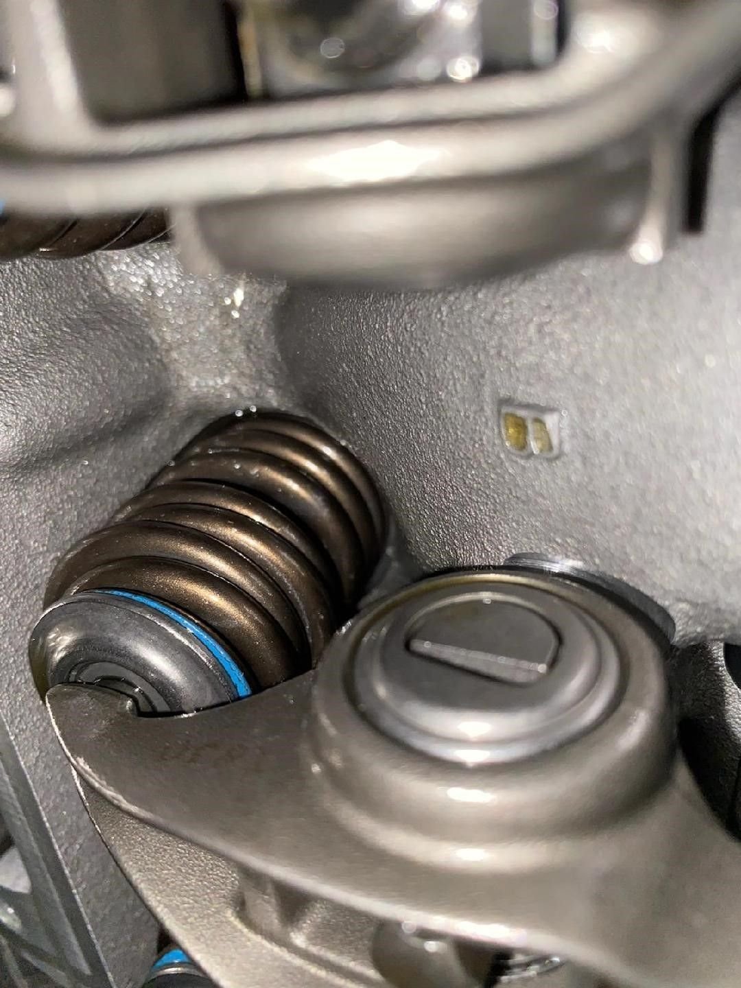

Turns out it is my buddy's #8 Exhaust valve spring
