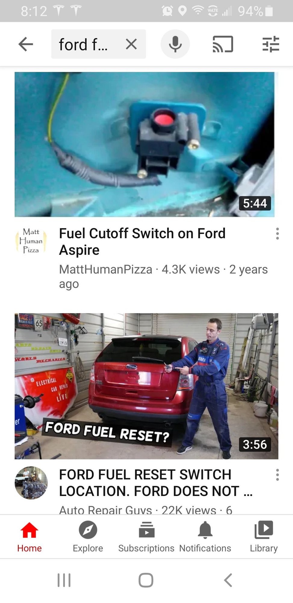

Ford just about every coupe and sedan back on the early 90s did. And it was a magic act for someone like the OP or me to walk over perform a little fonzie-esque pop and have the engine light up. The car used to crank over and over see video. I see they haven't changed lol
technically its an inertia switch. Meant to stop fuel from pumping in an accident BUT every now and then a big pothole or bump or anything would "pop" the breaker so to speak..

https://youtu.be/vv2HX9y5fYM
FIATs made in the '70s had electric fuel pumps. There wasn't a requirement in Europe to have a fuel cut-off switch but there was a requirement in the US. So the import versions added a fuel cut-off switch. It could be seen in the schematic along with a fuse but they didn't discuss the system or locations in the manual. Instead of being integrated into the harness they put a single wire in with an inline fuse underneath the back seat carpet.
It took me a while to figure out why the engine wasn't getting fuel when the fuse blew. As I remember, the switch was bypassed when the starter motor was cranking. So the car would start but wouldn't continue to run.
